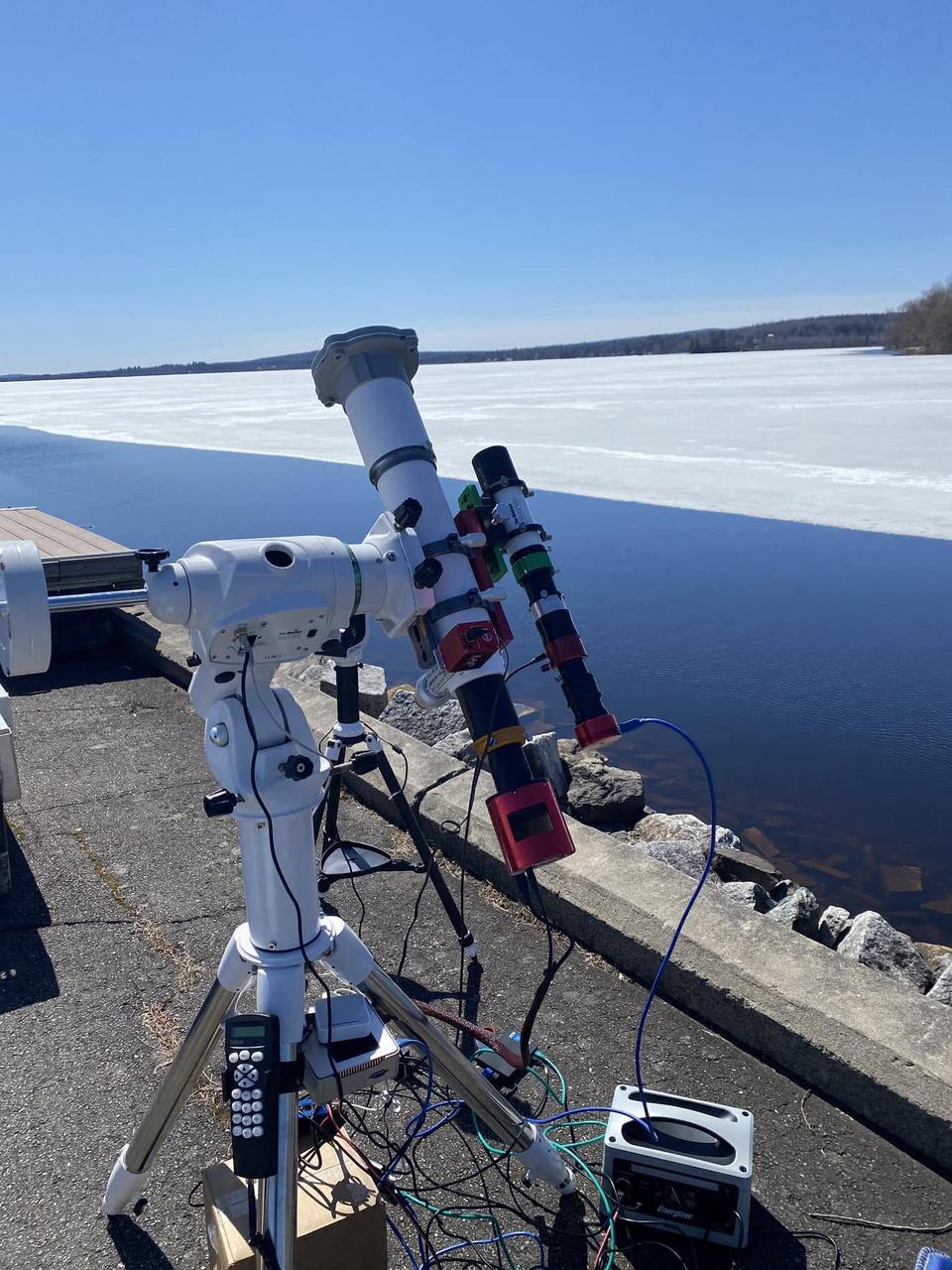

My equipment is made up of two instruments. The first, a William Optics ZS80 refractor fitted with a ZWO EAF, an ASI2600MC camera and, of course, a Baader solar filter mounted in a holder I 3D-printed myself. The second, a Sky-Watcher Evoguide 50DX at f/4.8, with a DayStar Quark Chromosphere H-alpha filter and a ZWO ASI432MM camera for the partial phase. I normally use this camera on the ZS80, but this time the focal ratio will only be f/20.2 instead of f/28.6. It was not ideal, but I had no other option. The mounts I use are a Sky-Watcher EQ6-R and a Sky-Watcher SolarQuest. Acquisition runs from a PC with a Python script I had written and tested many times without a hitch. Power comes from a camping power station with 12 V, USB and 110 V outputs. Storage goes to a 4 TB USB solid-state drive.
Challenge
First problem. My SolarQuest mount — the one carrying the Quark and the 50 mm refractor — refuses to acquire a GPS position, which it needs in order to track the Sun… Plan B: I mount the small refractor piggyback on the ZS80 and align the whole thing that way… It works. My equatorial alignment, done with the solar shadow method, looks right, and the unguided mount needs only minimal corrections. I start a simple sequence with the acquisition utility I use: a short 30-second video every two minutes.

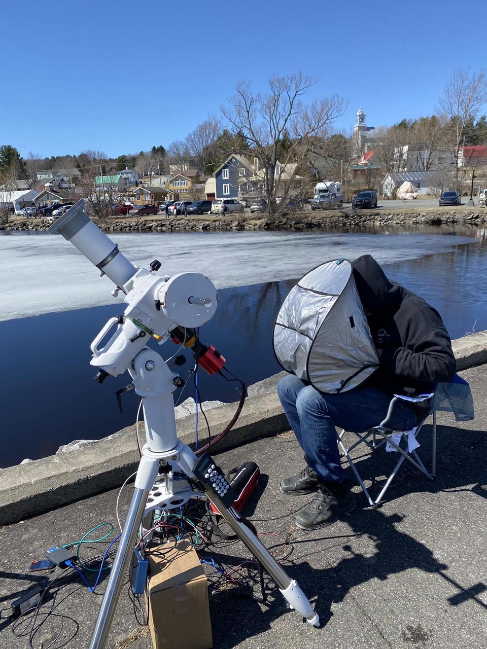

Eclipse glasses are just as indispensable for the phase before totality. I bury my nose in the laptop and, in a scramble, work out the right exposure to start a simple acquisition sequence. The ASI2600MC starts saving frames; I’ve missed Baily’s beads at ingress and the first minute of the eclipse. Whatever the outcome, I’ll have done what I could — it’s time to enjoy the show with my family. Two minutes where time seems to stop, where a black Sun fills the sky. Third contact (C3) arrives and totality ends. I put the solar filter back in front of my refractor. The moment is etched into our memory.

Running acquisition with multiple cameras makes sense, but my mistake was leaning on too many different components: two mounts, two acquisition software systems. Even though I had tested it all many times over, an error can always creep in. The other point, maybe the most important one, is to enjoy the moment. Don’t spend the whole eclipse with your nose glued to your tablet or your computer. The show is all around you, and even if you don’t come home with a single photo of the eclipse, the memories of those moments are worth every photograph in the world.
