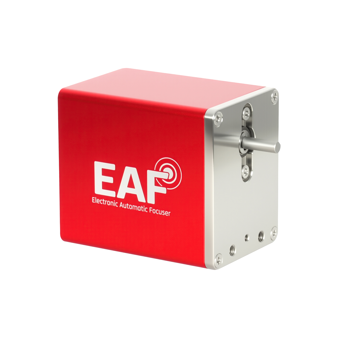

The new generation of ZWO EAF continues the brand’s signature minimalist design, featuring a robust metal housing and precise angular lines — a perfect fusion of form and function. Available in two versions: EAF and EAF Pro — to suit different user needs.
EAF features a more universal Type-C interface for broad compatibility and easy installation.
EAF Pro comes with a built-in battery and Bluetooth connectivity, reducing power supply constraints. It also includes manual focus buttons, allowing direct adjustment even after installation — offering maximum flexibility and convenience. Both models deliver a more user-friendly focusing experience, achieving pinpoint focusing accuracy for breathtaking cosmic imagery.

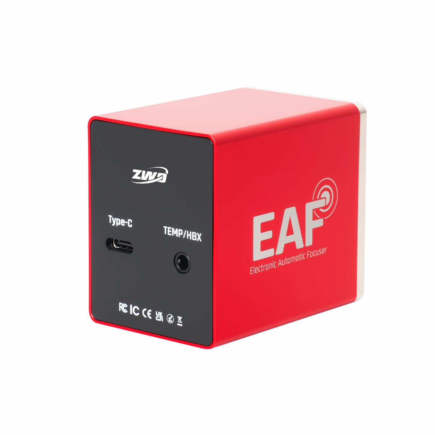

EAF
Micron-level Positioning Accuracy
The ZWO EAF integrates a high-precision custom stepper motor with compact yet powerful performance. Featuring a 1:128 reduction ratio, it provides the motor with strong torque and precise control capabilities, achieving micron-level positioning accuracy. Each rotation responds precisely to commands, ensuring accurate and reliable focusing.

More Universal Type-C Interface
The EAF is an upgrade from the previous version, with its interface upgraded from Type-B to the more universal Type-C. Users can power the EAF directly via a Type-C connection to a camera, computer, or ASlAlR, it also supports wired communication via a Type-C interface. Simplifying cable management and reducing power load.

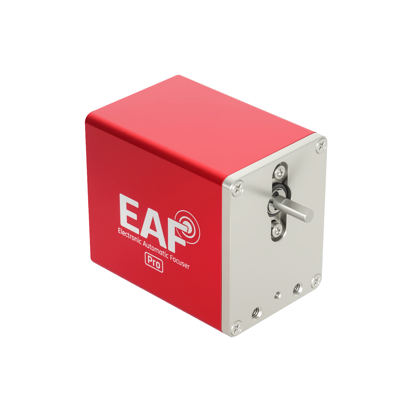

EAF Pro

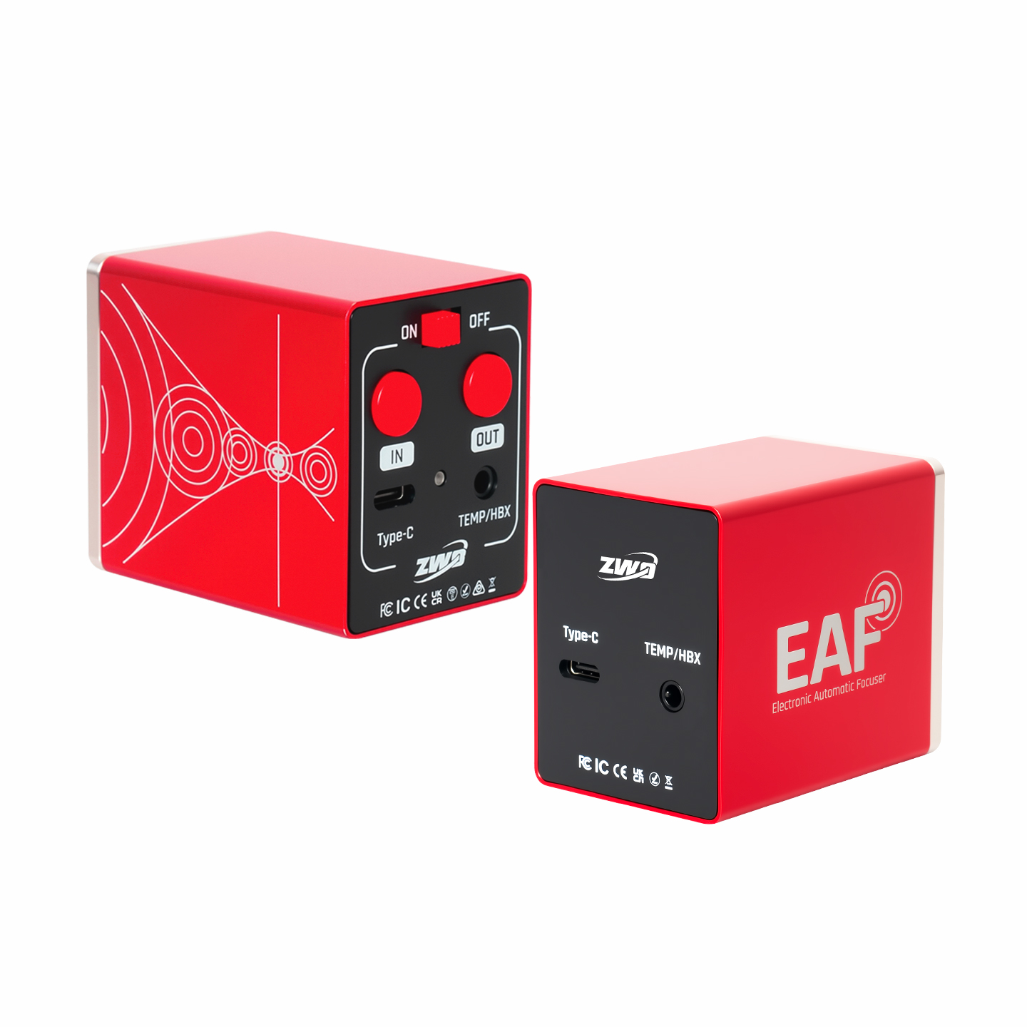

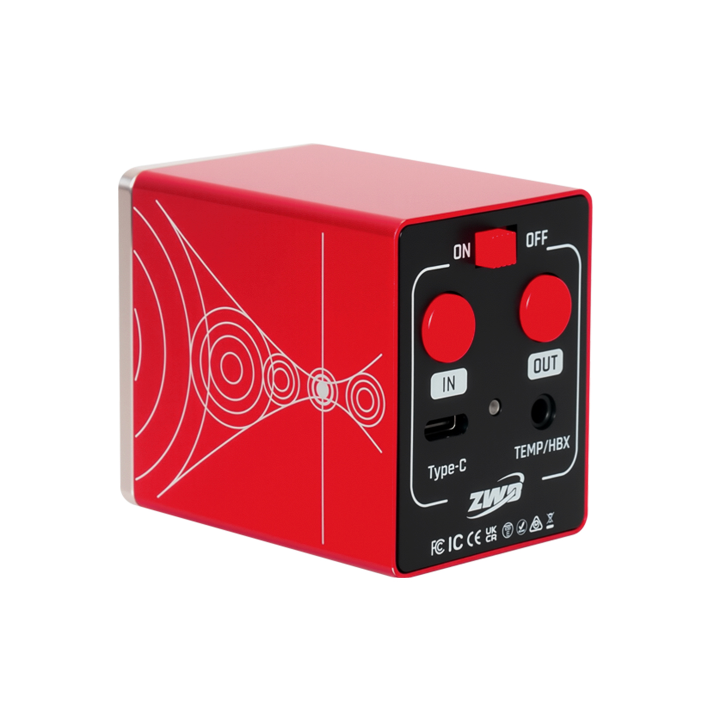

Integrated Focusing Button
The EAF Pro features integrated focusing buttons on its body, allowing users to make quick and precise adjustments even after installation. This design greatly enhances usability and flexibility, enabling seamless focusing across a variety of observing and imaging scenarios.

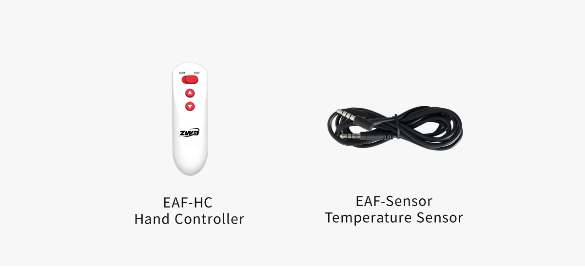

Support handle controller and manual focusing
The EAF hand controller is made of high-quality, eco-friendly ABS material to ensure a comfortable grip. The hand controller provides an easy method of focusing the telescope, featuring IN and OUT buttons, allowing for smooth manual focusing without relying on a computer or smartphone. This design also minimizes subtle vibrations during operation, helping to maintain precise focus. A “must-have” option for EAF users!

EAF-HC — Hand Controller for EAF
EAF-Sensor — Temperature Sensor for EAF
EAF-HC Hand Controller
Designed exclusively for the ZWO Electronic Automatic Focuser (EAF), this handheld controller features an ergonomic design with durable ABS construction, offering a comfortable grip and secure connection.
Equipped with a two-speed control switch, it allows for precise manual focusing—from fine adjustments to rapid focus moves—with ease and accuracy.
The 1.5-meter cable provides flexible usage, and the standard 4-pin 3.5mm audio jack ensures quick and reliable connection, enhancing operational convenience.
The EAF Hand Controller is your essential companion for astrophotography focusing.
EAF-Sensor Temperature Probe
Specifically designed for the ZWO Electronic Automatic Focuser (EAF), this temperature probe accurately monitors subtle changes in ambient temperature. By providing real-time temperature data, it works in tandem with the focuser to ensure your telescope maintains optimal focus under varying thermal conditions.
Connector Diameter: 3.5mm
Cable Length: 100cm
