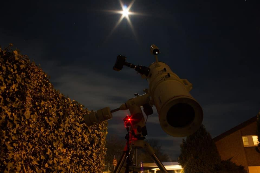

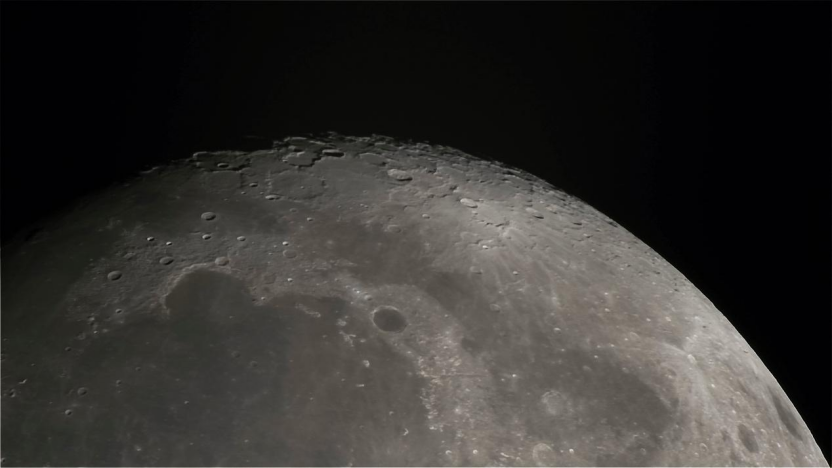

A long time passed until 2017, when I finally acquired my first telescope: a 200mm aperture, f/5 Newtonian reflector from the company Bresser. My dream was finally coming true. The emotions were indescribable; I was filled with joy, and my curiosity continued to grow. As I looked through the eyepiece, I wanted to capture every moment, every image and that is how I found my way into astrophotography. Once again, the Moon became the target of my first advanced exploration.
Things have evolved significantly since I purchased that first telescope. Over the years, I have gained a wealth of experience and have now reached the point of owning my own observatory, which is fully remotely controlled. Throughout this journey, there have been wonderful moments, but also plenty of challenges. You know how it goes, sometimes the equipment refuses to cooperate, or the weather conditions simply don’t align with your plans. But I have reached my current level thanks to my family, who supported me, and thanks to that initial moment of inspiration which serves as the “engine” for this hobby.
Bresser 200/1000 f5 telescope
The Moon with a Bresser 200/1000 f/5

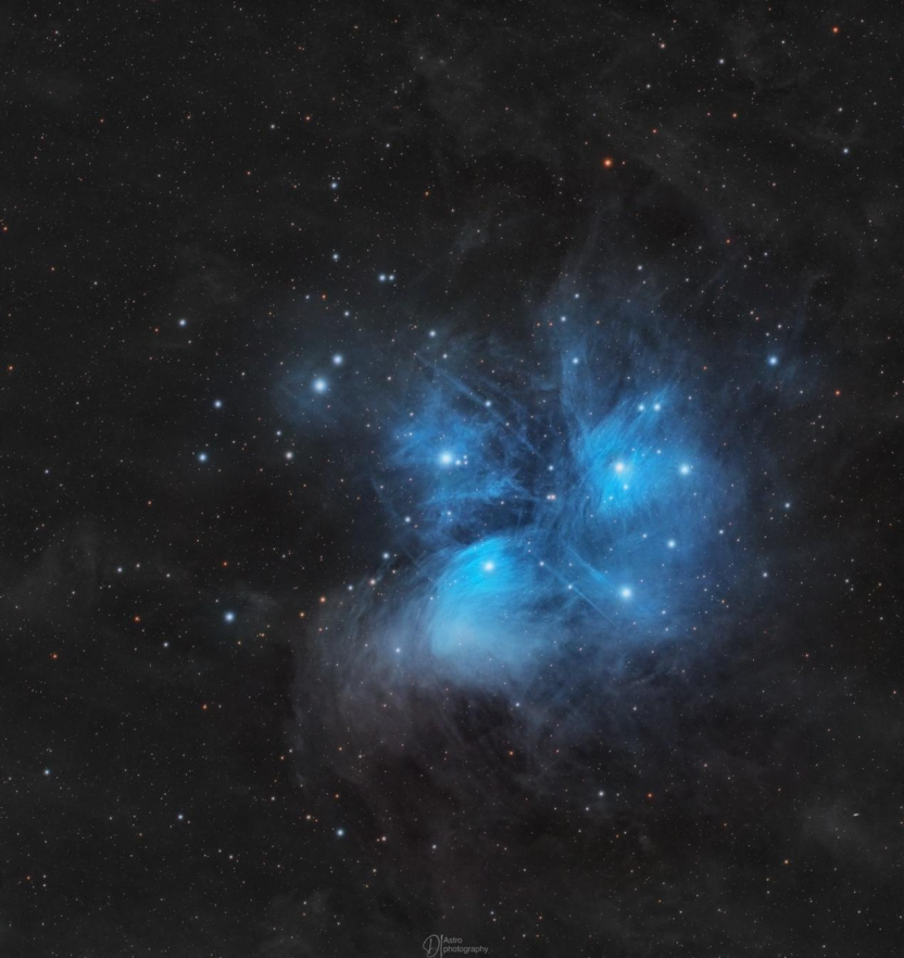

M45; William Optics RedCat 51 II/ZWO ASI 533MM Pro; 20 hours Integration

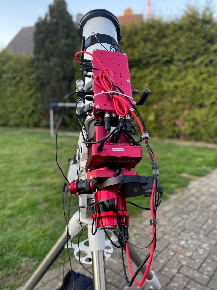

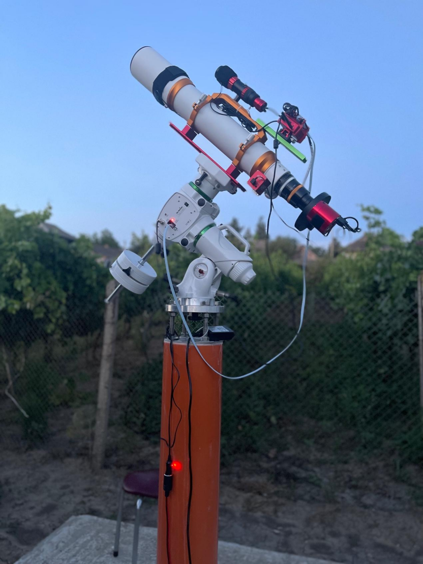

Currently, my equipment consists of:
Telescope: SkyWatcher Esprit 100 with a 0.75x reducer from Riccardi,
Camera: ZWO ASI 2600MM Pro,
Mount: SkyWatcher AZ-EQ6 GT,
Guiding camera: ZWO ASI 174MM Pro,
Off-axis guider: ZWO ASI Off-Axis Guider,
Filter wheel: ZWO ASI Filter Wheel 7×36 II,
Filters: Chroma filters,
Focuser and rotator: Primalucelab,
Tilt adjuster: Wanderer ETA 54,
Flat panel: DeepSkyDad Flat Panel,
Power box: Pegasus Astro Ultimate Powerbox v3 (UPBv3).

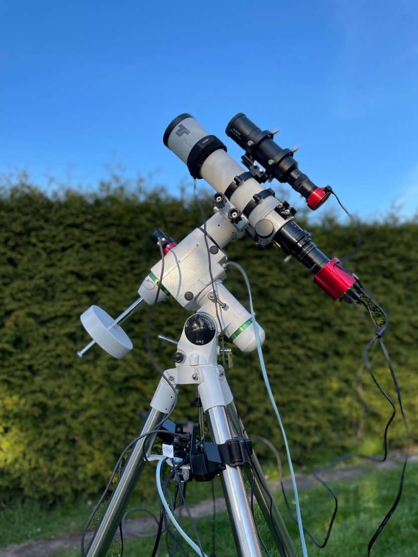

Initially, I used an unmodified DSLR Camera, and later I switched to my first cooled camera from ZWO, the ZWO ASI 294MC Pro. At that point, I realized that this step was a real game-changer, and that is where the true adventure began. Since then, I have made further changes to my equipment. Over time, I have used several telescopes: the TS Optics 80/480, William Optics ZenithStar 103, William Optics RedCat 51, and my current SkyWatcher Esprit 100. As for cameras, I have used several models from ZWO: the ZWO ASI 294MC Pro, ZWO ASI 128MC Pro, ZWO ASI 533MM Pro, and currently, the ZWO ASI 2600MM Pro.

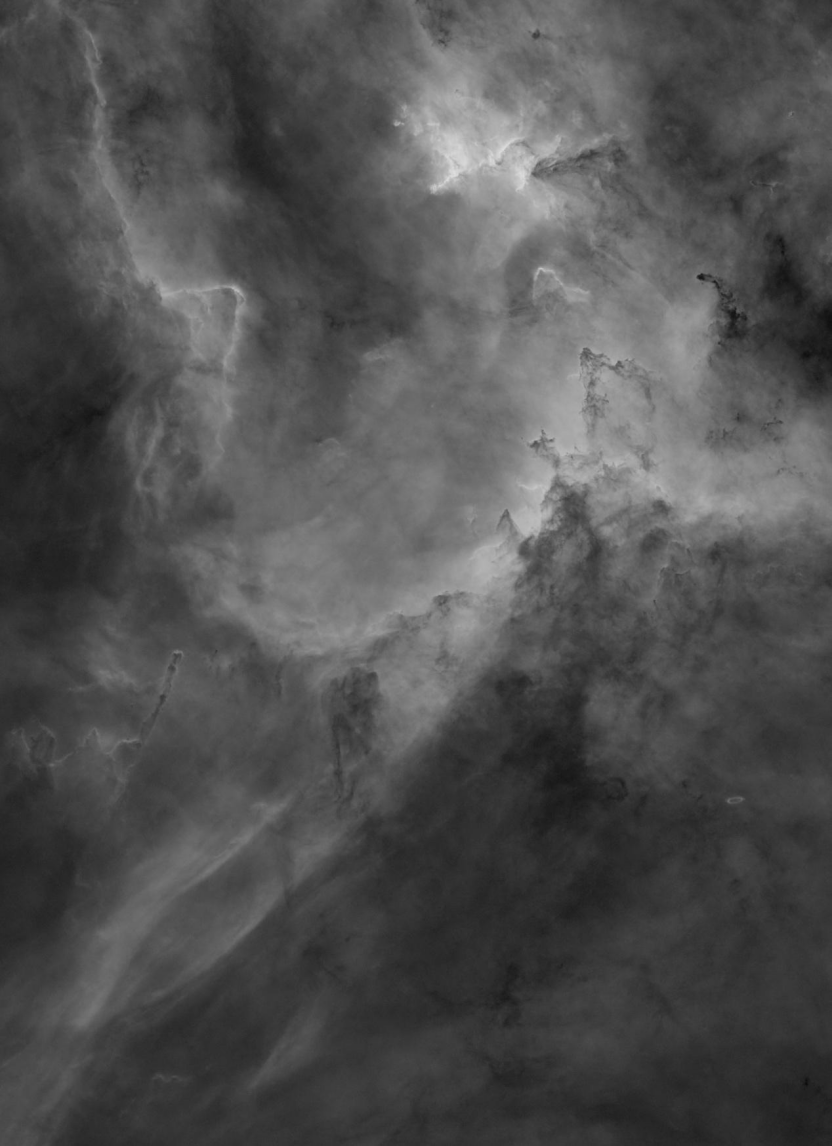

Heart of the Heart Nebula in Ha: RedCat 51II/ ZWO ASI 533MM Pro

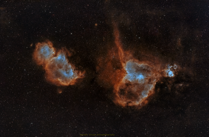

Heart and Soul Nebula; RedCat 51 II paired with ZWO ASI128MC Pro; 9 hours integration

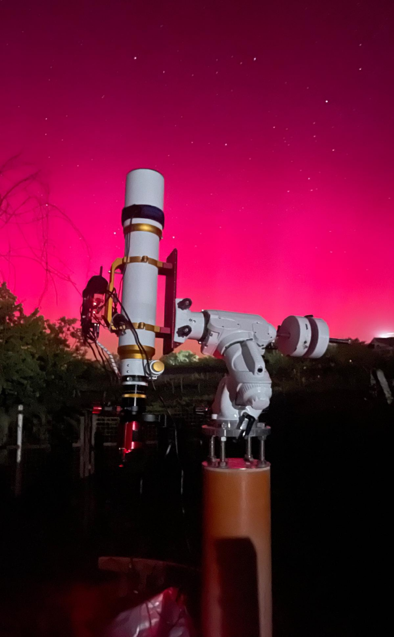

Throughout my time as an astrophotographer, I’ve had many memorable experiences, but the night of May 10, 2024, stands out the most. It was a clear, serene night perfect for starting an imaging session with my telescope. Then, quite unexpectedly, I encountered a surprise: the sky began to shift, taking on an increasingly intense red hue. It soon dawned on me that I was witnessing a powerful aurora borealis. What’s particularly striking is that I had never observed such a phenomenon in the Republic of Moldova before. It remains an unforgettable night for me.
The aurora borealis, observed by me for the first time in the Republic of Moldova

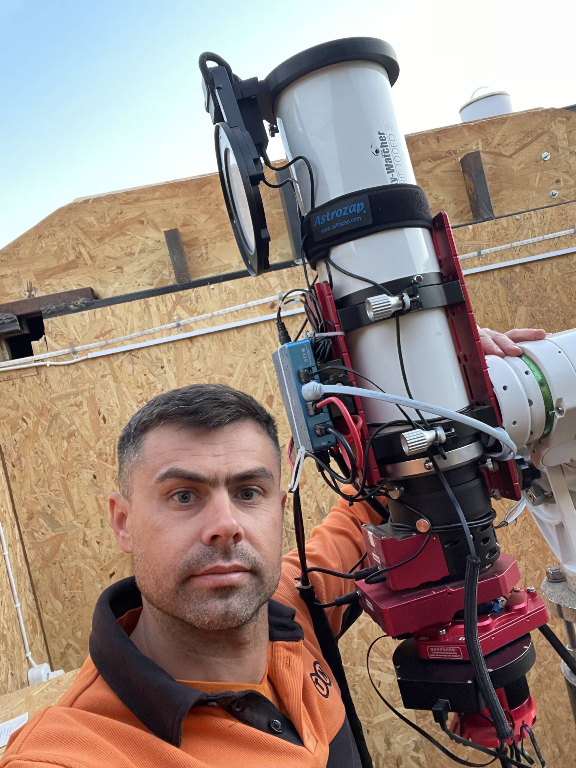

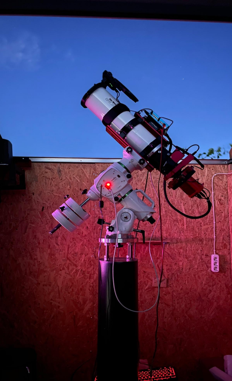

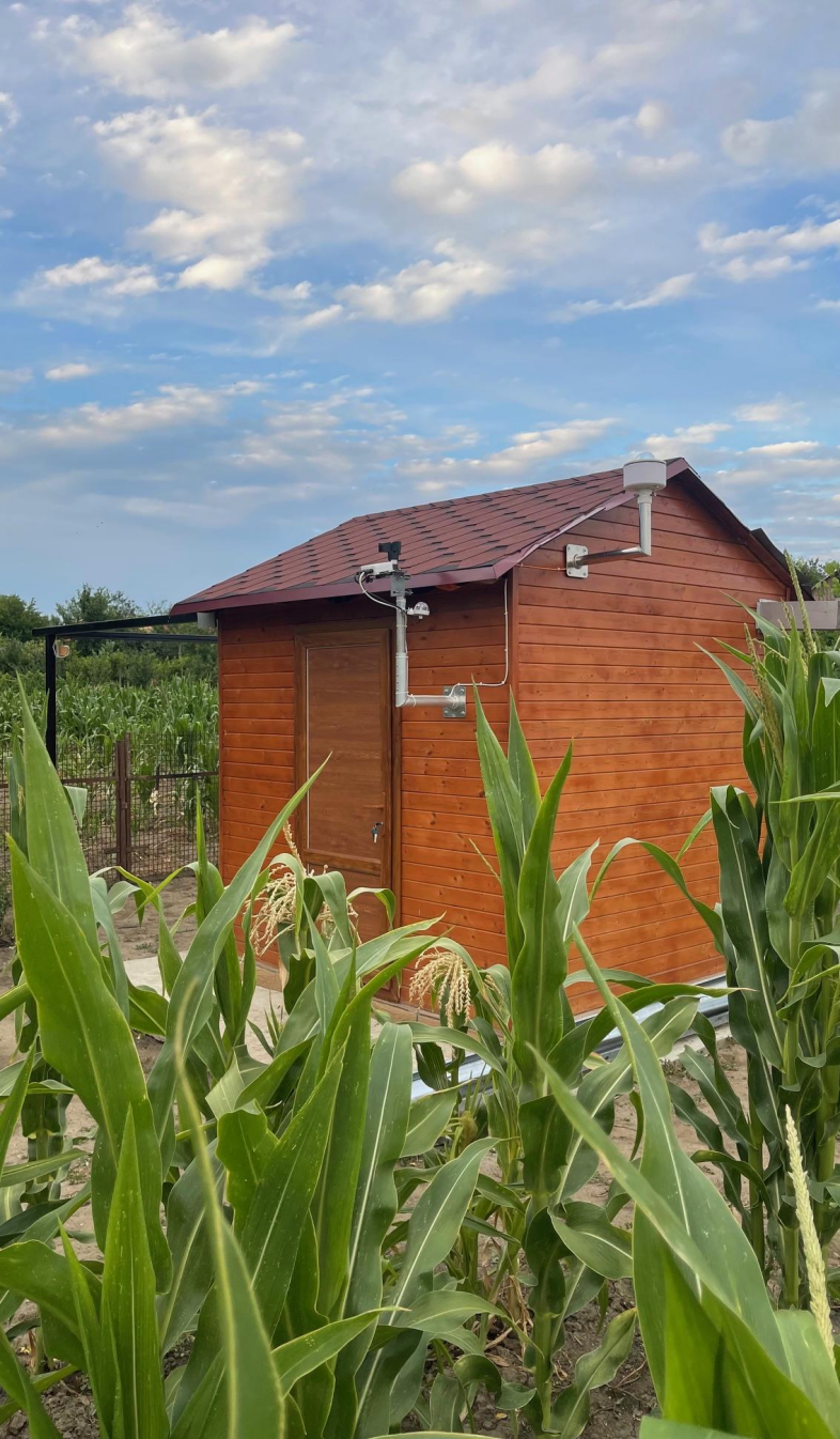

The greatest challenge for me was the designing and building the observatory. From the very beginning, it was planned to be fully autonomous and capable of remote operation. Two aspects proved to be particularly difficult: the motorized, retractable roof and the upgrading of the telescope for remote use.
For the roof, I opted for a system featuring specialized rails and bearings, ensuring it remains securely fixed even during unstable weather. A weather station from LunaticoAstro handles safety; should the weather become unstable, the roof closes automatically to protect all the equipment.
Regarding the telescope, the most difficult part was finding a way to measure and correct the tilt remotely. Fortunately, just at that time, the company Wanderer Astro introduced a solution that matched exactly what I was looking for: the Wanderer Astro ETA tilt adjuster.
The observatory located in my parents’ garden
Here you can clearly see how the ETA M54 Tilter adjuster from Wanderer Astro is integrated into the system.

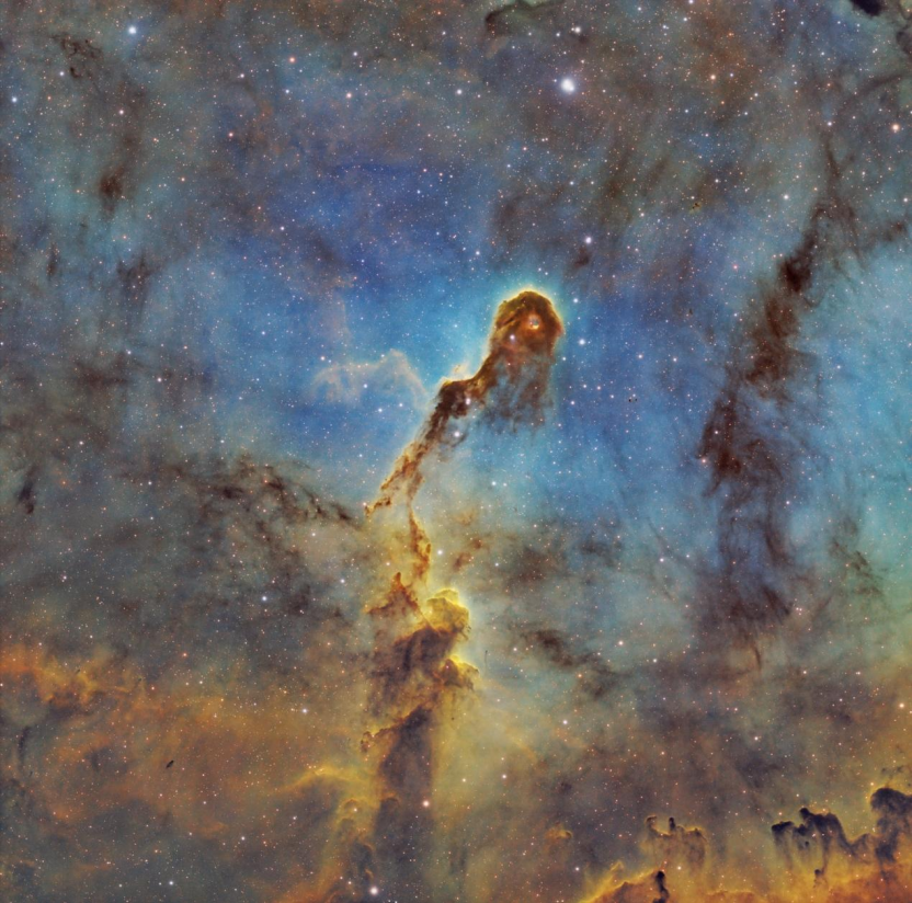

Elephant’s Trunk Nebula: IC1396; William Optics ZenithStar 103 paired with ZWO ASI533MM pro; 22 hours integration

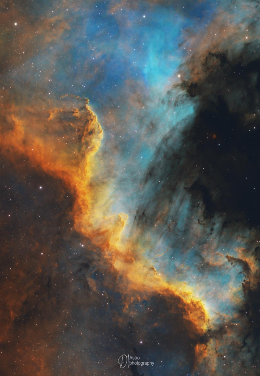

Cygnus Wall: NGC7000; William Optics ZenithStar 103/ZWO ASI533MM Pro; 24 hours integration

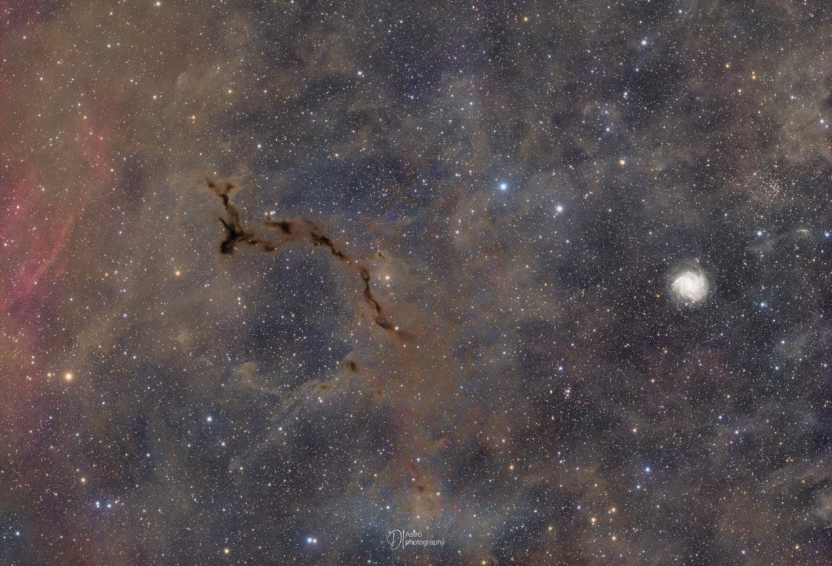

Barnard 150 and Fireworks Galaxy; William Optics RedCat 51 II/ ZWO ASI 294MC Pro, 16 hours integration; Bortle scale 2

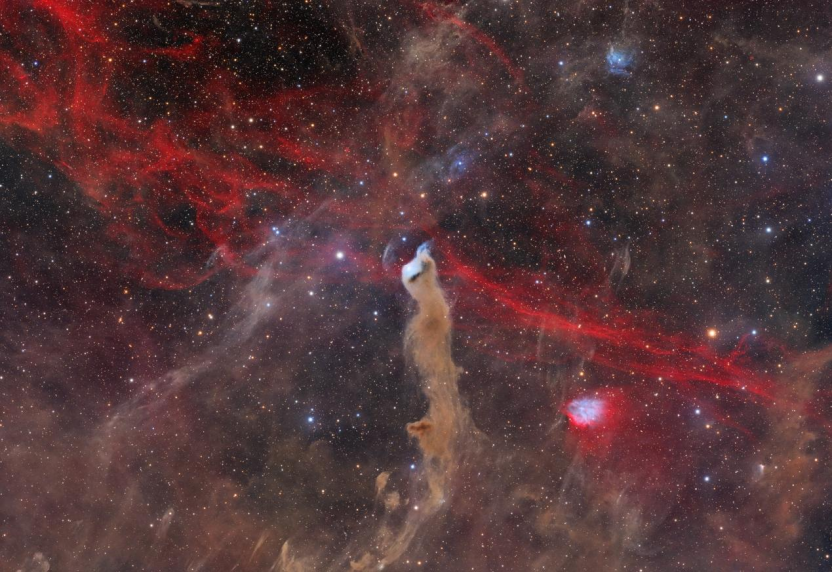

The fact that you selected this image as the “Image of the Week” is, without a doubt, a significant achievement for me. From the very beginning, this project was intended to reach over 100 hours of total exposure time, a first for me and I am very proud to have succeeded. Once I finished editing the image, I felt that all the effort invested had truly paid off. And then came the “icing on the cake”: your decision to name it “Image of the Week.” I have received a great deal of positive feedback, and it is wonderful.
For me, the Rosette Nebula is a subject I would choose to photograph every single time I had the chance. Its fascinating colors give it a truly fabulous appearance.
vdB152; Sy Watcher 100 Esprit/ ZWO ASI2600MM Pro; 108 hours integration

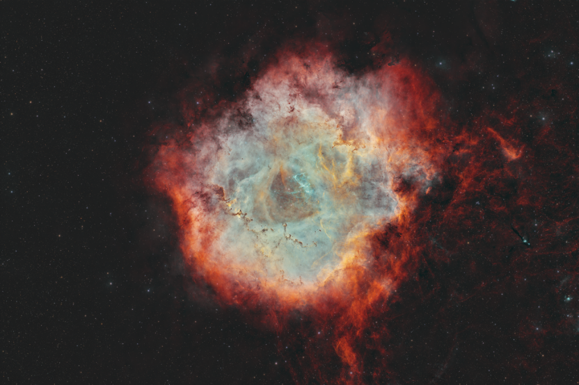

Rosette Nebula; Sky Watcher Esprit 100/ ZWO ASI2600MM Pro; 21 hours integration

Currently, my setup includes several ZWO products: the ZWO 2600MM Pro camera, the ZWO EFW 36 filter wheel, a ZWO off-axis guider, and a ZWO 174MM Mini guide camera.
The setup in the observatory that I am currently using

Looking ahead, I would like to see the development of products or solutions focused on remote control. A real challenge would be to integrate an off-axis guider—attached to a filter wheel—along with a field rotator, all within the 55 mm backfocus limit.
