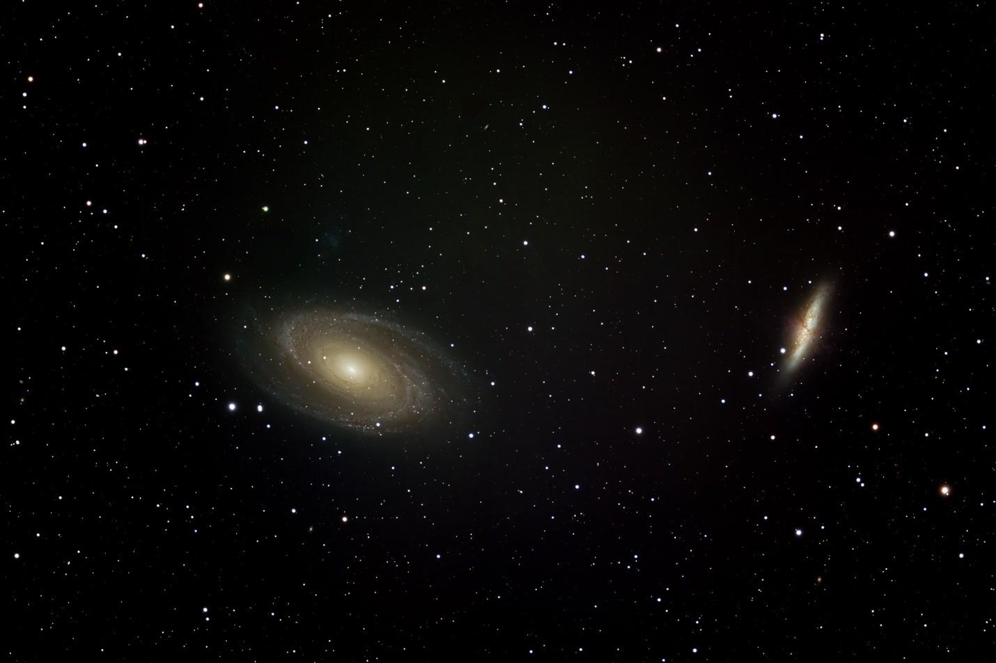

M81 and M82 galaxies captured using a TEC 180 FL telescope and ZWO 6200MM camera, RGB only 300s X 12 frames each, by Richard Harris
M81 and M82 Galaxies
The first spring target I point people toward is the Bode’s and Cigar pairing, M81 and M82. If you want one frame that immediately explains why galaxy season is worth losing sleep over, this is it. One galaxy is broad and orderly. The other looks like it has been roughed up by the neighborhood, which in a sense it has. They make a satisfying pair because you do not need to explain to your eyes what is going on. You can see the difference right away. In the same field you get graceful spiral structure on one side and a stretched, brighter, rougher profile on the other. That is a good night in one composition.
From a gear standpoint, this is one of the more forgiving galaxy pairings if you choose your focal length with some common sense. A small refractor in the 250mm to 500mm range works very well with a one shot color camera like a ZWO ASI533MC Pro or ASI2600MC Pro. If you are using a larger refractor or an 800mm class reflector, the pair still looks good, but on some sensors you start to give up the pleasing context around them. This is exactly the sort of spring target where the Seestar S30 Pro makes sense without forcing the issue. Its 160mm tele lens is not going to turn M81 into a close-up galaxy portrait, but it does give this pair room to breathe in one frame, and that matters. Beginners often chase magnification before they learn composition. M81 and M82 are a good cure for that.
My real advice on this pair is simple. Favor seeing over ambition. If the air is soft, do not imagine that a longer focal length will save you. It will only magnify your disappointment. Keep the galaxies high, be patient with total exposure time, and do not oversharpen tiny details into plastic nonsense in processing. If you want to push further later, a monochrome camera with luminance and a little hydrogen data on M82 can be rewarding, but you do not need that to make a frame worth keeping.

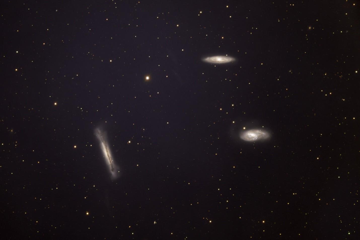

Leo Triplet galaxies captured using a RASA 11 telescope and QHY268C camera on the ZWO AM7 mount, 2 hours total exposure, by Richard Harris
The Leo Triplet
The second spring target on my list is the Leo Triplet. This is one of those images that makes people feel like they have crossed a line in the hobby. Three galaxies in one frame, each with its own shape, its own attitude, and its own lesson. M65 is composed. M66 looks more animated. NGC 3628 brings the long, flatter profile that balances the group. When I think of spring as a season, this trio is right there with it.
You can shoot the Leo Triplet with more than one kind of setup, but I think the sweet spot for most people is a telescope somewhere around 400mm to 800mm, depending on sensor size. An APS C camera like the ASI2600MC Pro on a mid focal length refractor gives a very balanced frame. A square sensor camera like the ASI533MC Pro on a scope around the 500mm range is often a comfortable match, too. If you are using the Seestar S30 Pro, you can still capture the trio, but here is where honesty matters. You will get a respectable small field composition, not a deep close study with dust lane drama. And that is fine. There is no shame in letting a target teach you what your current imaging scale is good at.
The better lesson with the Leo Triplet is not just focal length. It is sky quality. Spring galaxies respond to dark, transparent sky and stable air far more than they respond to clumsy overprocessing. Keep your subs clean, stack enough data to separate the galaxies from the background with some grace, and keep your star field under control. I have seen more spring galaxy images ruined by impatience in processing than by any camera limitation. Let the data breathe. If the faint outer arms are not there, do not invent them with contrast sliders.

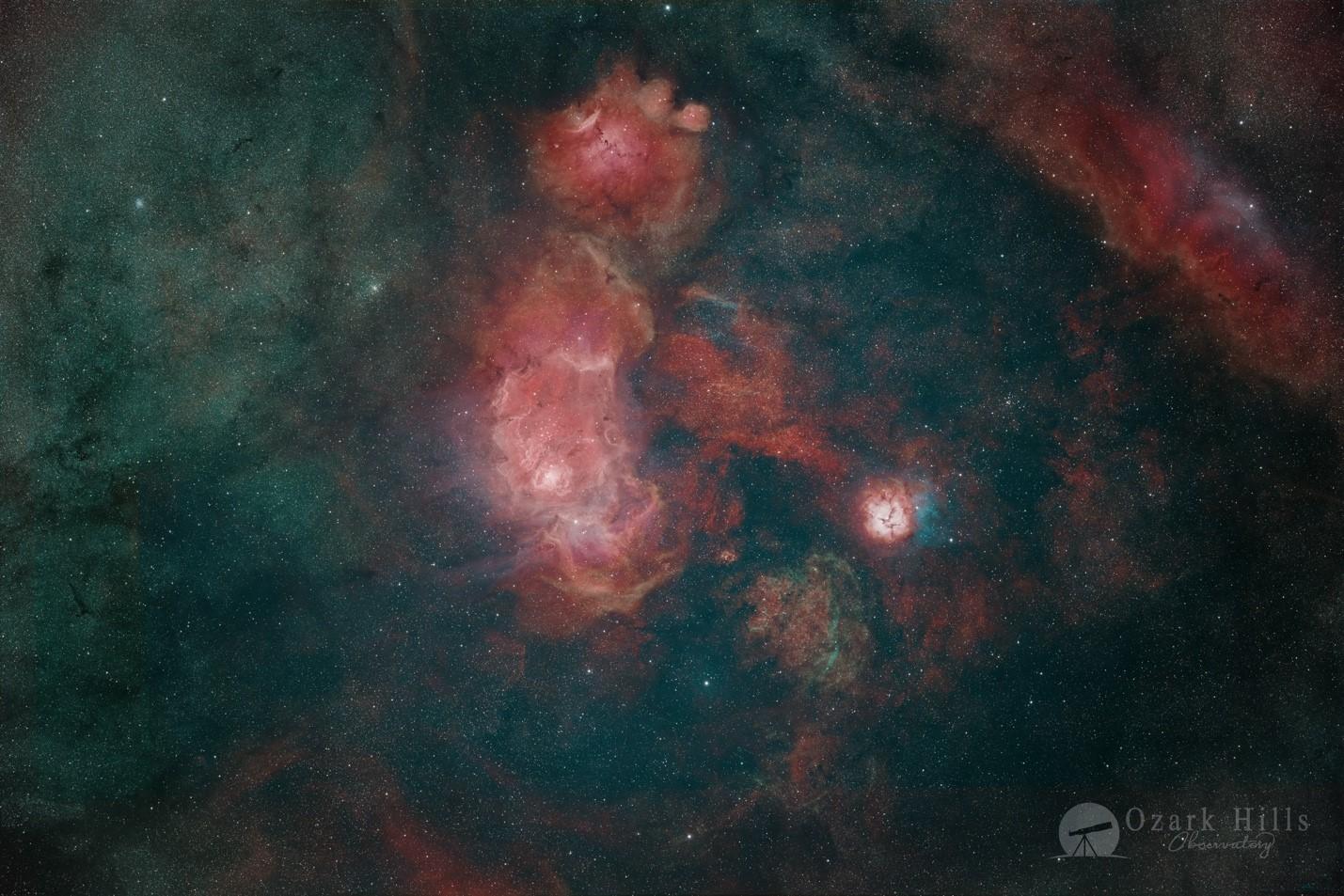

Lagoon and Trifid Nebulae captured using a Takahashi FSQ-106EDX4 astrograph and the ZWO 6200MM camera on the AM5 mount, 6 hours total exposure, by Richard Harris
The second summer target is the Lagoon and Trifid pairing. If spring is the season of subtlety, this is the season of payoff. Both objects sit in a rich part of the sky, and they reward short to medium focal lengths in a very satisfying way. In a single frame you get the broad pink glow of the Lagoon and the mixed structure of the Trifid, with enough surrounding stars to keep the whole thing feeling like a place rather than a specimen in a jar.
For most imagers, I think 135mm to 300mm is the sweet range here, especially with APS C or one inch class sensors. A compact refractor around 250mm to 400mm with a cooled one-shot color camera like the ASI533MC Pro or ASI2600MC Pro is excellent. With a monochrome camera and narrowband filters, you can go deeper still, particularly from light polluted locations. But this is one of those targets where a color camera already gives you a lot because the structure is strong and the field is generous.
This is also, to my eye, one of the most natural fits for the Seestar S30 Pro’s tele lens. At 160mm, it is short enough to take in the neighborhood and long enough to show that you are not just photographing a red smudge. In fact, if someone told me they wanted one summer deep sky image to justify carrying a Seestar on a trip, the Lagoon and Trifid together would be high on my list. You can set it up quickly, let the stacking build, and come away with a result that feels like real astrophotography instead of novelty astronomy.
