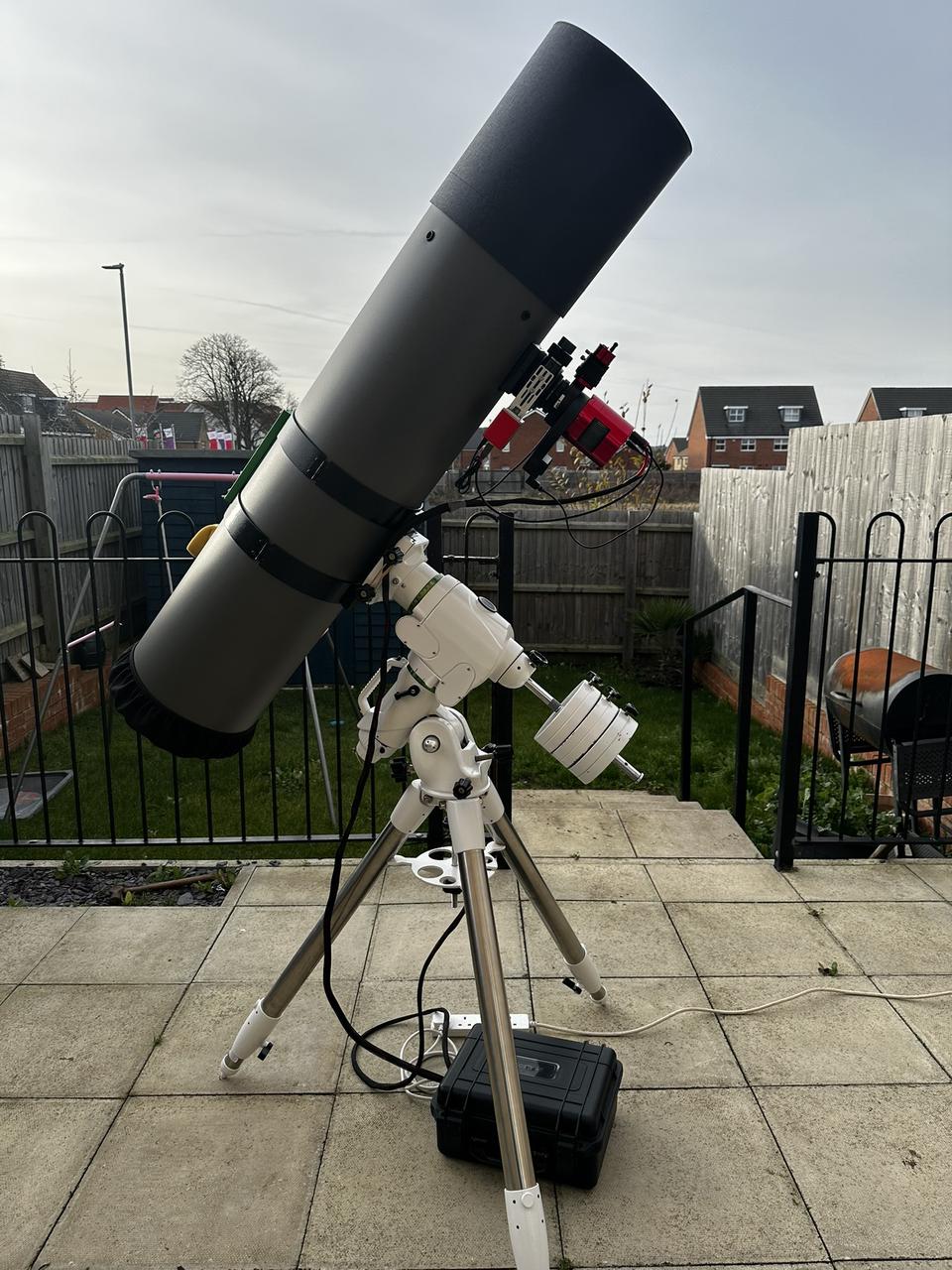

  • Telescope: Orion Optics UK Ideal 10” f/4.8 (1200 mm)
  • Mount: SkyWatcher EQ6-R Pro GoTo
  • Focuser: ZWO EAF (Electronic Automatic Focuser)
  • Guiding: ZWO OAG-L + ASI220MM Mini guide camera
  • Camera: ZWO ASI2600MM Pro (cooled monochrome)
  • Filter Wheel: ZWO EFW 7-position
  • Filters: ANTLIA 3nm HSO Pro Narrowband + LRGB V-Series Pro (36 mm)
  • Corrector: SkyWatcher f/4 Aplanatic Coma Corrector
  • Acquisition Software: N.I.N.A.
  • Power & Control: MeLE Overclock 3cStacking & Processing: PixInsight

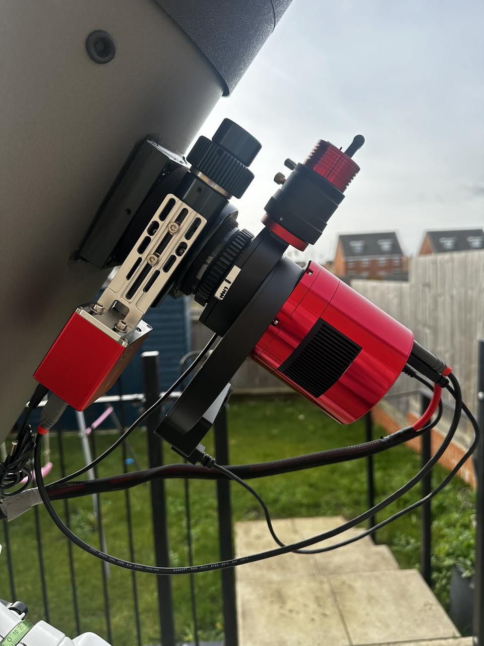

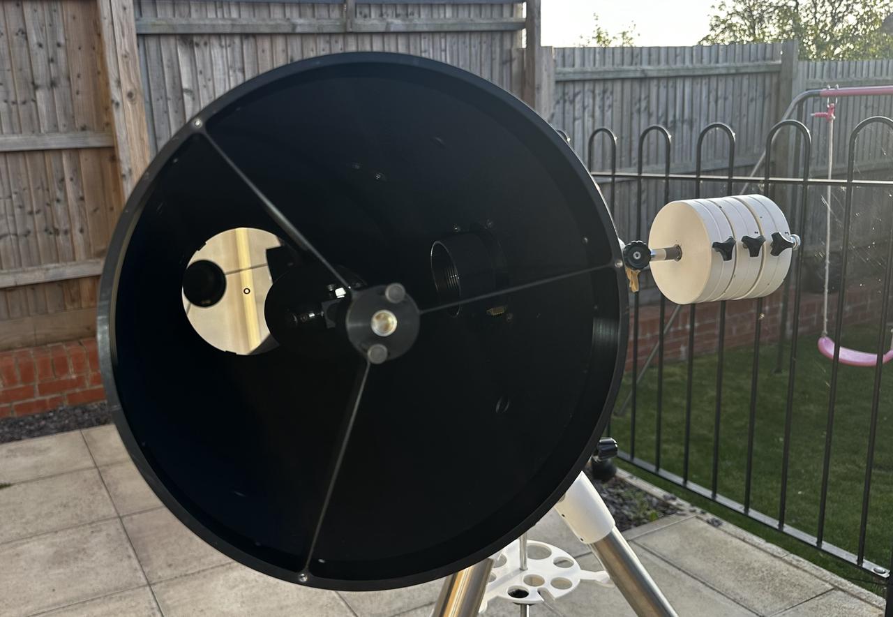

“My setup has evolved significantly over time. I moved from an 8-inch to a 10-inch Newtonian, which is now fitted with an AstroBiscuit “Betty’s” full front-end upgrade, including a 3-vane CNC spider and secondary mirror holder. This upgrade has made collimation much easier and more precise when used with an OCAL electronic collimator. I also transitioned from using a dedicated guide scope to a ZWO L-OAG, which eliminated flexure within the telescope tube and greatly improved guiding accuracy.”
Meeting Astro Biscuit to get measured up for Bettys front
Full Bettys front end
