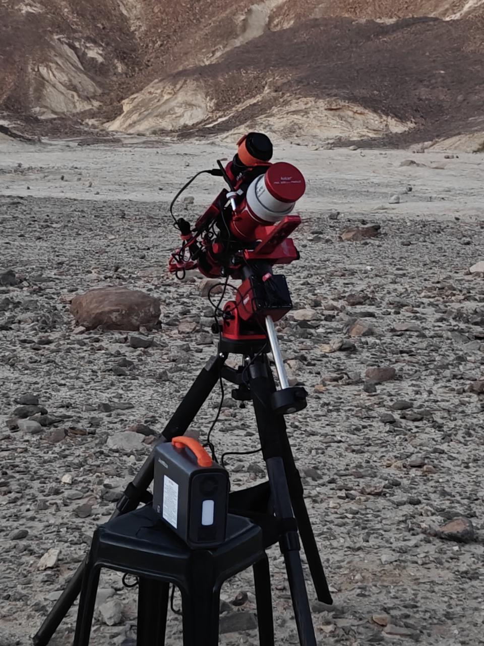

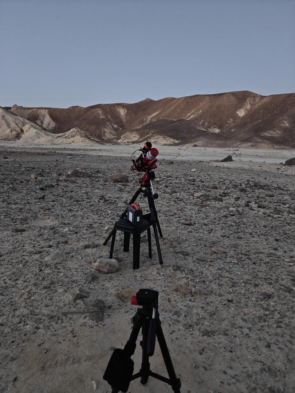

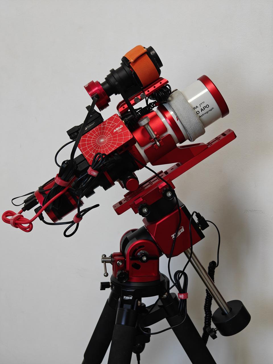

I’ve parked my car as far away from other people as possible, and started to unpack my gear which also includes a small portable power station (302~ Wh), hooked everything up, did an almost perfect polar alignment with an RMS error of less than 30 arcseconds, did the guiding calibration, made an automatic plan and let the gear run for all night long. At the beginning of the session there were some high clouds so I lost about 20 minutes of data.

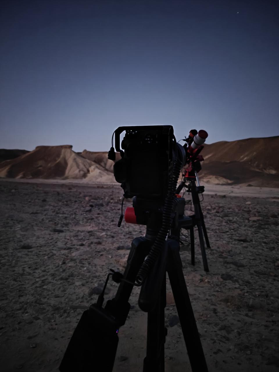

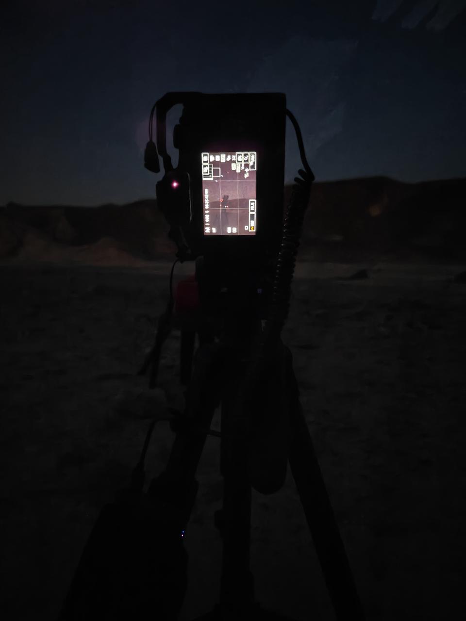

After I let it run, I’ve also unpacked my small canon mirrorless camera on a tripod, attaching a dummy battery to it which connected to a USB PD power bank, framed it so it will capture the whole gear with the milky way in the background and let it photograph a timelapse for over 7 hours.

Telescope & Mount: Askar FRA300 Pro, ZWO AM3
Camera: ZWO ASI533MC Pro
Guiding: SVBony SV165 Mini Guider Scope 30mm, ZWO ASI120mm-s, ZWO EAF
Filter & Accessories: ZWO Filter Drawer, ASIAir Plus, Optolong UV/IR Cut 2”
Camera Settings: Gain 100 / Temperature 0°C (32°F)
Calibration Frames: 100 pre-calibrated darks, 30 flats, 30 dark flats
Timelapse Video Details:
Camera: Canon EOS R50
Lens: Sigma 17-50mm f2.8 EX DC OS HSM
Focal Length / Exposure / Aperture / ISO: 17mm, 10s, f2.8, ISO 6400
Intervalometer: Used my phone as the intervalometer (a paid app, since Canon R50 doesn’t support intervalometers)
Total Photos: 1019
