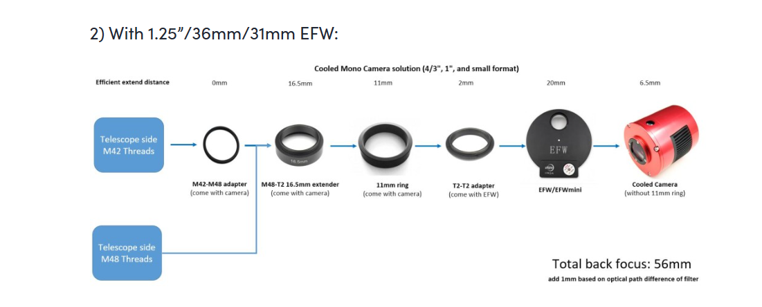

For cooled monochrome cameras, we generally recommend pairing them with an EFW or a filter drawer for optimal performance.
If you’re using a 1.25″ / 36mm / 31mm EFW, the connection setup is as follows:
If you’re using a 2″ EFW, the connection setup is as follows:
Note: The back focus: 56mm.The combination T2–M48 (16.5mm) + M48–M42 can be replaced with an M48–M48 (16.5mm) adapter.

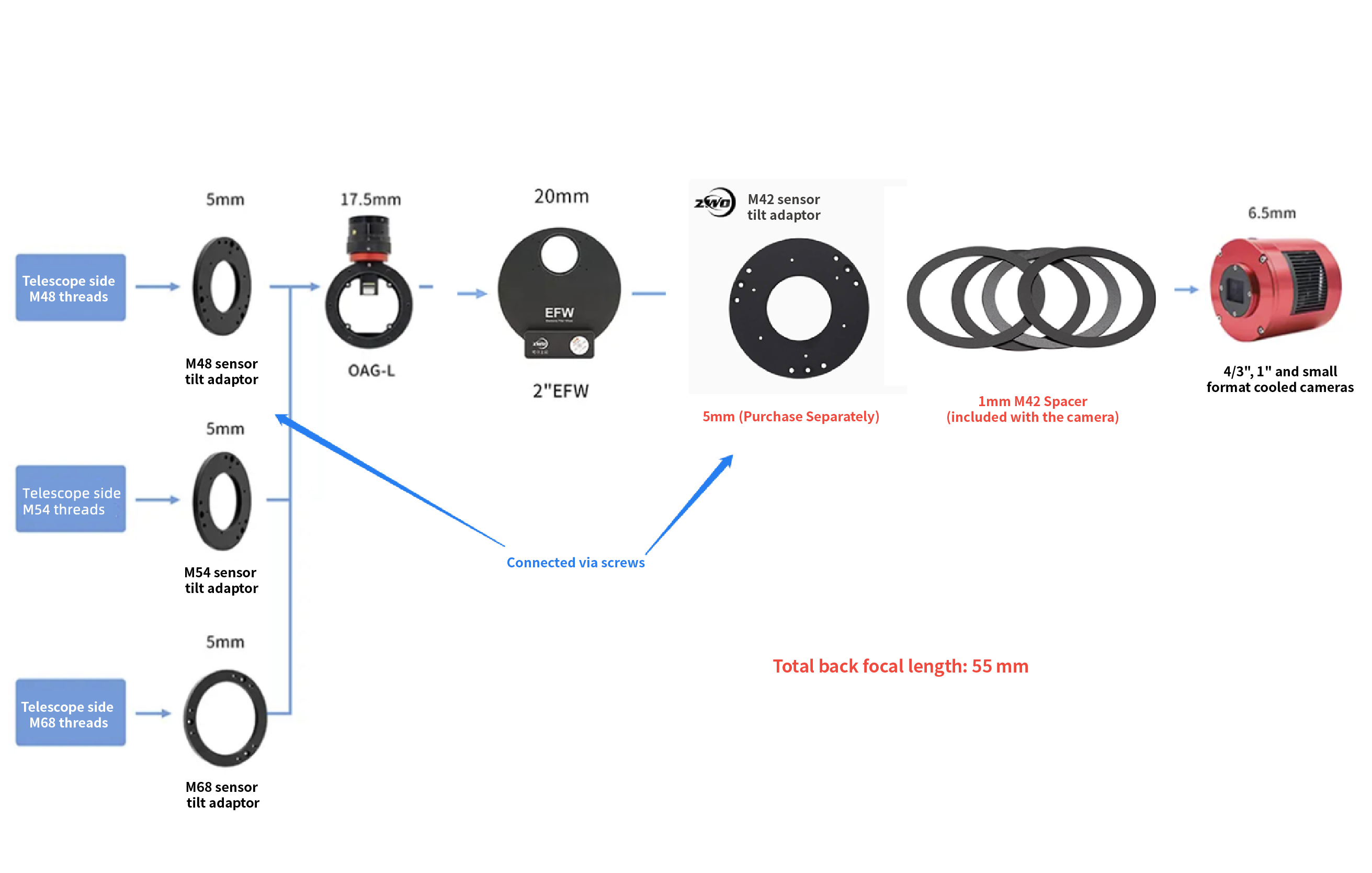

If you are using the OAG-L and require a 15mm extender, the connection setup is as follows:

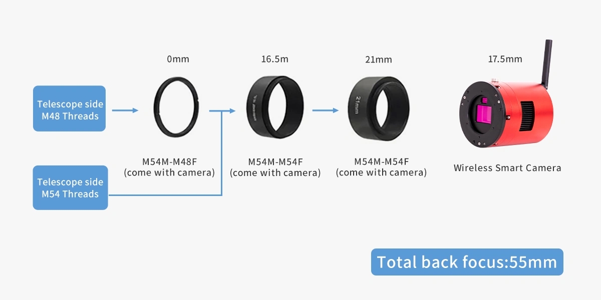

Wireless Smart Cameras
Currently available wireless smart cameras include ASI585MC Air and ASI2600MM/MC
Air.
ASI585MC Air:
ASI585MM Air:
ASI2600MC Air:
ASI2600MM Air:

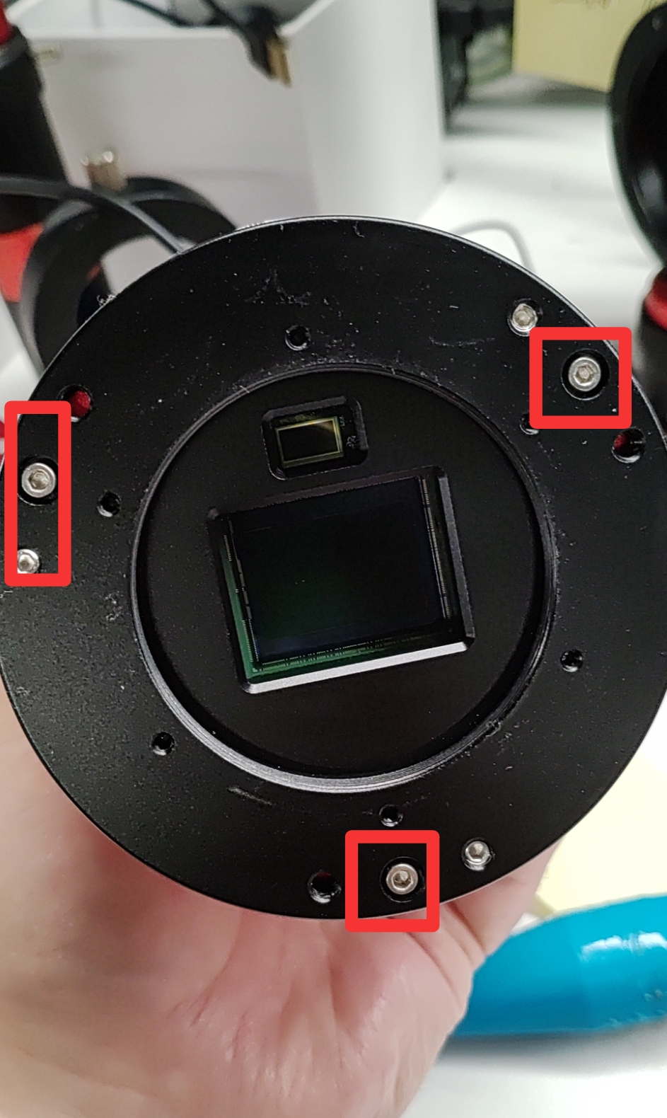

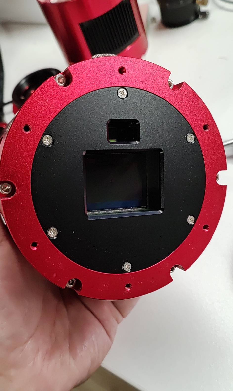

  • Michael
    Posted September 27, 2025 at 10:50 pm
    What do we do for AIR cameras such as the 585 and 2600. It appears we cant remove the 11mm on the tilt plate and still also have a thread on the camera.
    • sasa.wang@zwoastro.com
      Posted September 30, 2025 at 5:45 pm
      The three screws of the target ring can be removed. There is no thread after removing the target ring.ZWOZWO
