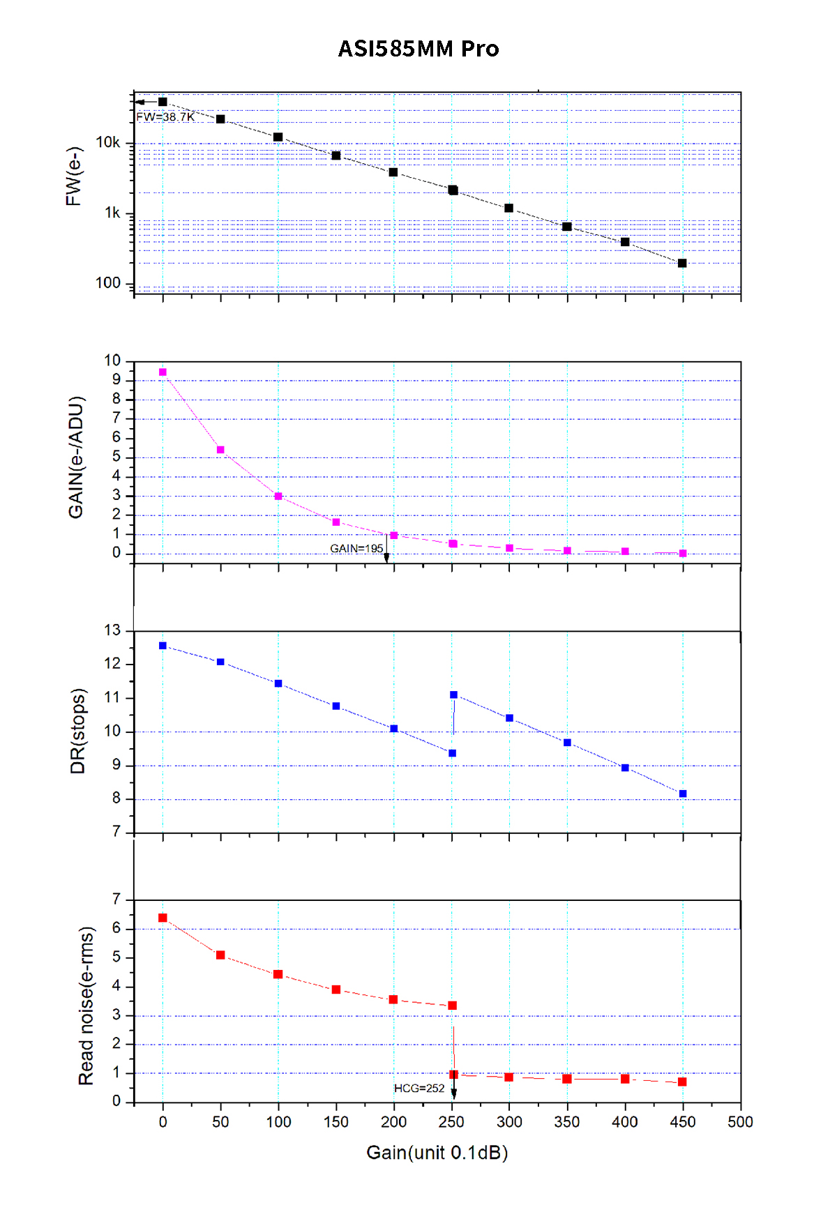

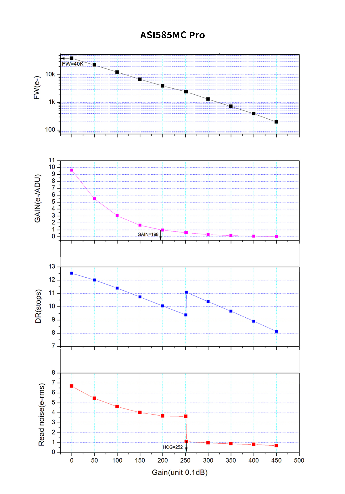

The camera has a built-in HCG mode, which can effectively reduce read noise at high gain and allow the camera to maintain the same high dynamic range as it does at low gain.
When the gain reaches 200, the HCG mode will be automatically turned on and the dynamic range reaches a level close to 12bit. The read noise in this case can be as low as 0.7e.
