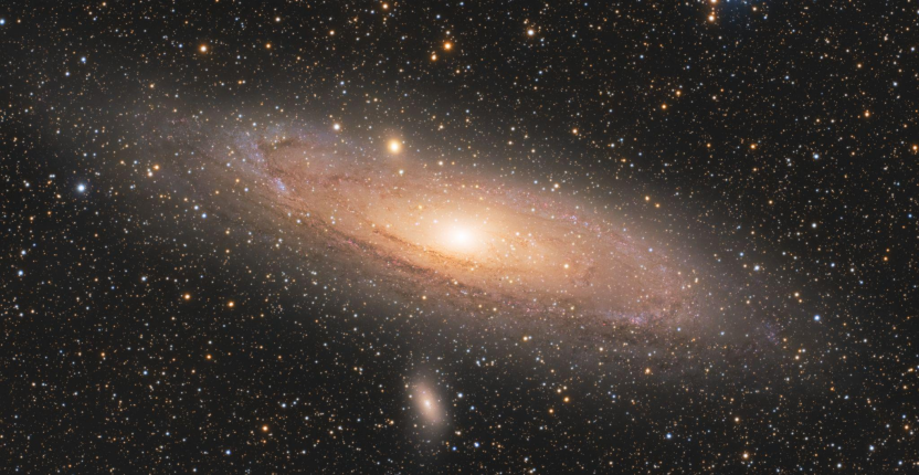

M31 captured with my 678MC paired with a Samyang 135mm F/2 lens on a Sky-Watcher Heq5 PRO. Total exposure length is 25h 41m made up from 30s sub-exposures. This image captured the nova AT2025abao in great detail as it increased and faded in strength.

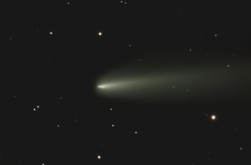

Comet C/2025 A6 Lemmon: Captured with my ASI678MC paired with my Samyang 135mm F/2 lens. 34m 30s of total exposure (30s sub-exposures).

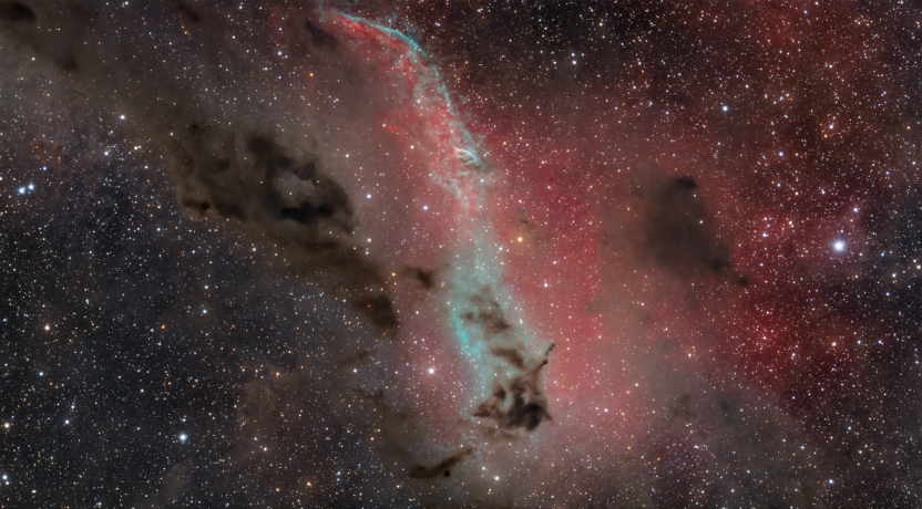

SNR G150.3+4.5: Part of an ancient supernova remnant surrounded by dark nebulae. I used my ASI585mm PRO, Heq5 Pro, SvBony SV555, Touptek LRGB filters and Laida 5nm Ha/Oiii filters. Total exposure: 55h 35m

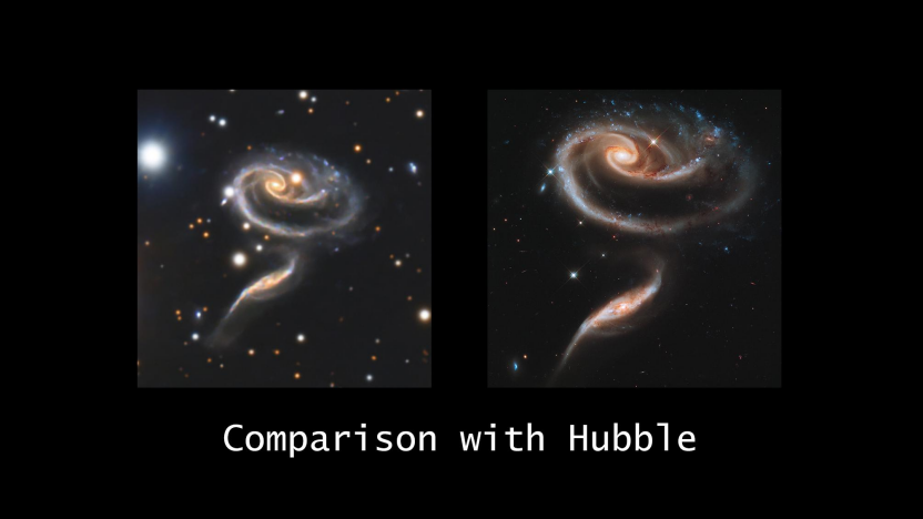

Arp 273: A comparison image I created from my own Arp273 image and the one captured by Hubble. My image was captured using my 2600MC, Celestron Edge 8HD and AM5 (no filters). The image has a total exposure of 19h 21m.

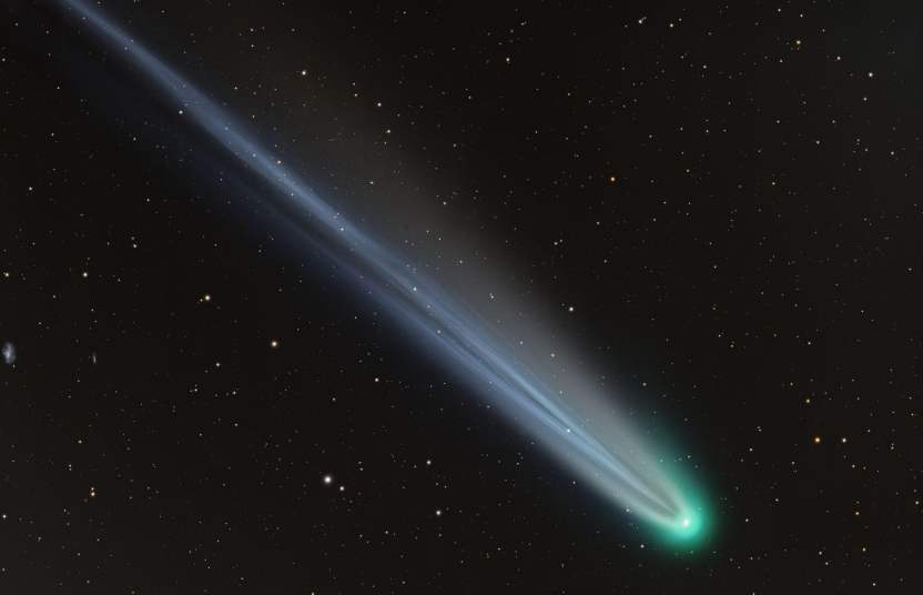

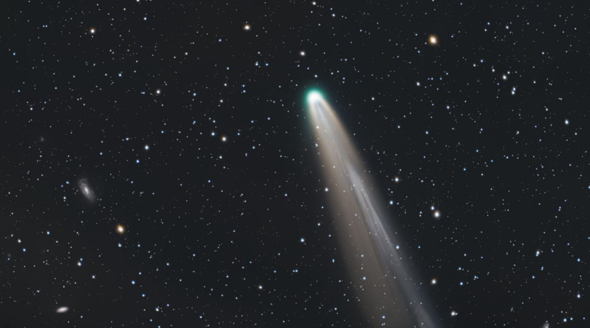

C/2025 A6 Lemmon: Captured with my ASI2600MM, Esprit 100ED and Antlia LRGB filters (Exp: 1h 18m).

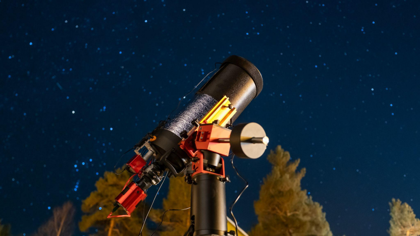

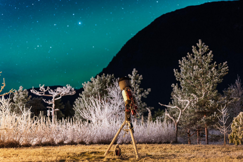

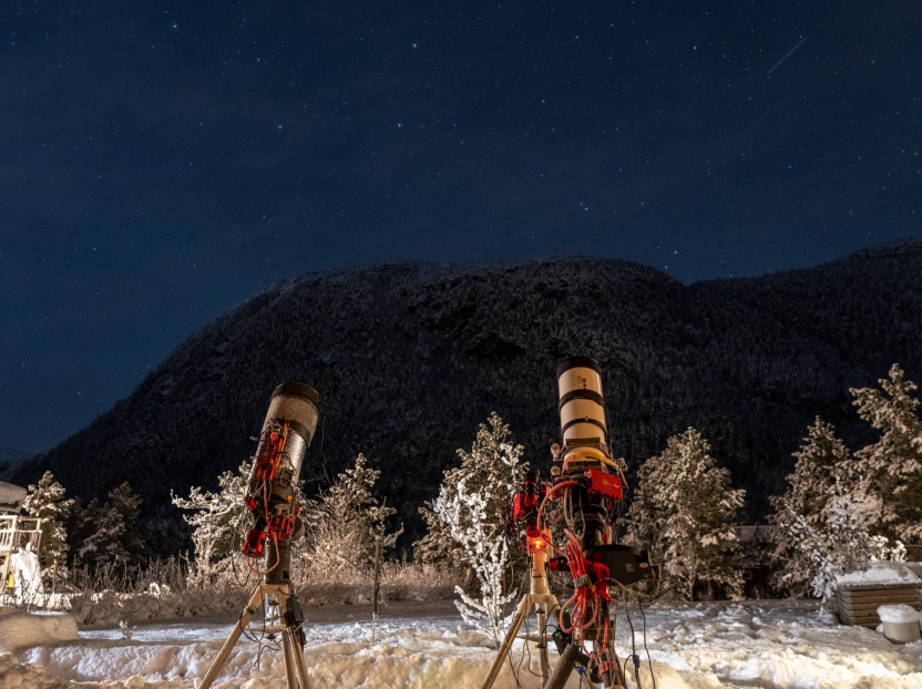

The most apparent challenge I’ve had was while transitioning from refractors to SCT and long focal length imaging. Several times the tube filled with condensation despite using dew heaters, I’ve had unexpected snow laying on the corrector plate, frost building up inside the dew shield and more. Though imaging and collimation was simple and working well, issues with my climate and handling the larger diameter tube/glass proved difficult.
Celestron Edge 8HD SCT modified to handle the challenging climate, sitting on top of my trusty AM5.
Luckily we have a very good community and I receivedhelp finding necessary counter measures to modify the telescope and it’s now flawless in all conditions.

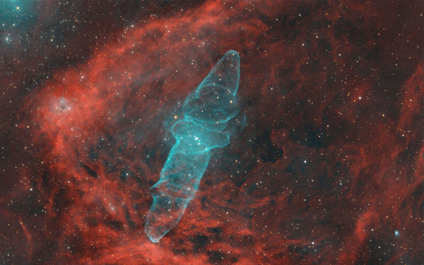

Sh2-129 & Ou4: ASI2600MM, Antlia RGB + Ha/Oiii filters and Esprit 100ED. Exposure length: 49h 36m,

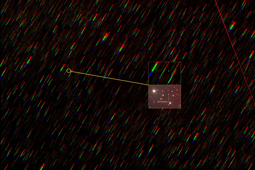

First I came across a fast moving object too big to be rejected in stacking, strikingly similar to a comet which I initially thought it to be. After much time spent on checking I finally came across the answer using MPChecker. Enveloped in the hydrogen alpha region there was an orbiting minor planet, 3401 Vanphilos. A very happy coincidence and testament to the science we may contribute to while imaging from our backyards, as well as the importance of studying the data we collect.

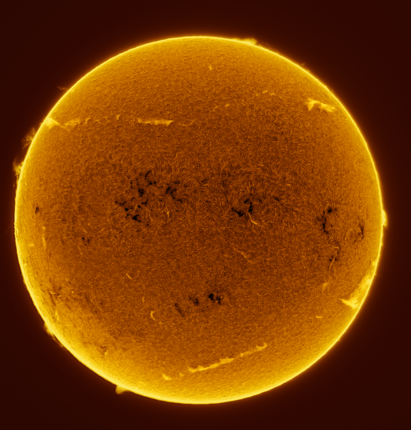

The Sun: ASI678MM, Heq5 Pro and Acuter Elite Phoenix 40 H-alpha solarscope. 197x5ms

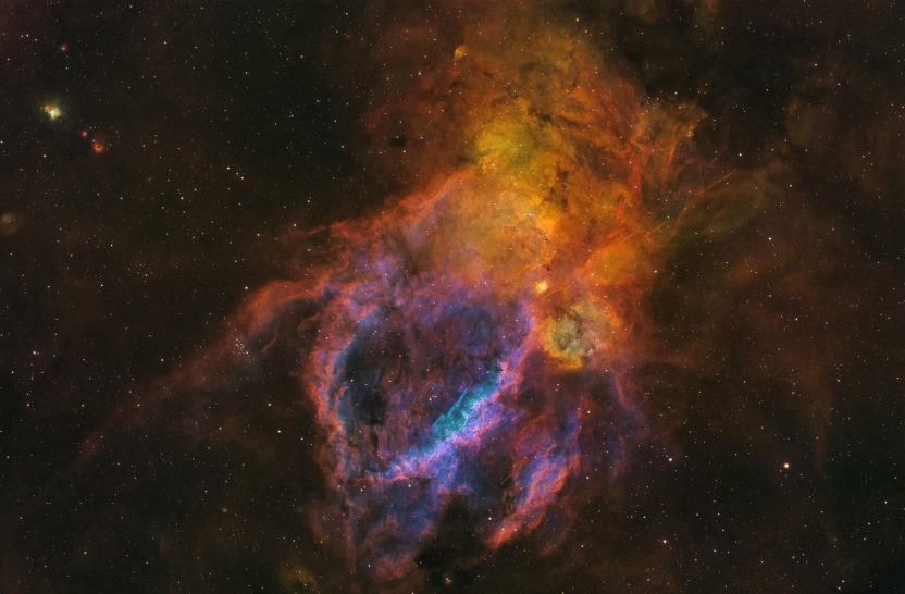

Sh2-199: ASI2600MM, Esprit 100ED, Antlia RGB + Ha/Oiii filters. Exposure length: 44h 15m
