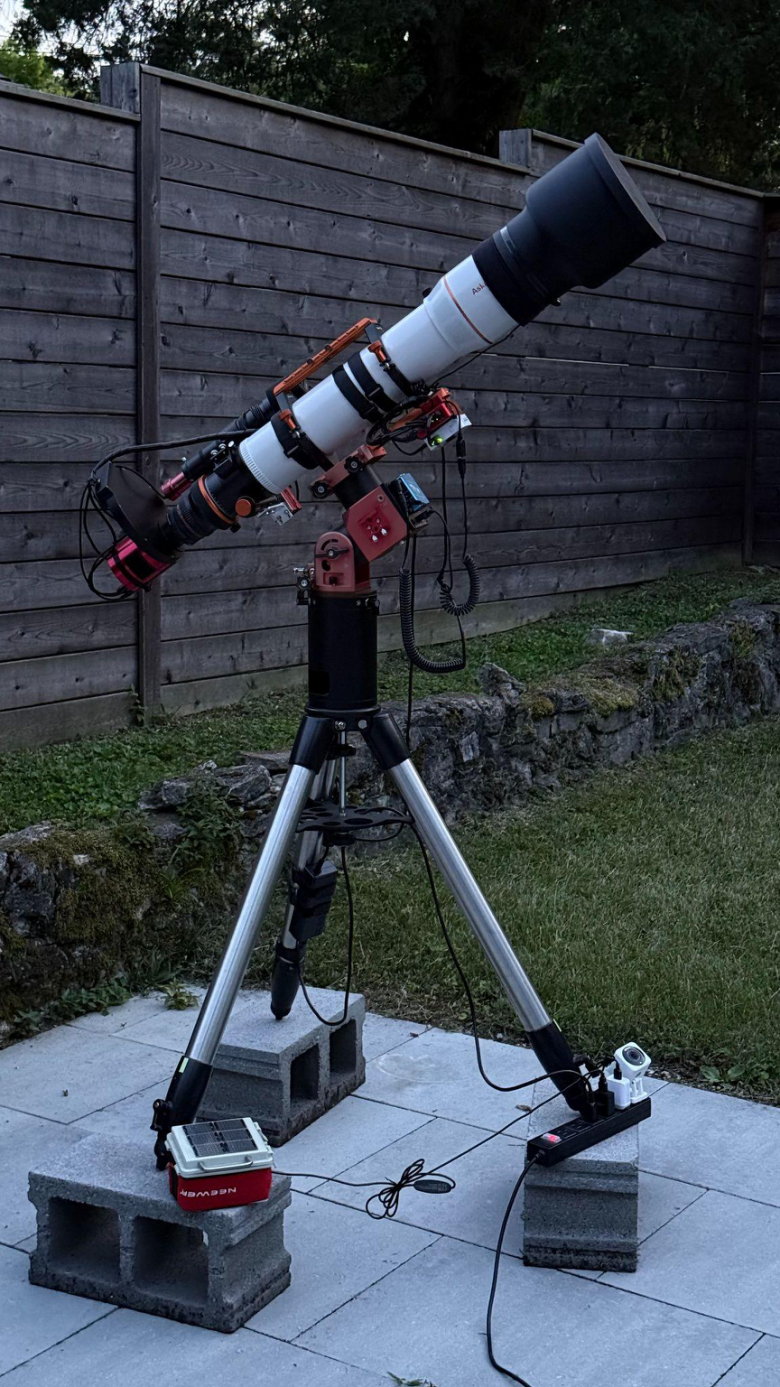

My current main combo is:
Main Setup (2025):
  • Scope: Askar 120 APO
  • Mount: ZWO AM5
  • Main Camera: ZWO ASI2600MM Pro
  • Filters: Antlia 3nm S & H, Chroma 3nm O, (and Astronomik RGB when I’m feeling brave under my Bortle 8.5)
  • Accessories: ZWO EAF, ZWO EFW
  • Controller: ZWO ASIAIR Plus
    I also have a TPO 180 ultrawide for massive targets, a C8 for planetary imaging, a William Optics Redcat 61, a RASA 8, and a handful of lenses for really wide-field images. I used the wide-field TPO 180 for several years, taking deep images of big swaths of sky, and now I’m using the Askar 120 APO to zoom in on some of my favorite parts of my previous wide-field images.
Most of my imaging happens right in my backyard in Nashville under a Bortle 8.5 sky. It’s not ideal, but narrowband filters make it possible. Imaging from such light-polluted skies means I need to do very long integrations to get the results I want. I often go a little overboard with integration time (200 hrs isn’t uncommon), but that’s how I like to do things.

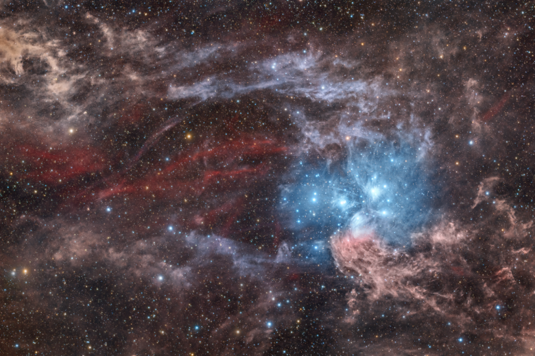

One of the most incredible moments I’ve had with astrophotography wasn’t a single night — it was an image that unfolded over years. The first winter I attempted the Spaghetti Nebula, I didn’t get nearly as much integration time as I hoped for. It’s such a faint target that you really only start to see good detail after many hours, and by the time winter ended, I knew I was going to have to continue the project the following winter.
When the second winter rolled around, I started planning my sessions and framing the target again. That’s when I noticed something surprising — Mars was slowly making its way toward my field of view. And there was one night where it would be perfectly opposite the bright star Alnath in my frame.
With a big stroke of luck, the night to capture mars was a clear one.
There was this moment where I sat back and thought: “Okay… this is going to be special.”
Not only was I gathering a massive integration on one of my favorite faint targets, but now I had captured a special visitor. You don’t get opportunities like that very often!
I knew I wasn’t stopping at two winters. I committed to a third winter on the same project — partly out of stubbornness, and partly because it was just too good to pass up a deep, multi-year integration on a super faint supernova remnant with Mars making a cameo appearance right where I needed it.
That combination — patience, timing, and a little bit of luck — is something that rarely seems to work out the way you want it to, but it did this time. Having the willpower to wait it out and dedicate that many clear nights to one image, to me, is quite an achievement!
The Spaghetti Nebula and Mars
Total integration: 569h 4m 30s
Integration per filter:
R: 25m
G: 25m
B: 25m
Hα: 178h 18m
SII: 175h 53m
OIII: 213h 38m 30s

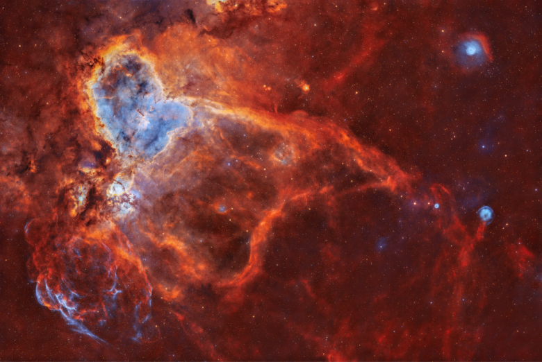

Heart Nebula Widefield
Total integration: 405h 22m
Hα: 141h 30m (1698 × 300″)
SII: 143h 52m (1079 × 480″)
OIII: 120h (720 × 600″)
Equipment:
Telescope: Askar FMA180
Mount: ZWO AM5
Filters: Antlia 3nm Narrowband H-alpha 2″, Antlia 3nm Narrowband Sulfur II 2″, Chroma OIII 3nm Bandpass 2″
Accessories: ZWO ASIAIR Plus, ZWO EAF, ZWO EFW 7 x 2″
Software: Adobe Photoshop, Pleiades Astrophoto PixInsight, ZWO ASIAIR

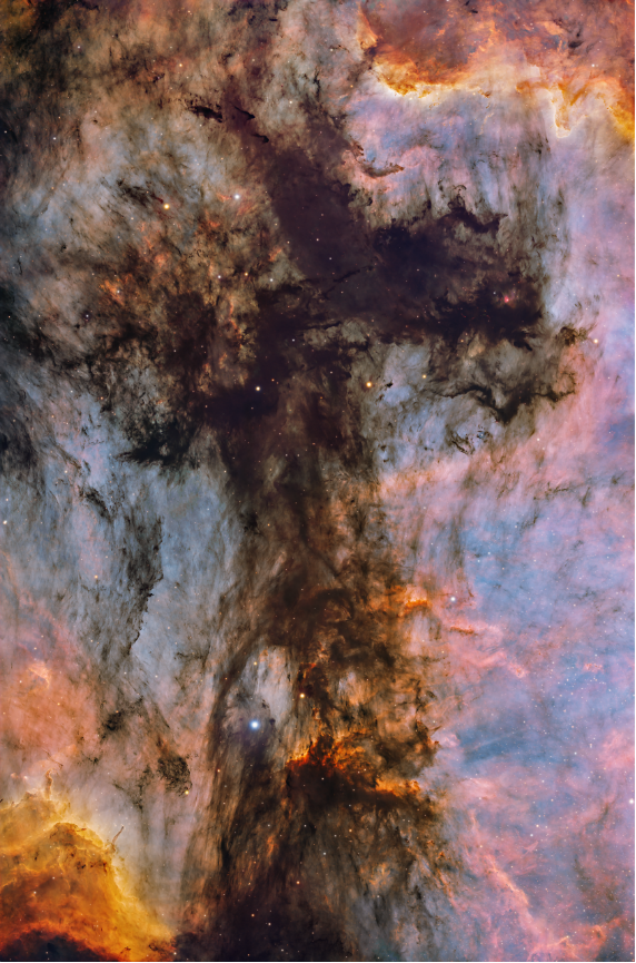

The Cygnus Rift
Total integration: 364h 57m
Lum/Clear: 29h 19m (1759 × 60″)
R: 10h 36m (212 × 180″)
G: 8h 39m (173 × 180″)
B: 9h 48m (196 × 180″)
Hα: 103h 30m (1242 × 300″)
SII: 101h 30m (1218 × 300″)
OIII: 101h 35m (1219 × 300″)
Equipment:
Telescope: Askar 120APO
Mount: ZWO AM5
Filters: Antlia 3nm Narrowband H-alpha 2″, Antlia 3nm Narrowband Sulfur II 2″, Chroma Blue 2″, Chroma Green 2″, Chroma Lum 2″, Chroma OIII 3nm Bandpass 2″, Chroma Red 2″
Accessories: Askar 0.8x Full Frame Reducer / Flattener for 120APO Telescope, ZWO ASIAIR Plus, ZWO EAF, ZWO EFW 7 x 2″
Software: Adobe Photoshop, Aries Productions Astro Pixel Processor (APP), Pleiades Astrophoto PixInsight, ZWO ASIAIR

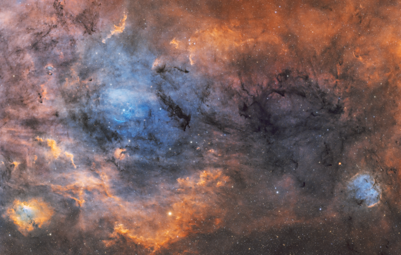

The Soul Nebula became a bit of an experiment, to see if imaging a bright and traditional target, but going very deep, would be worth it. I got about 235 hours of integration, which is far more than most people would spend on a bright target like this. What surprised me was how much subtle structure and depth emerged as the data accumulated. The processing came naturally — the image almost seemed to process itself.
So, I plan to strike a balance: going extremely deep on a few popular targets where long integration might reveal something incredible, while also continuing to take deep integrations of some interesting lesser-known regions that have shown up in my wide-field images. There’s one particular faint and under-appreciated area in Cepheus that I’m especially excited about — it’s likely to become a full-summer project for me.
The Soul Nebula
Total integration: 234h 55m
Hα: 78h 50m (946 × 300″)
SII: 79h 30m (954 × 300″)
OIII: 76h 35m (919 × 300″)
Equipment:
Mount: ZWO AM5
