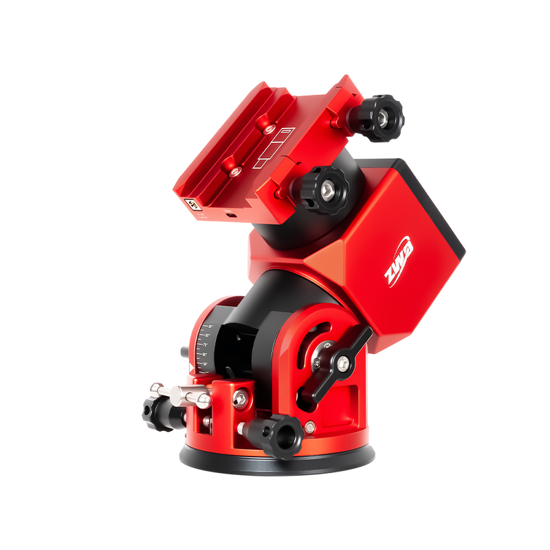

Strain Wave Gears for Precision Control
Astrophotography demands both stability and accuracy, and the adoption of a custom-engineered strain wave gear system addresses these needs directly. The gear train is designed to minimize periodic error, provide exceptionally smooth motion, and deliver high torque capacity—factors critical for long-exposure imaging.
Within the mount, a strain wave gear reducer works in concert with a synchronous belt drive, yielding precise control and a notable 300:1 reduction ratio. Each unit undergoes individual testing, and a periodic error (PE) curve report is supplied with every mount, offering users verified performance data for confidence in the field.

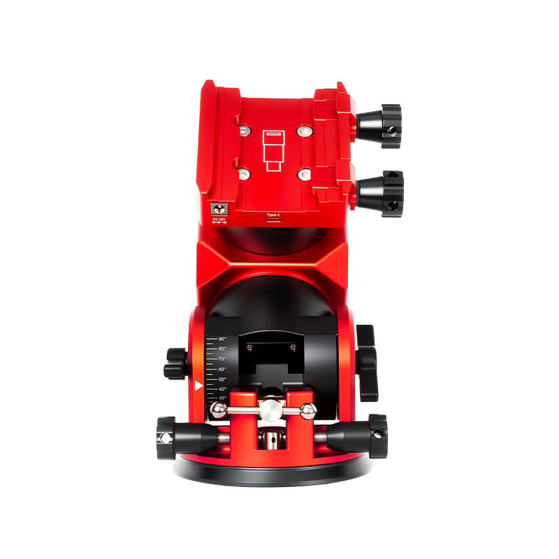

Integrated Type-C and DC Power Ports
The upgraded AM3N weighs just 4.1 kg (9.04 lbs), with a newly optimized design for improved portability and cable management. The dovetail saddle now integrates Type-C and 12V DC ports to minimize clutter, while a magnetic hex key attaches directly to the mount for convenient storage.

All-round 0°-90° Altitude Scale
The AM3N features a versatile altitude adjustment design ranging from 0° to 90°, allowing for unrestricted use across both low-and high-latitude regions.
Gear 1: Rotate the altitude tension knob for adjustment between 0 and 60.
Gear 2: Loosen the M6 hex screw, and allows adjustment from 30 and 90.
