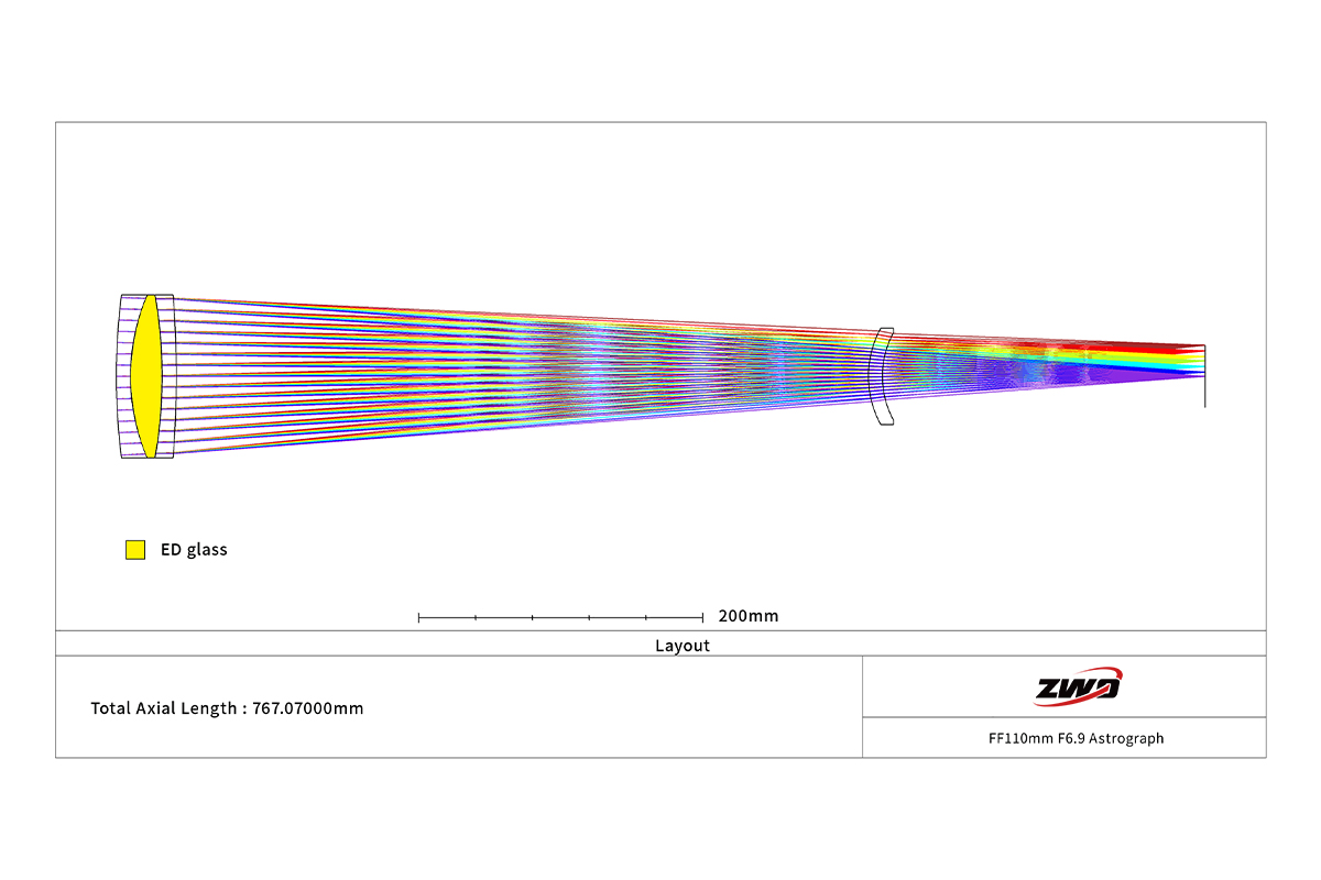

1. Four-Element Optical Design
The FF110 APO features a four-element, fully air-spaced apochromatic optical design. All four elements work together to deliver a flat imaging field without the need for an additional field flattener.
One ED (extra-low dispersion) glass element is incorporated to effectively reduce chromatic aberration, resulting in improved color correction and image clarity.

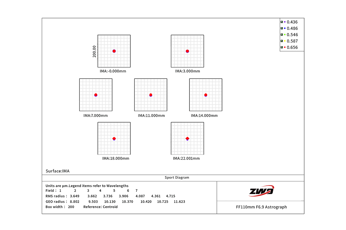

2. 44 mm Image Circle — Full-Frame Support
With a 44 mm image circle, the FF110 APO fully supports full-frame sensors and a wide range of imaging setups.
It delivers sharp star fields with excellent edge-to-edge performance, ensuring consistent image quality across the entire frame.
3. Native Flat-Field Design
The FF110 APO features a native flat-field optical design, eliminating the need for an additional field flattener.
No complex back focus calculations or spacing adjustments are required—simply attach your imaging setup and start capturing once focus is achieved.

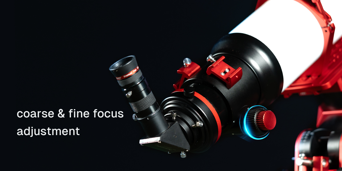

4. Coarse & fine focus adjustment
Equipped with a rigid 3-inch rack-and-pinion focuser, the FF110 APO offers precise control with a 1:10 coarse & fine focus adjustment mechanism.
A built-in 360° rotator at the rear allows for smooth and accurate camera angle adjustments.

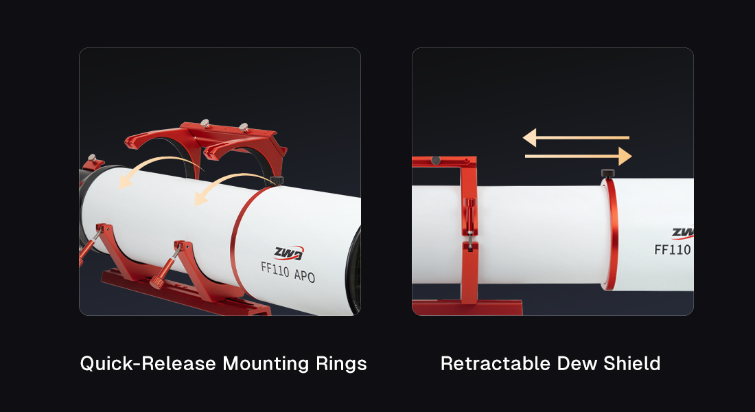

5. Retractable Dew Shield
The FF110 APO features a retractable dew shield, reducing overall length for improved portability.
Precision CNC machining and a high-quality painted finish, combined with an internal anti-reflection coating, help minimize stray light and enhance image contrast.
6. Quick-Release Mounting Rings
The mounting rings are detachable, allowing for quick and easy setup or teardown of the telescope.

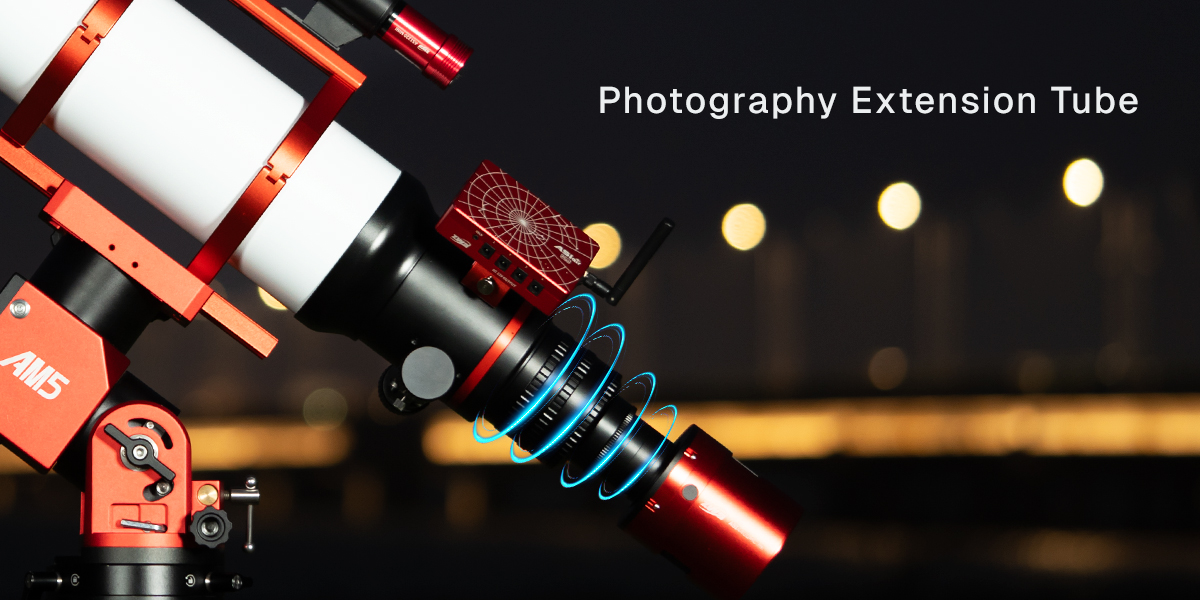

7. Photography Extension Tube
The FF110 APO includes a photography extension tube with a 2-inch filter thread, along with rear adapters in M48×0.75 and M54×0.75 standards.
This allows for easy integration with a wide range of imaging accessories.

Optical Layout
Star Field Map

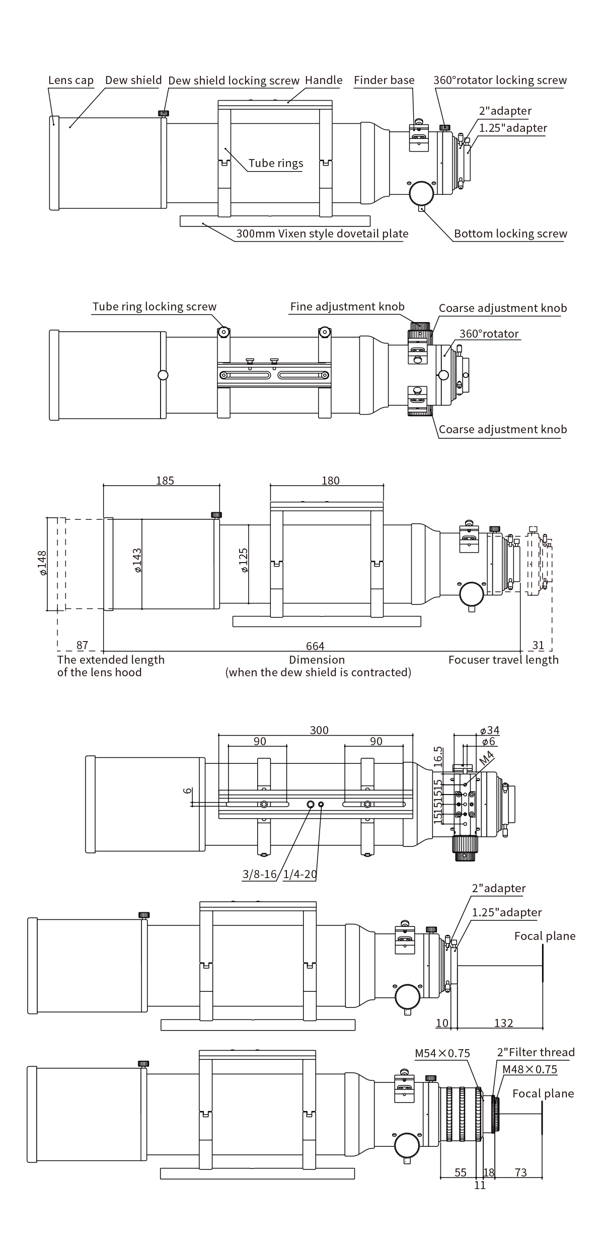

Product Diagram

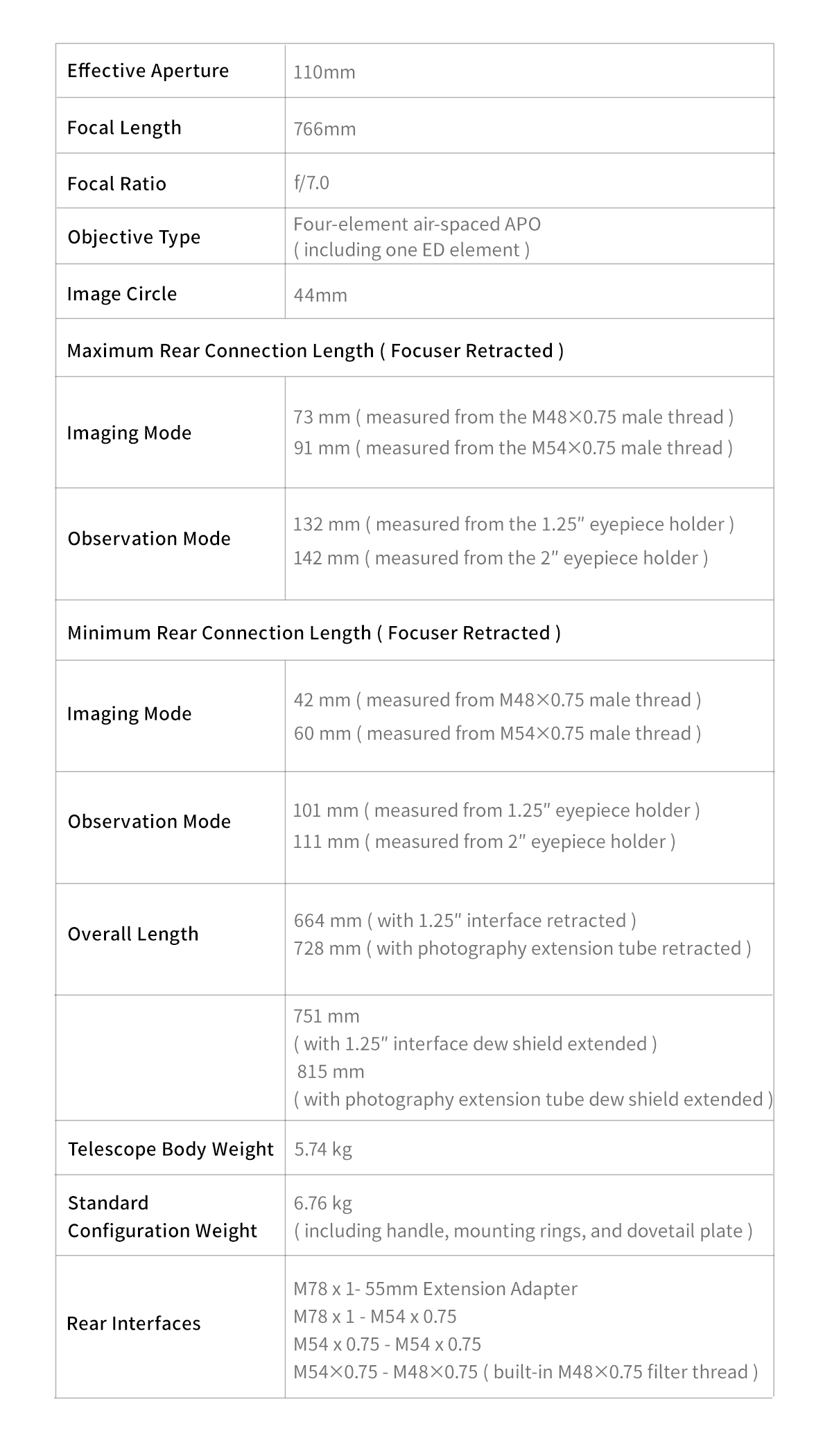

Specifications
Product NameFF110 APO
Effective Aperture110mm
Focal Length766mm
Focal Ratiof/7.0
Objective TypeFour-element air-spaced APO(including one ED element)
Image Circle44mm
Maximum Rear Connection Length (Focuser Retracted)
Imaging Mode73 mm (measured from the M48×0.75 male thread)
91 mm (measured from the M54×0.75 male thread)
Observation Mode132 mm (measured from the 1.25″ eyepiece holder)
142 mm (measured from the 2″ eyepiece holder)
Minimum Rear Connection Length (Focuser Retracted)
Imaging Mode42 mm (measured from M48×0.75 male thread)
60 mm (measured from M54×0.75 male thread)
Observation Mode101 mm (measured from 1.25″ eyepiece holder)
111 mm (measured from 2″ eyepiece holder)
Overall Length664 mm (with 1.25″ interface retracted)
728 mm (with photography extension tube retracted)
751 mm (with 1.25″ interface dew shield extended)
815 mm (with photography extension tube dew shield extended)
Telescope Body Weight5.74 kg
Standard Configuration Weight6.76 kg
(including handle, mounting rings, and dovetail plate)
Rear InterfacesM78 x 1- 55mm Extension Adapter
M78 x 1 – M54 x 0.75
M54 x 0.75 – M54 x 0.75
M54×0.75 – M48×0.75
( built-in M48×0.75 filter thread )

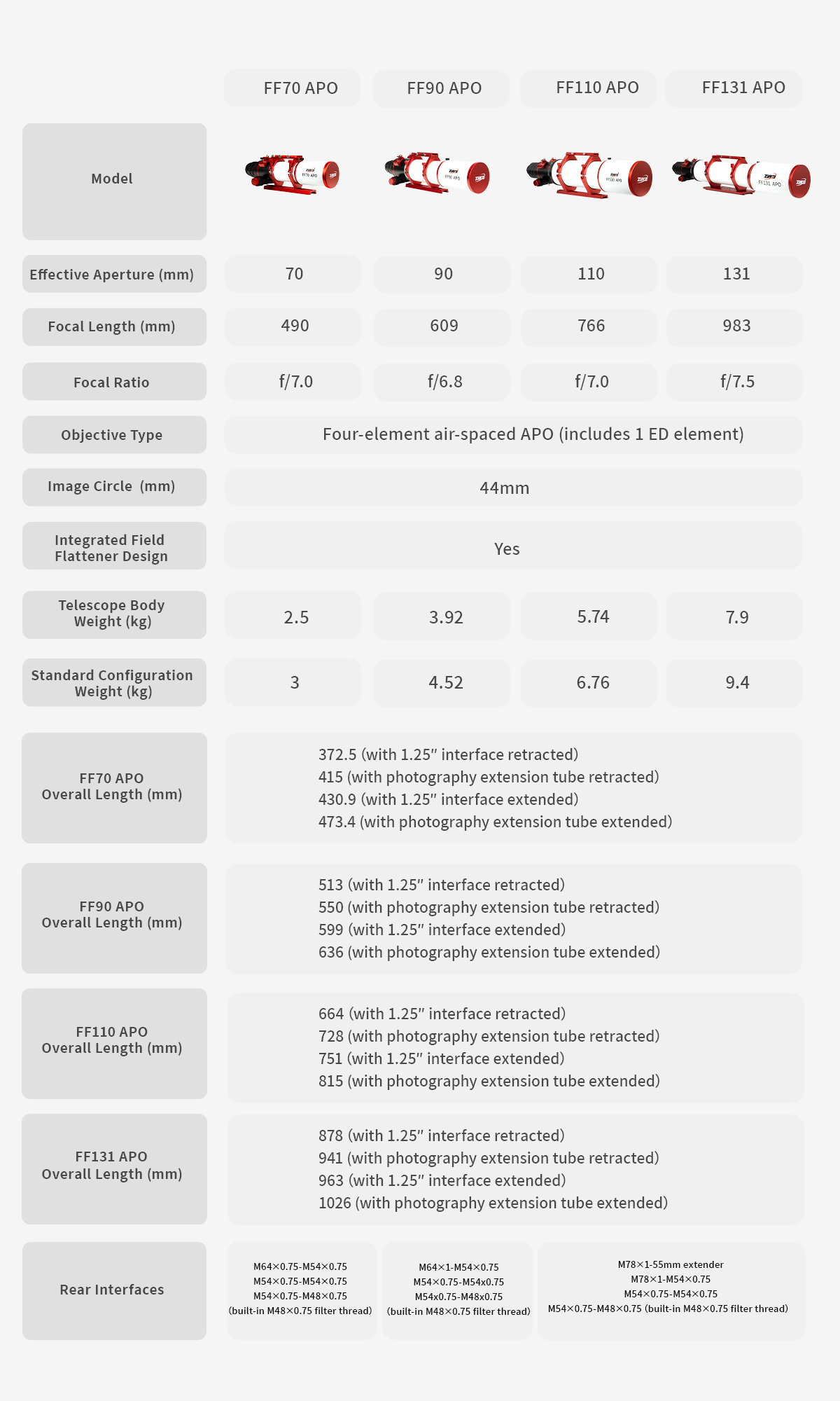

FF Series Telescope Comparison
