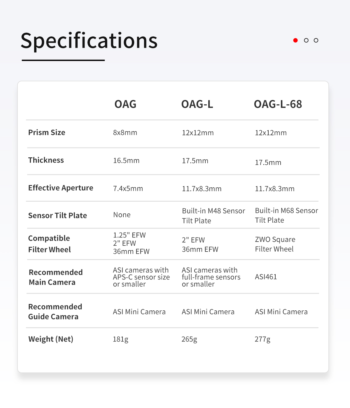

Specifications
Product NameOAGOAG-LOAG-L-68
Prism Size8×8mm12×12mm12×12mm
Thickness16.5mm17.5mm17.5mm
Effective Aperture7.4×5mm11.7×8.3mm11.7×8.3mm
Sensor Tilt PlateNoneBuilt-in M48 Sensor Tilt PlateBuilt-in M68 Sensor Tilt Plate
Compatible Filter Wheel1.25″ EFW、2″ EFW、36mm EFW2″ EFW、36mm EFWZWO Square Filter Wheel
Recommended Main CameraASI cameras with APS-C sensor size or smallerASI cameras with full-frame sensors or smallerASI461
Recommended Guide CameraASI Mini CameraASI Mini CameraASI Mini Camera
Weight (Net)181g265g277g

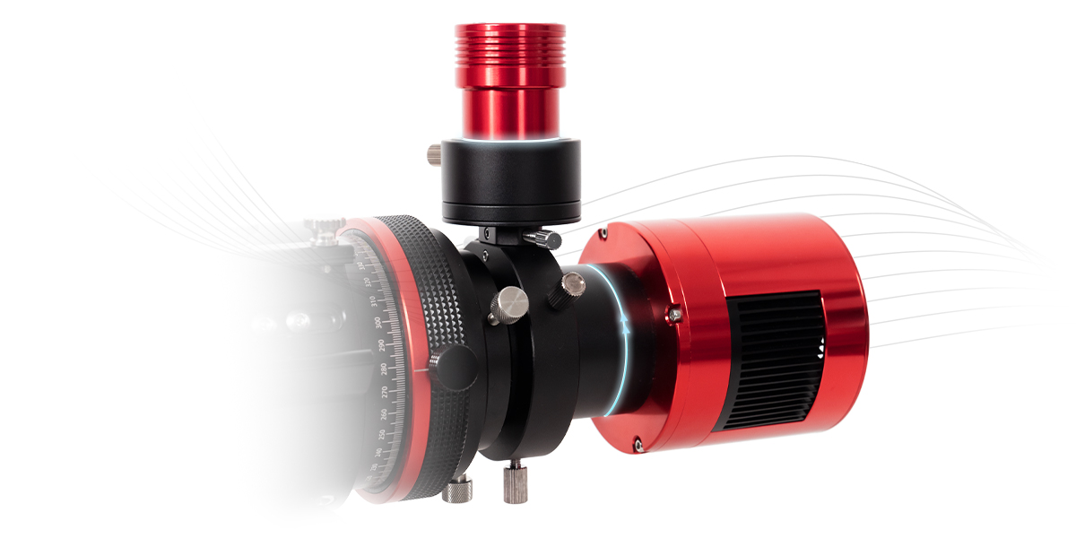

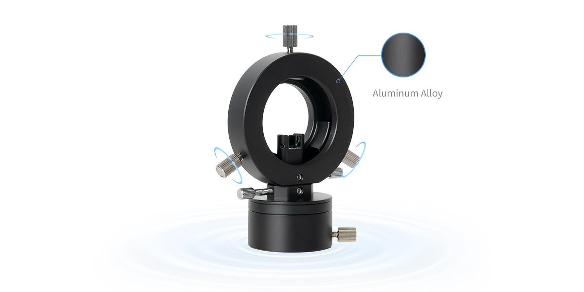

Excellent Stability
ZWO Off-Axis Guider (OAG/OAG-L/OAG-L-68)is made of aluminum alloy, lightweight and elegant with moderate thickness, and features a set screw to secure the prism column, for firm and stable connection.
High Precision

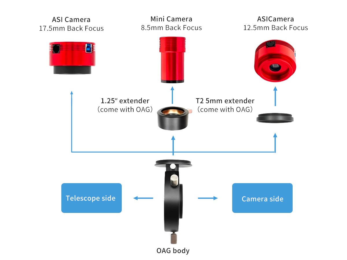

ZWO Off-Axis Guider can connect both main camera and guide camera simultaneously, eliminating the need for a separate guide scope. It uses part of the light path from the main telescope for guiding, providing higher precision.

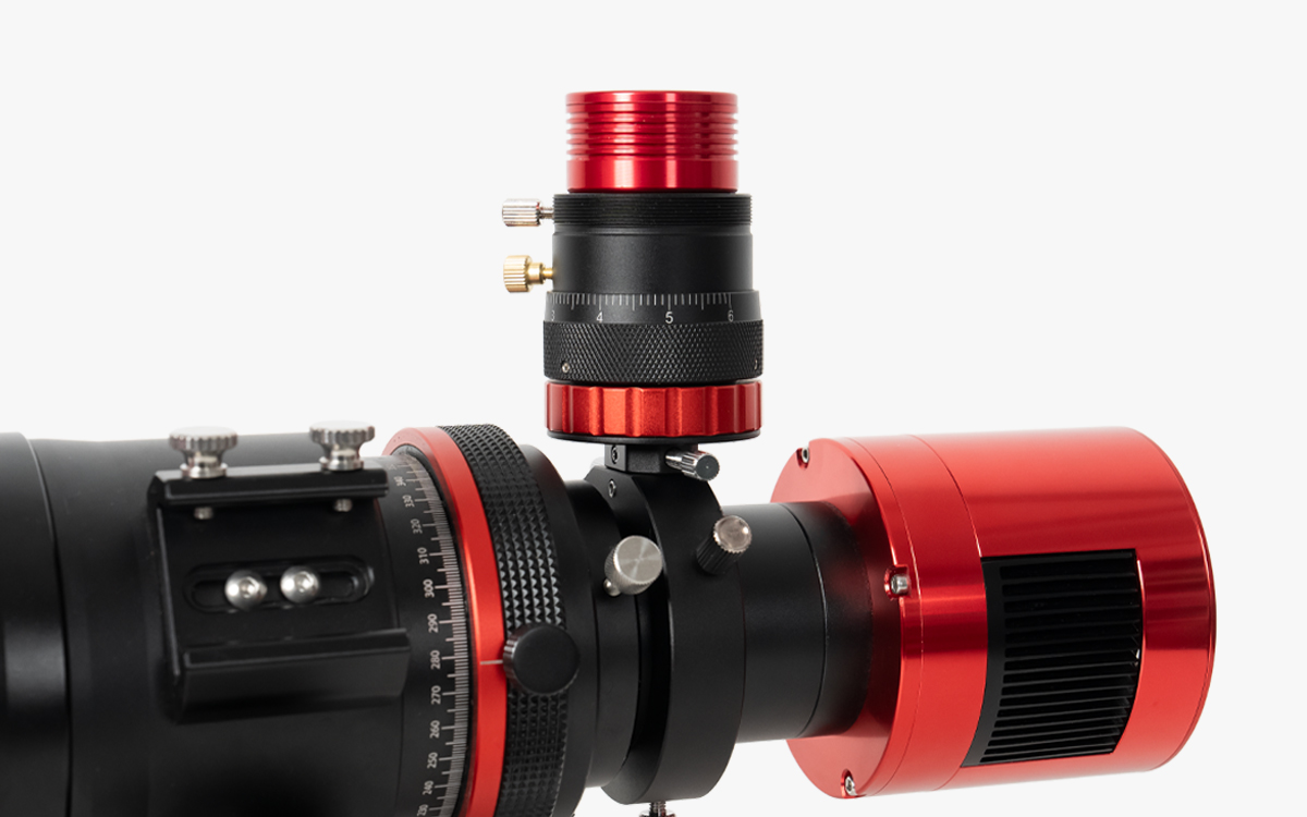

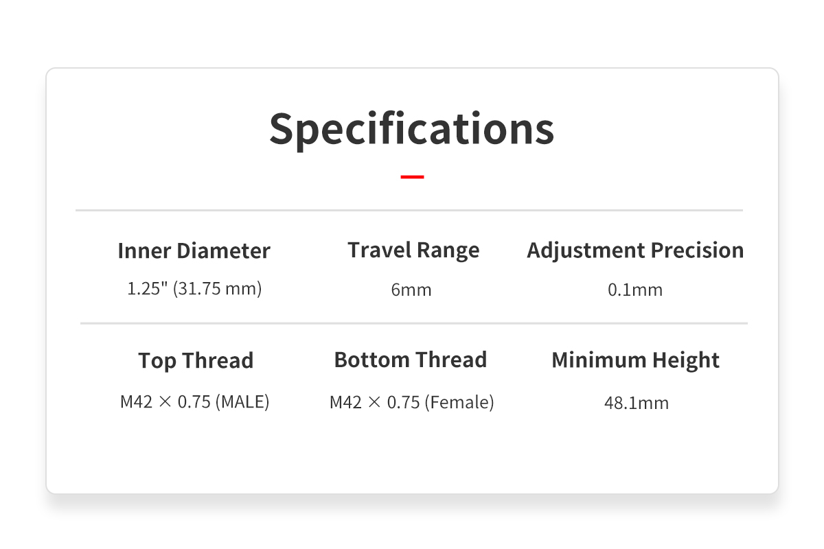

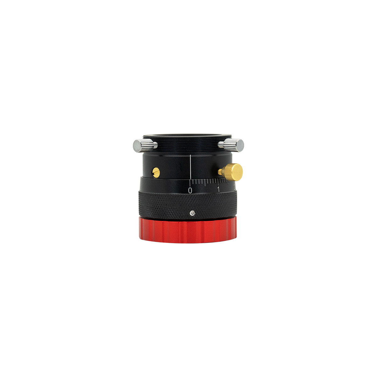

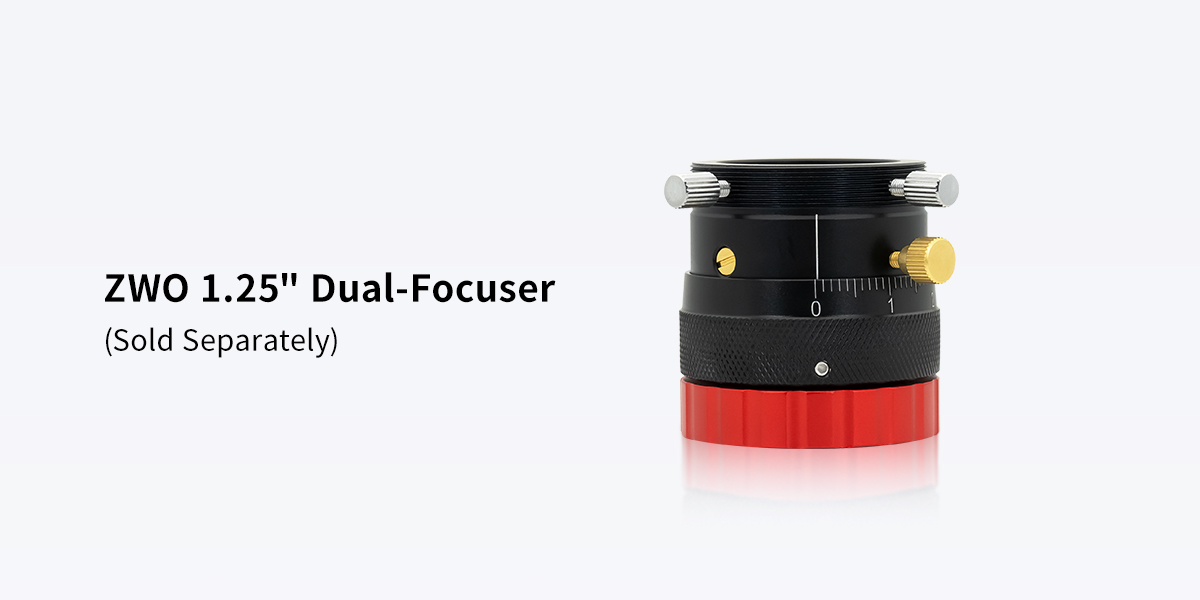

ZWO 1.25″ Dual-Focuser (Sold Separately)
When using OAG, pair with ZWO HF Dual-Focuser, for easy and precise focusing. The HF focuser is made of aviation-grade aluminum alloy, precision CNC machined, with sandblasted and anodized surface, for a non-slip and durable experience. (OAG-L and OAG-L-68 come with built-in dual-focuser, for stable guiding performance.)
Note: The ZWO HF (Helical Focuser) is designed exclusively for assisting focus adjustment when connecting ZWO mini series cameras to an OAG for guiding.

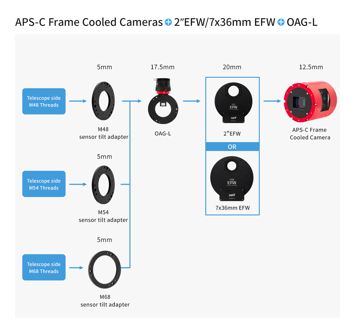

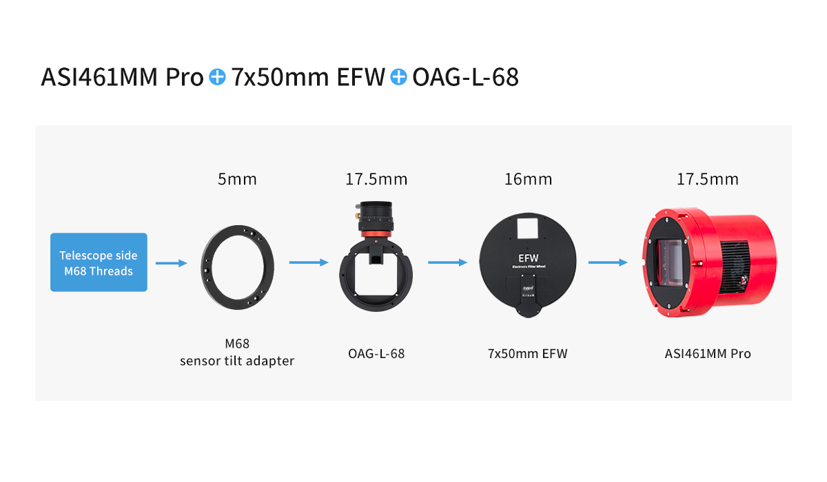

Connection Method
How to Use

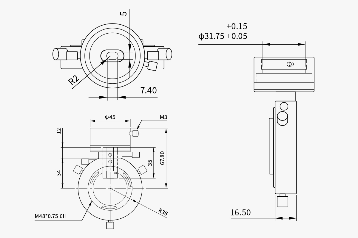

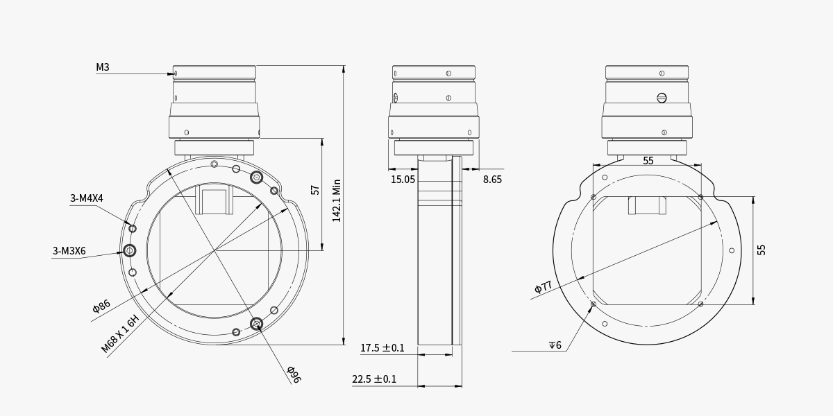

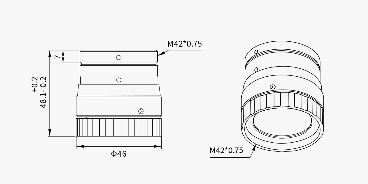

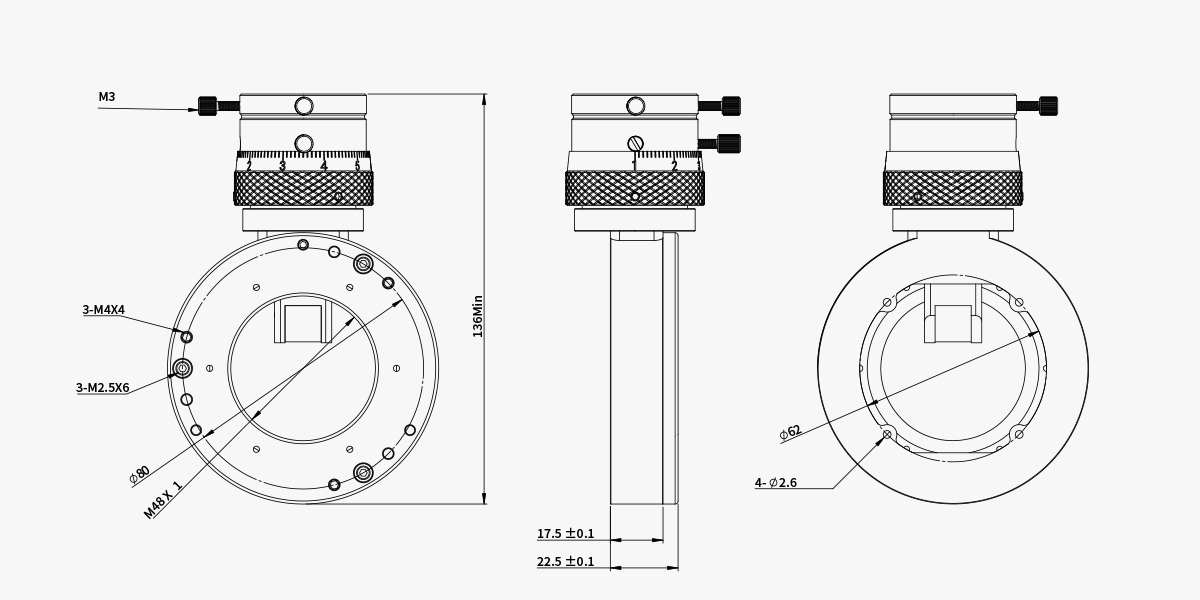

Mechanical Diagram
OAG
HF
OAG-L-68
OAG-L
