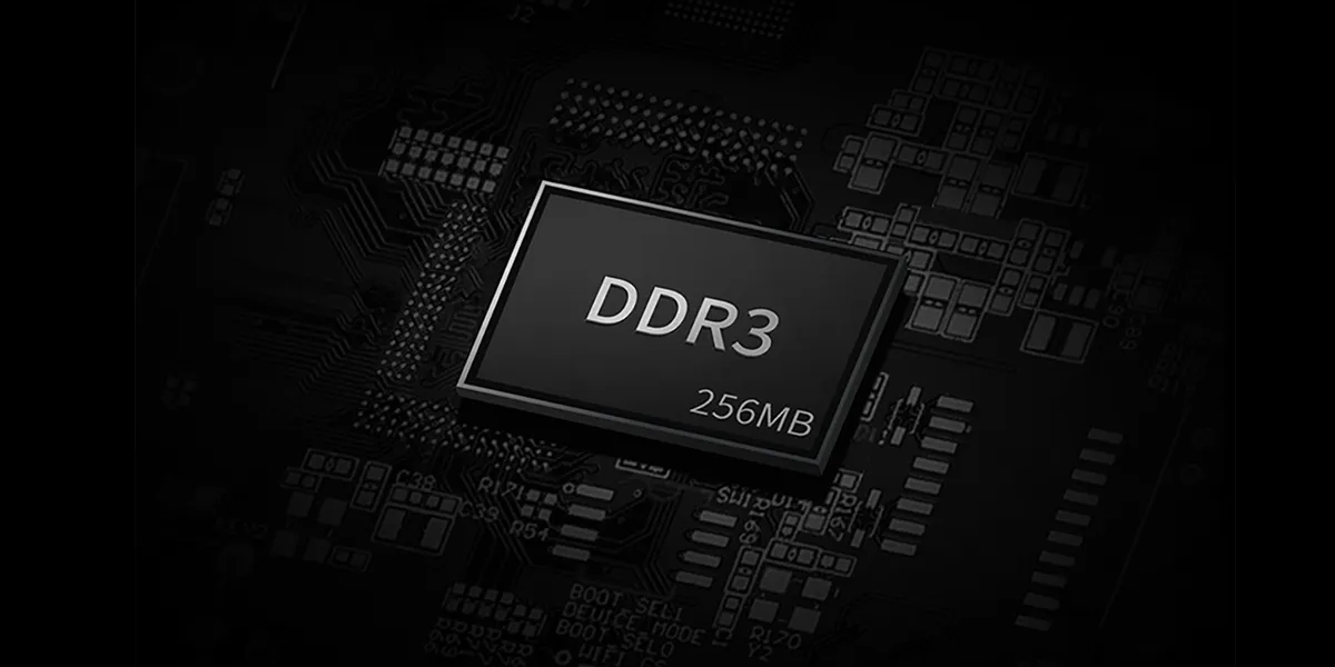

256MB DDR3
The camera is equipped with a USB 3.0 transmission interface and a built-in 256MB DDR3 cache to ensure stable and secure data transmission.

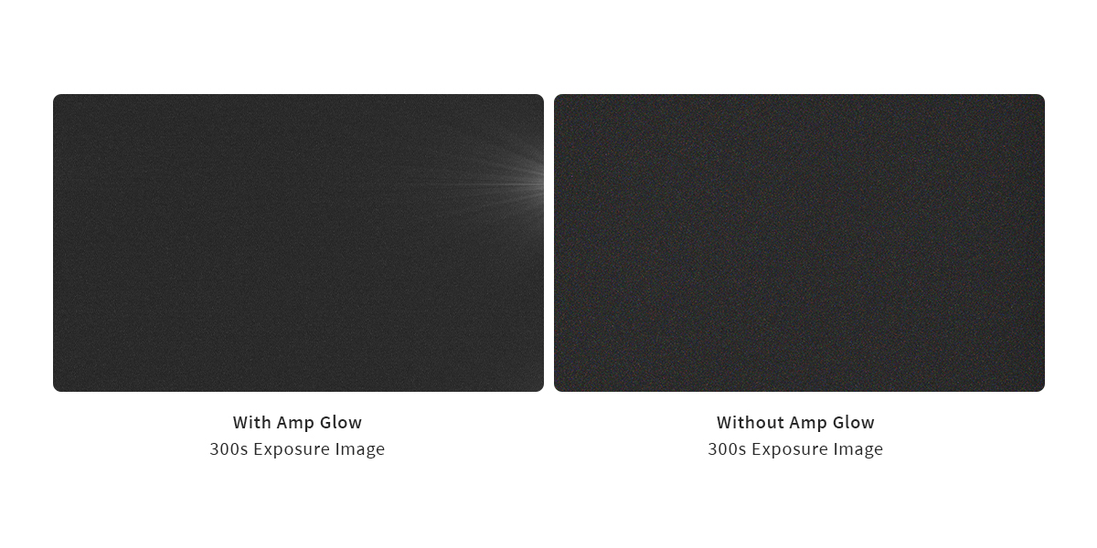

No Amp Glow
ASI676MC/MM does not have any amp glow, no matter how long the exposure and how high the gain value you set.
Note: This technology is implemented directly at the hardware level, it does not require software control.

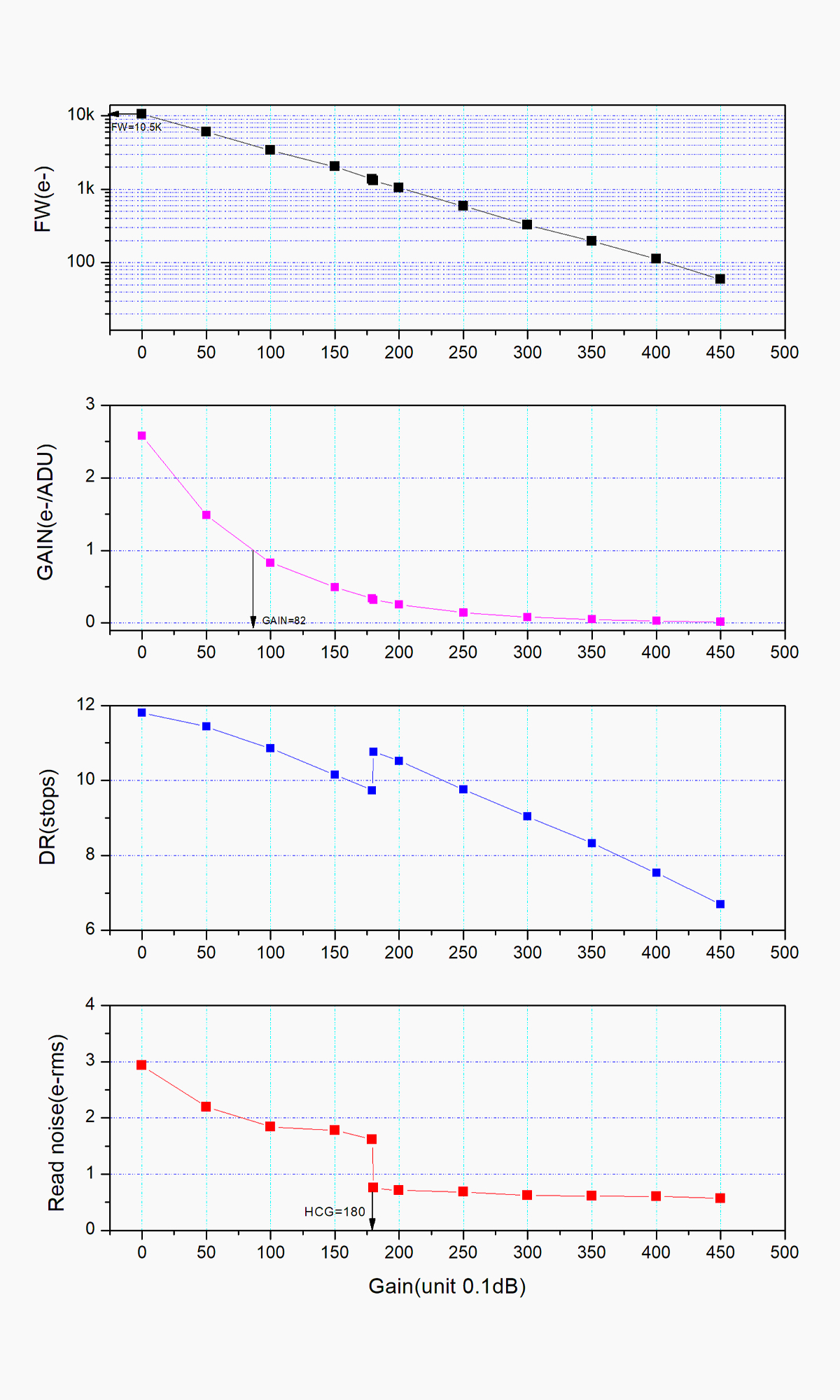

HCG Mode
The camera has a built-in HCG mode, which can effectively reduce readout noise at high gain. This allows the camera to maintain the same high dynamic range as it does at low gain. When the gain is 180, the HCG mode is automatically turned on. The readout noise is as low as 0.56e, and the dynamic range can still reach a level close to 11stops.

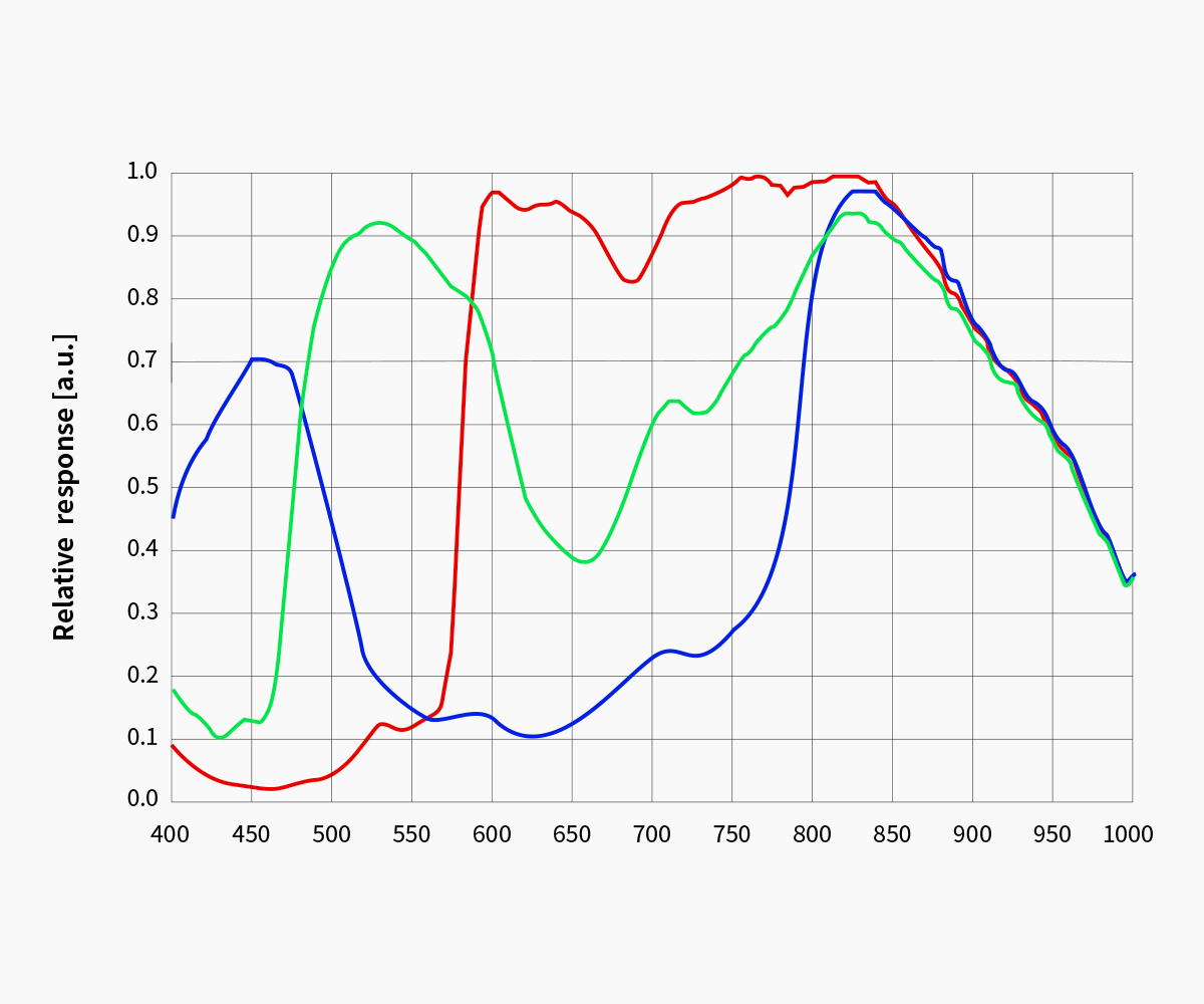

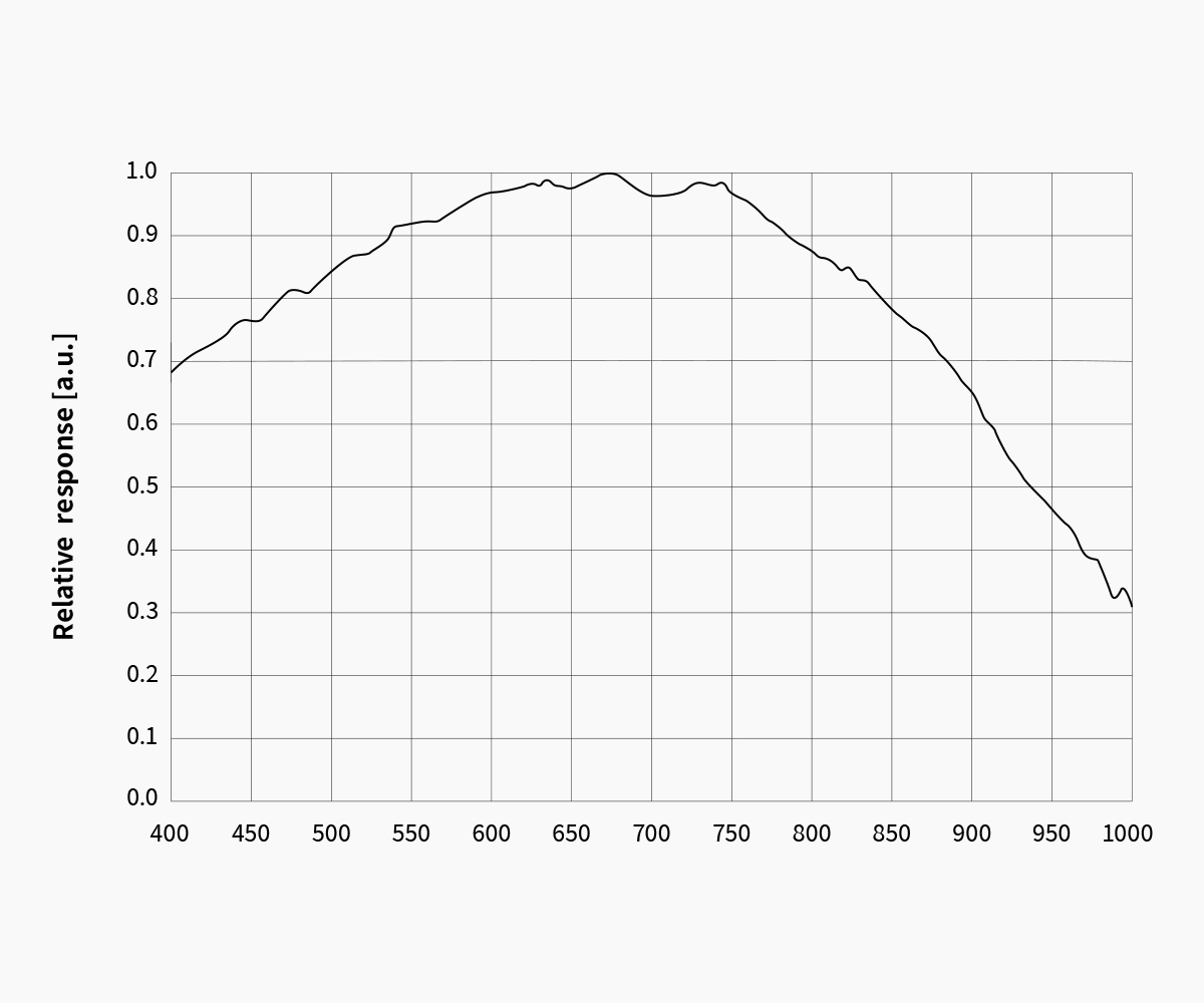

Quantum Efficiency
The QE curve and readout noise are very important parameters to measure the camera’s performance. Higher OE and lower readout noise are necessary to improve the image signal-to-noise ratio.
ASI676MC
ASI676MM

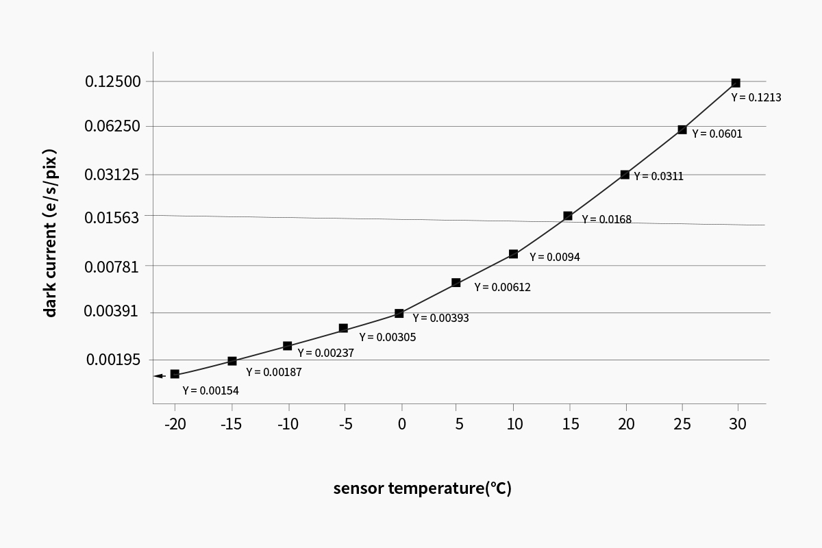

Dark Current Noise
The ASI676MC/MM’s lower dark current noise means that the image signal-to-noise ratio is also higher, especially when photographing dark objects, it produces images with better sharpness.

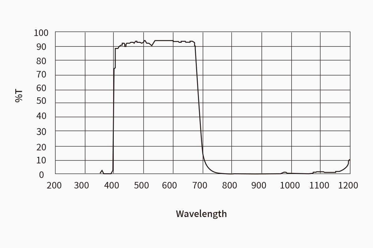

Coated Window

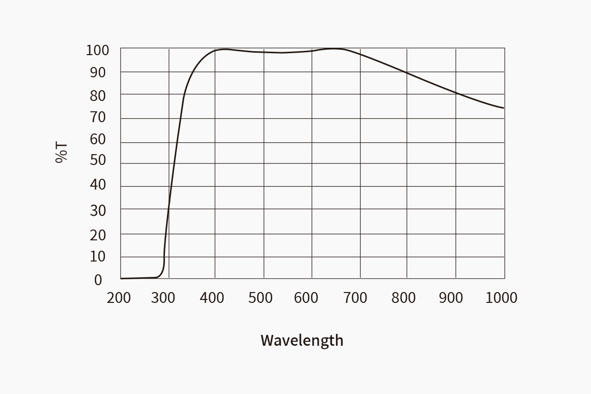

ASI676MC is equipped with an UV/IR-cut coated window in front of the sensor, with a diameter of 21mm and a thickness of 1.1mm. It effectively reduces infrared interference and improves image quality.
The ASI676MM camera features an AR-coated protective filter in front of the sensor, with a diameter of 21 mm and a thickness of 1.1 mm. It protects the sensor from external damage while enhancing light transmission from the near-ultraviolet to the near-infrared spectrum.

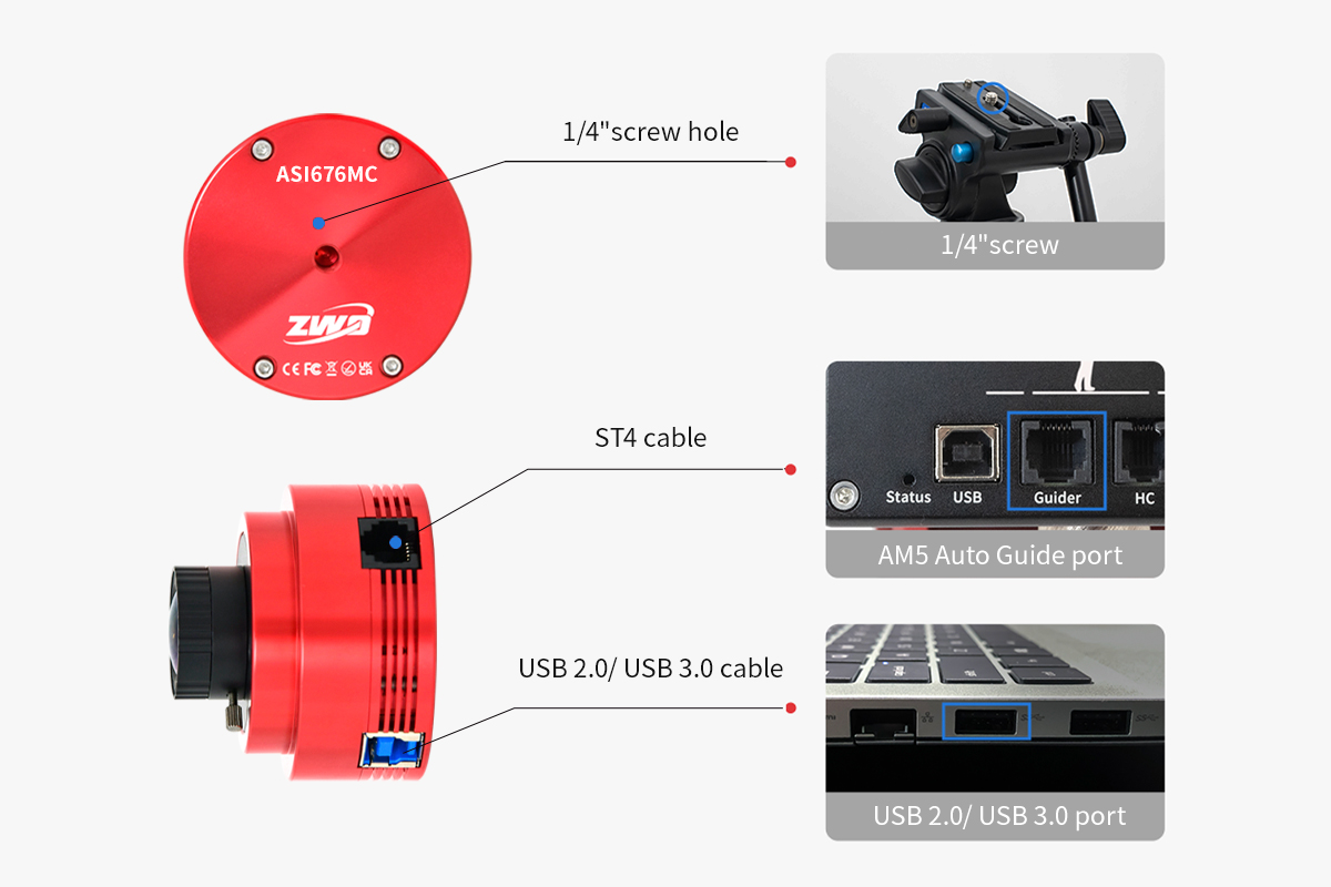

Connection to External Devices

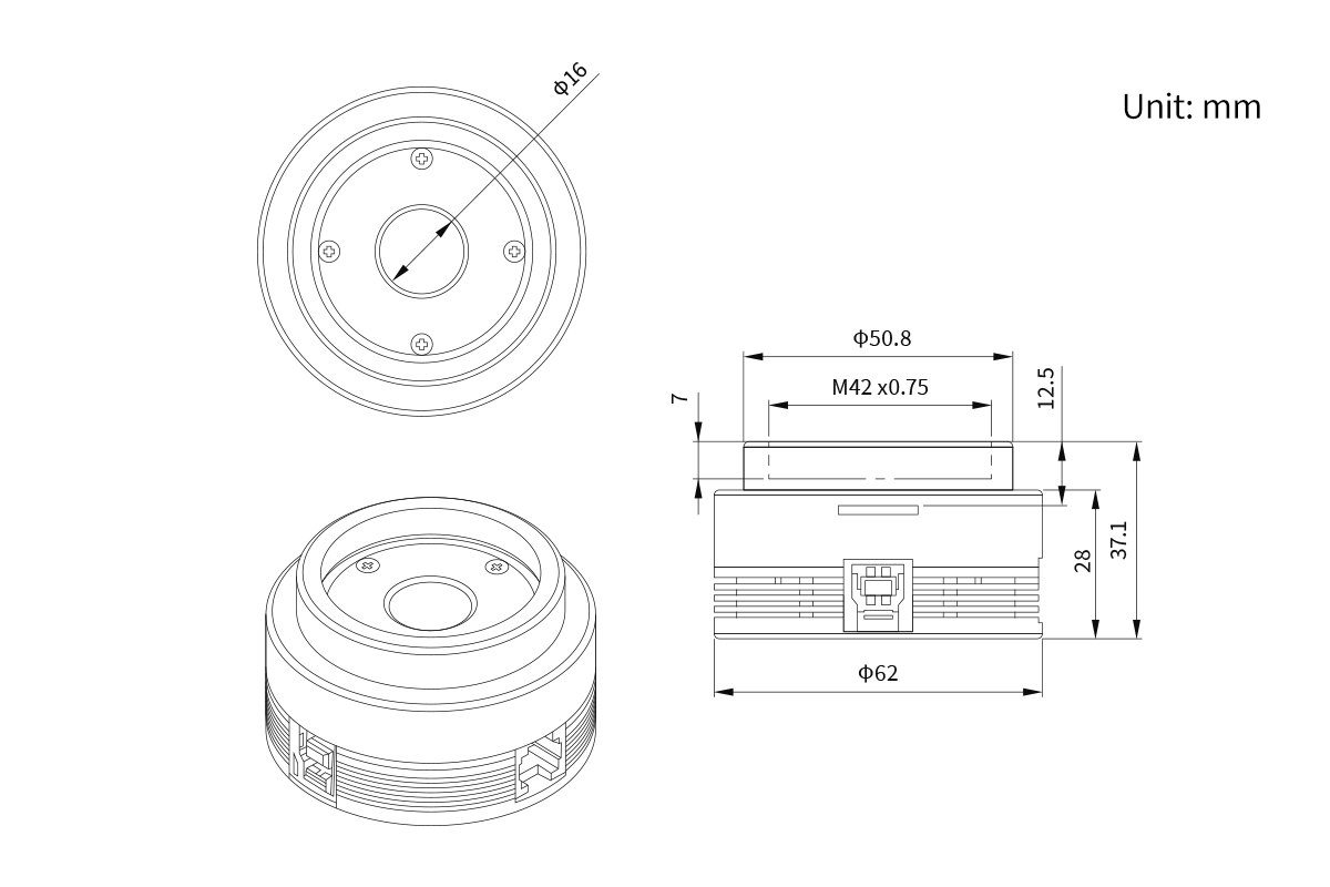

Structure Dimension Diagram

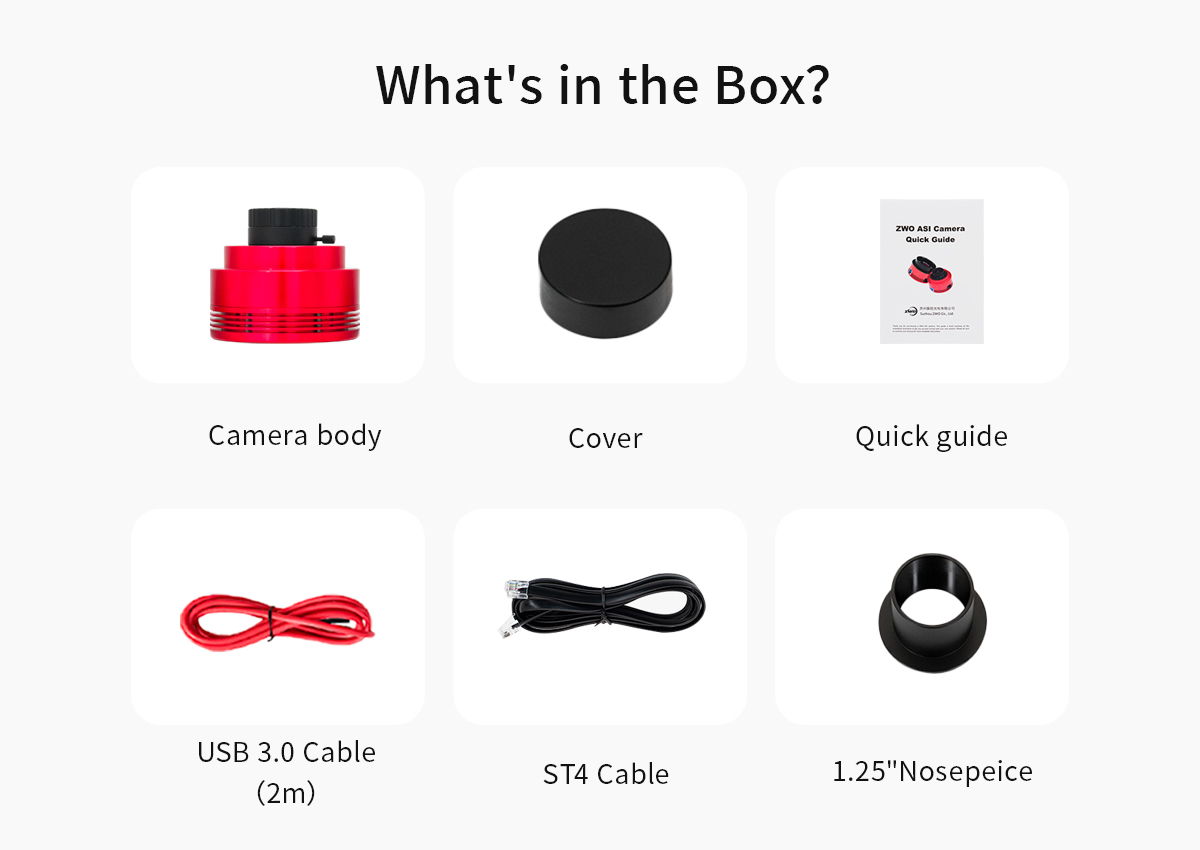

What’s in the Box?
