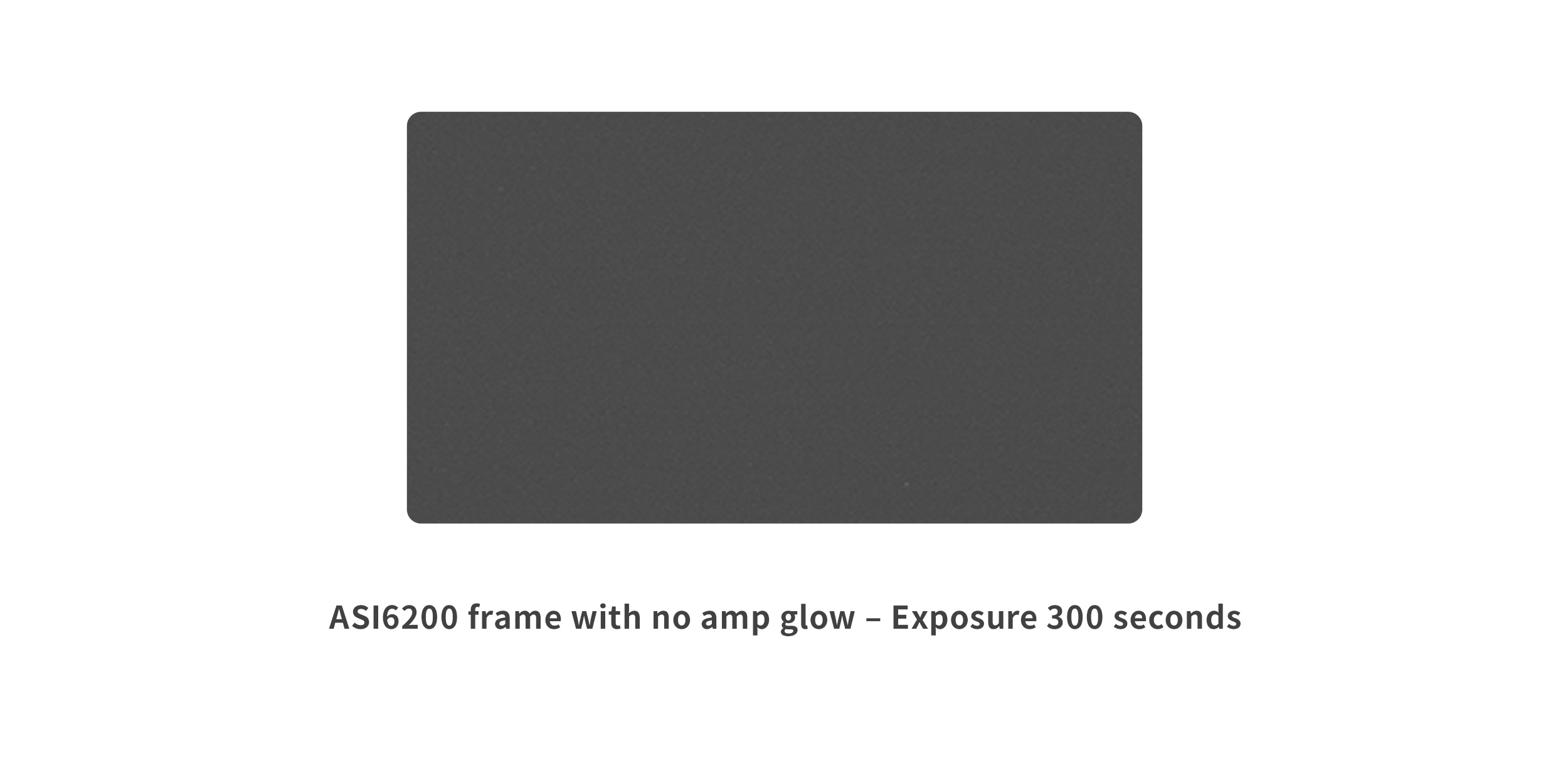

2.Zero Amp Glow – worry-free imaging even with long exposures and high gain.

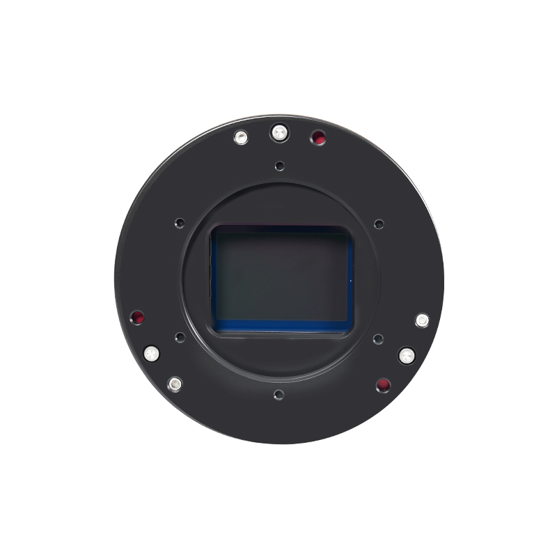

The ASI6200 Pro camera uses a full-frame format. The outstanding 9576×6388 resolution provided by the onboard Sony IMX455 sensor makes this camera a 61.2-megapixel full frame powerhouse! The sensor length and width are 36mm x 24mm respectively, and the diagonal is 43.3mm. This is a camera with a small pixel size of 3.76um that can accommodate a large well depth of 51.4ke.

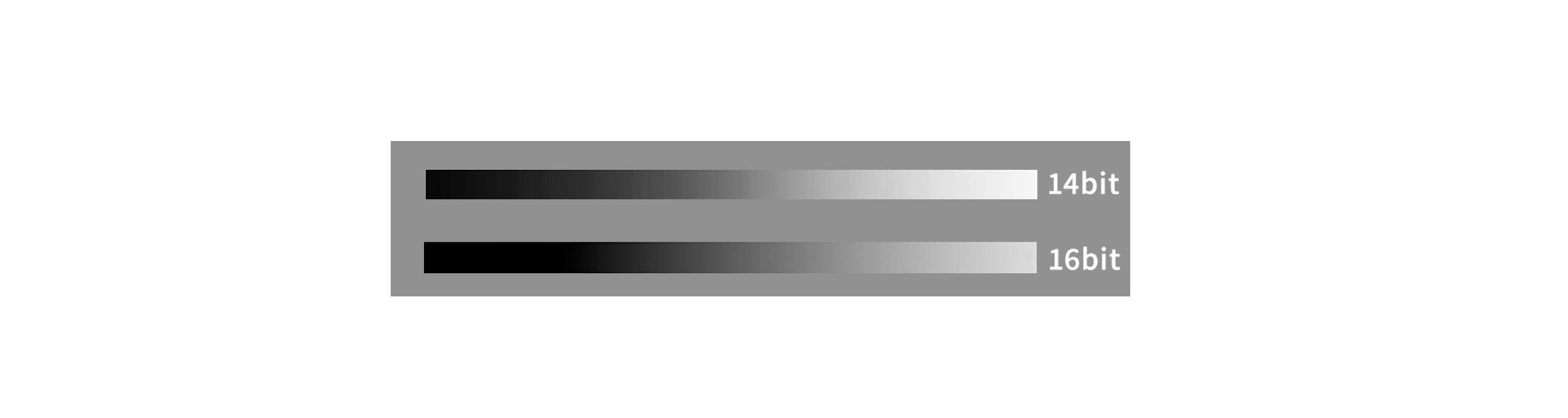

2.Native 16bit ADC
ASI6200 Pro camera is our first batch of CMOS astronomy cameras with true 16-bit ADC. It is not a CCD-style 16-bit ADC – it really can achieve a dynamic range output of 14 stops. This significantly improves the image sharpness and contrast, and the contrast gradients are smoother and more natural-looking.

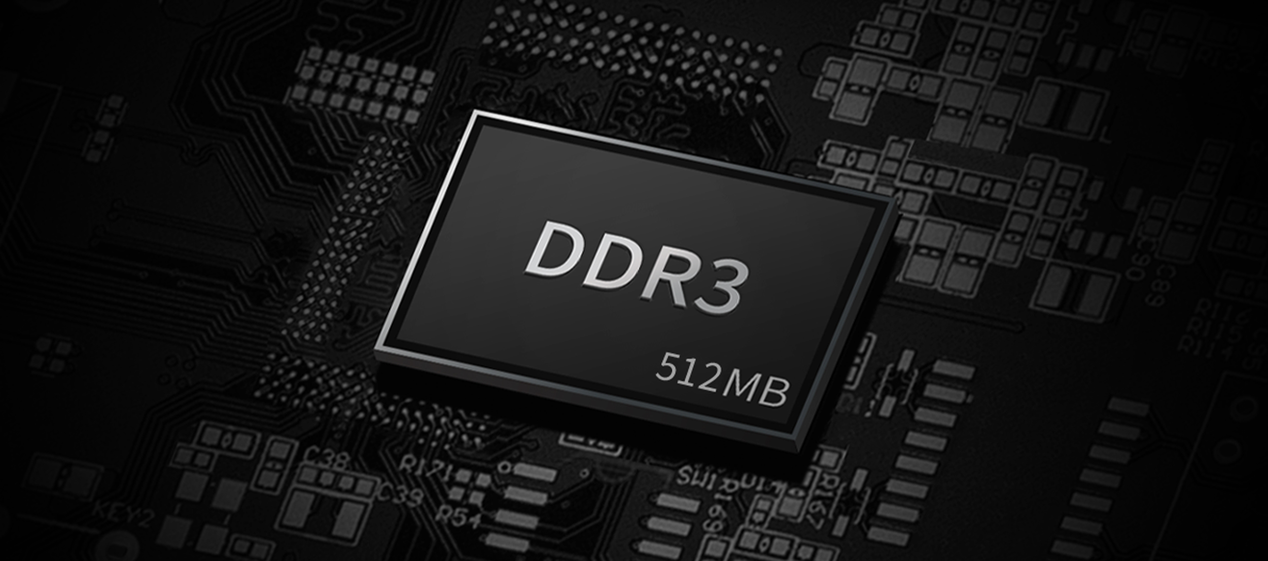

1.USB3.0 & 512M DDR3 Memory
The ASI6200 Pro camera is equipped with a USB 3.0 transmission interface and a built-in 512MB DDR3 cache to ensure stable and secure data transmission.
*ASI Cooled Cameras produced after August 2023 have changed their DDR3 buffer from 256MB to 512MB.

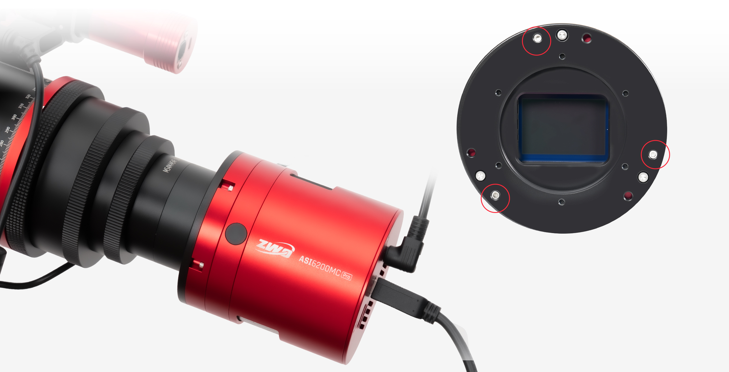

2.Three sets of screws
The sensor is adjusted by three sets of screws, enabling precise calibration. (Each set consists of a push-pull screw pair.)

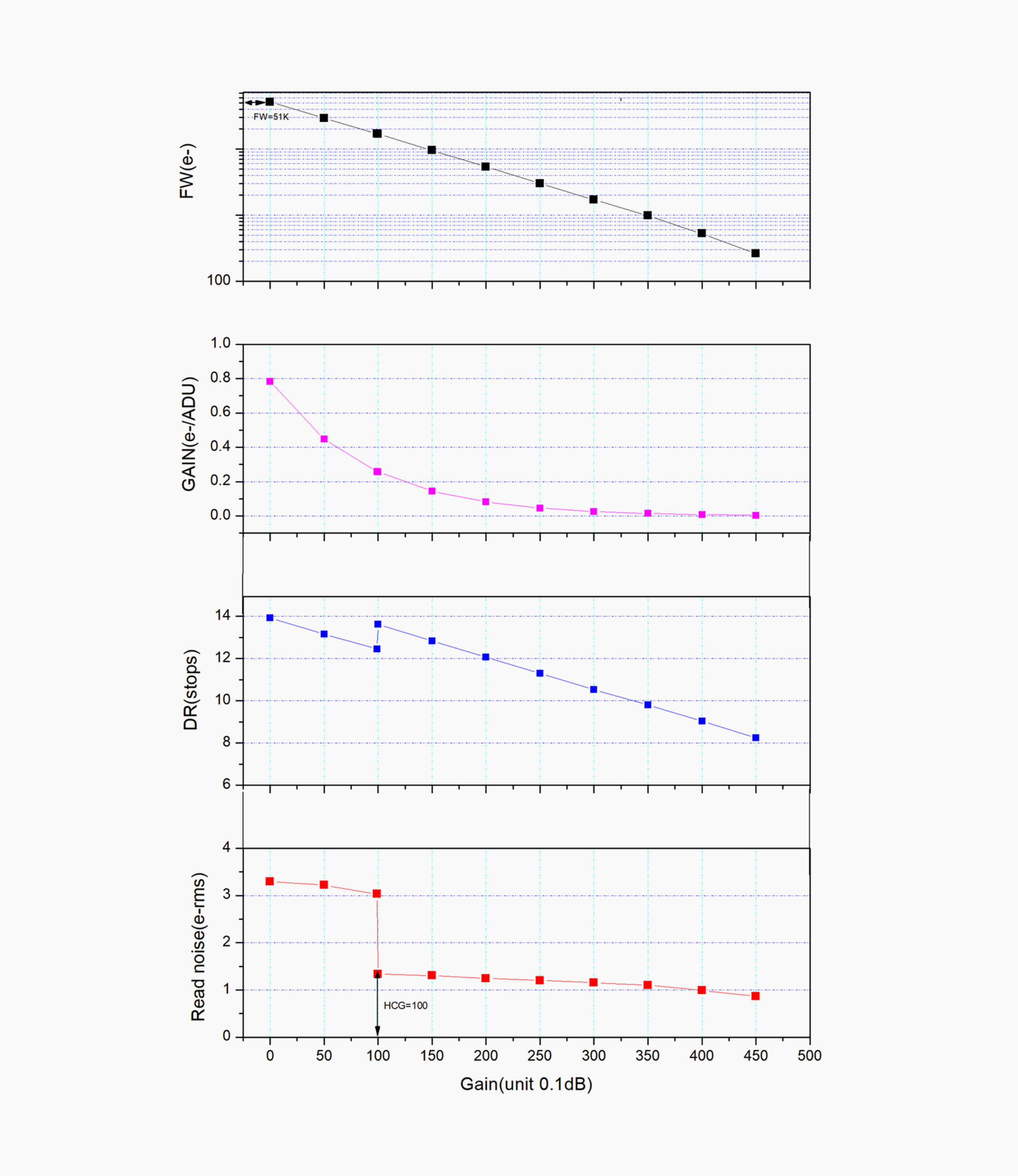

Camera Performance: Low readout noise, high dynamic range
The ASI6200MM/MC Pro camera has excellent performance with a dynamic range of up to 14 stops that will greatly reduce the issue of overexposed images, and make colour gradients look smoother and more natural-looking.
The innovative design of the ASI6200MM Pro also includes high conversion gain mode (HCG) that automatically kicks in at a gain setting of 100, reducing the amount of read noise while simultaneously preserving the dynamic range during high gain imaging.

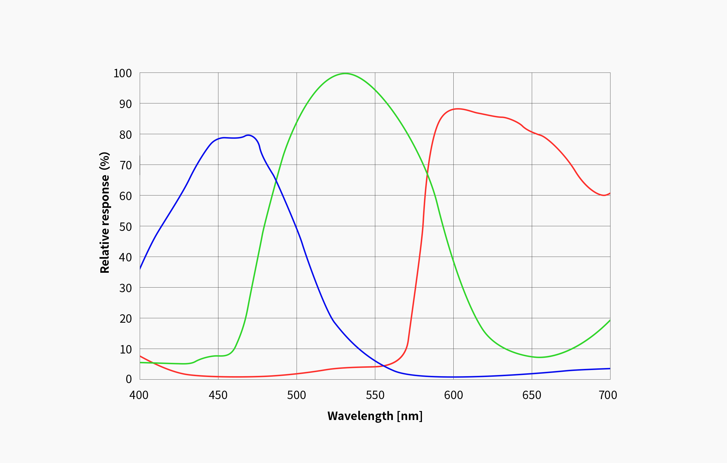

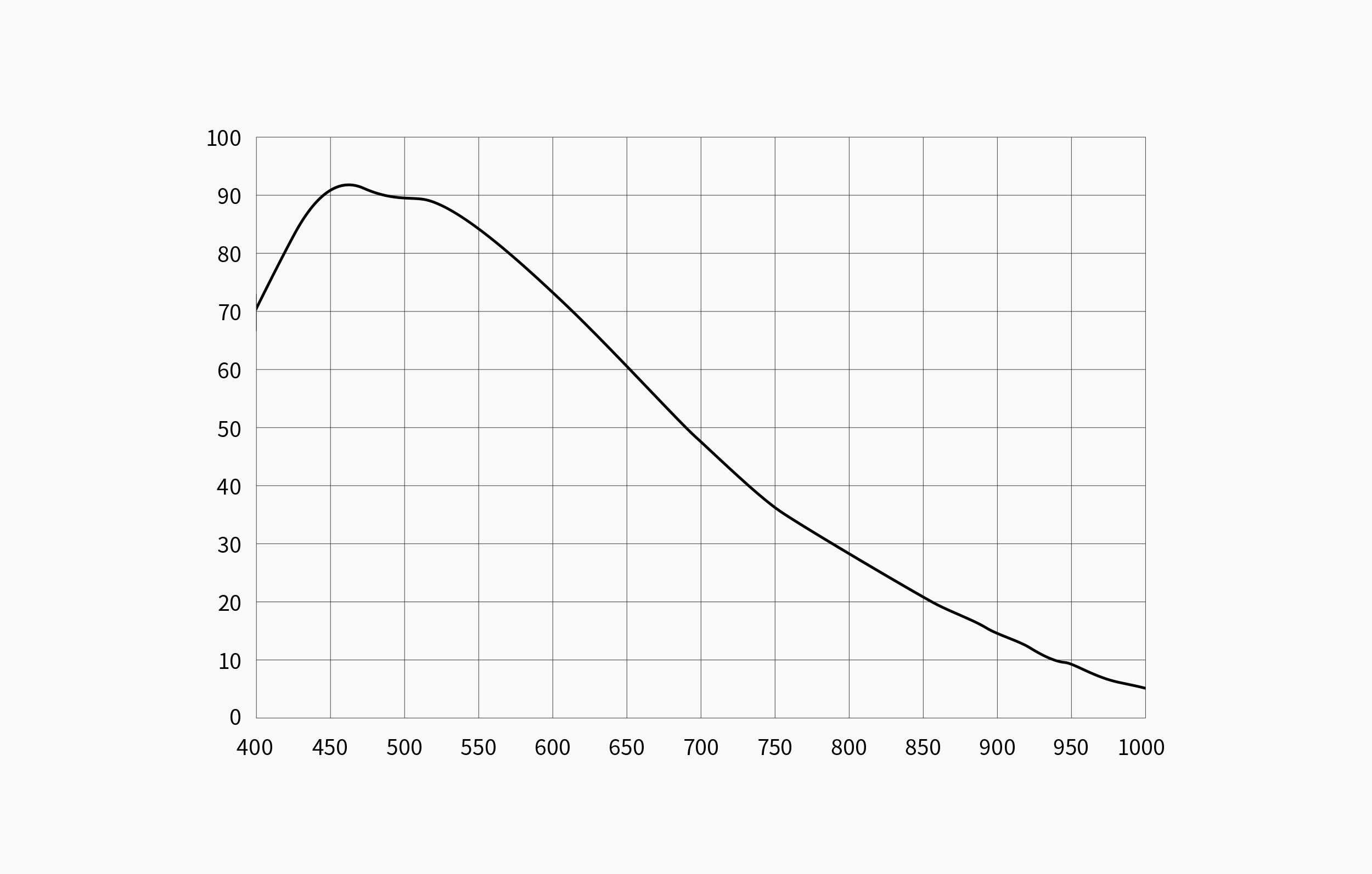

QE value
The QE peak value of the ASI6200MC Pro camera is 80%.
The QE peak value of the ASI6200MM Pro camera is 91%.

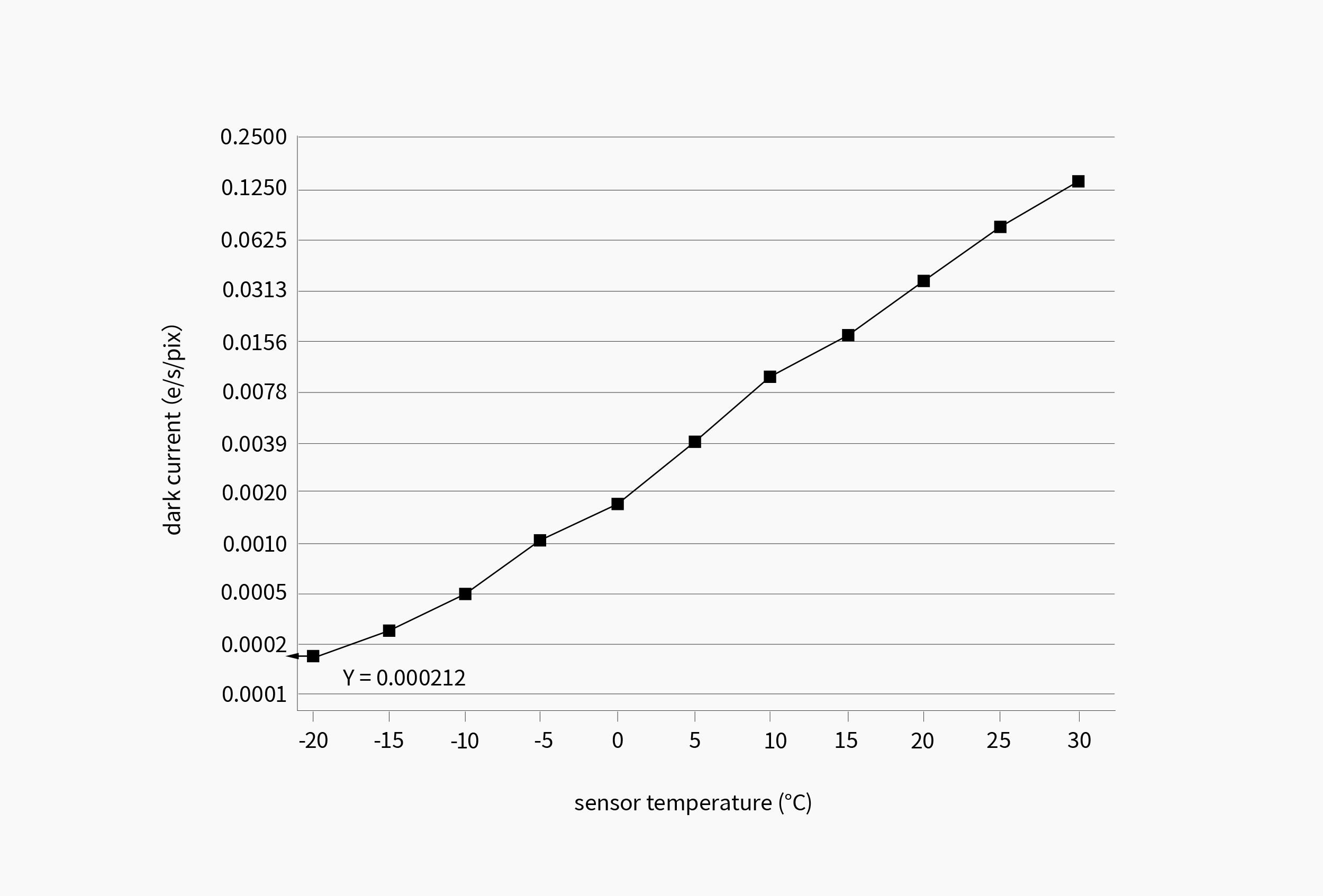

ultra-low dark current
The unique dark current suppression technology can further reduce dark current noise. At a cooling temperature of 0°C, the dark current noise is only 0.0017e/s/pix. This means a 300s exposure will only cause a dark current noise of 0.51 e/pix, which is completely negligible!

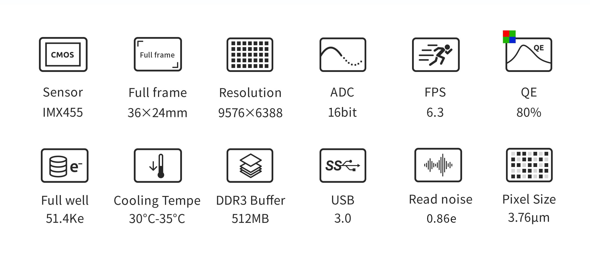

| Product Name | ASI6200MM P25 | ASI6200MC P25 |
| Sensor | IMX455 CMOS | IMX455 CMOS |
| Full frame | 36×24mm | 36×24mm |
| Resolution | 9576×6388 | 9576×6388 |
| ADC | 16bit | 16bit |
| FPS | 6.3 | 6.3 |
| QE | 91% | 80% |
| Full well | 51.4Ke | 51.4Ke |
| Cooling Temperature | 30℃–35℃ | 30℃–35℃ |
| Buffer | 512MB DDR3 | 512MB DDR3 |
| Interface | USB 3.0 | USB 3.0 |
| Read noise | 0.86e | 0.86e |
| Pixel Size | 3.76μm | 3.76μm |

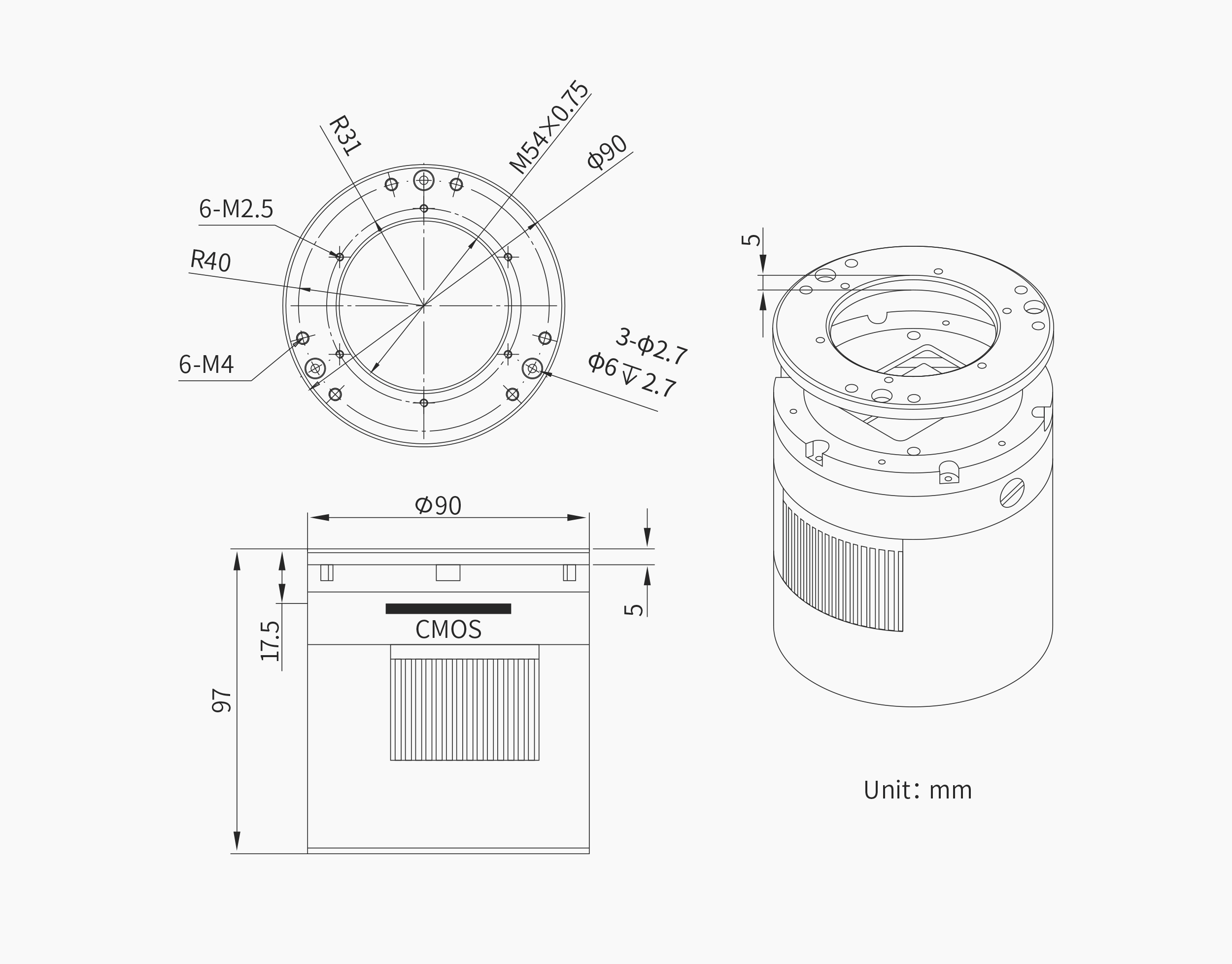

Mechanical Diagram

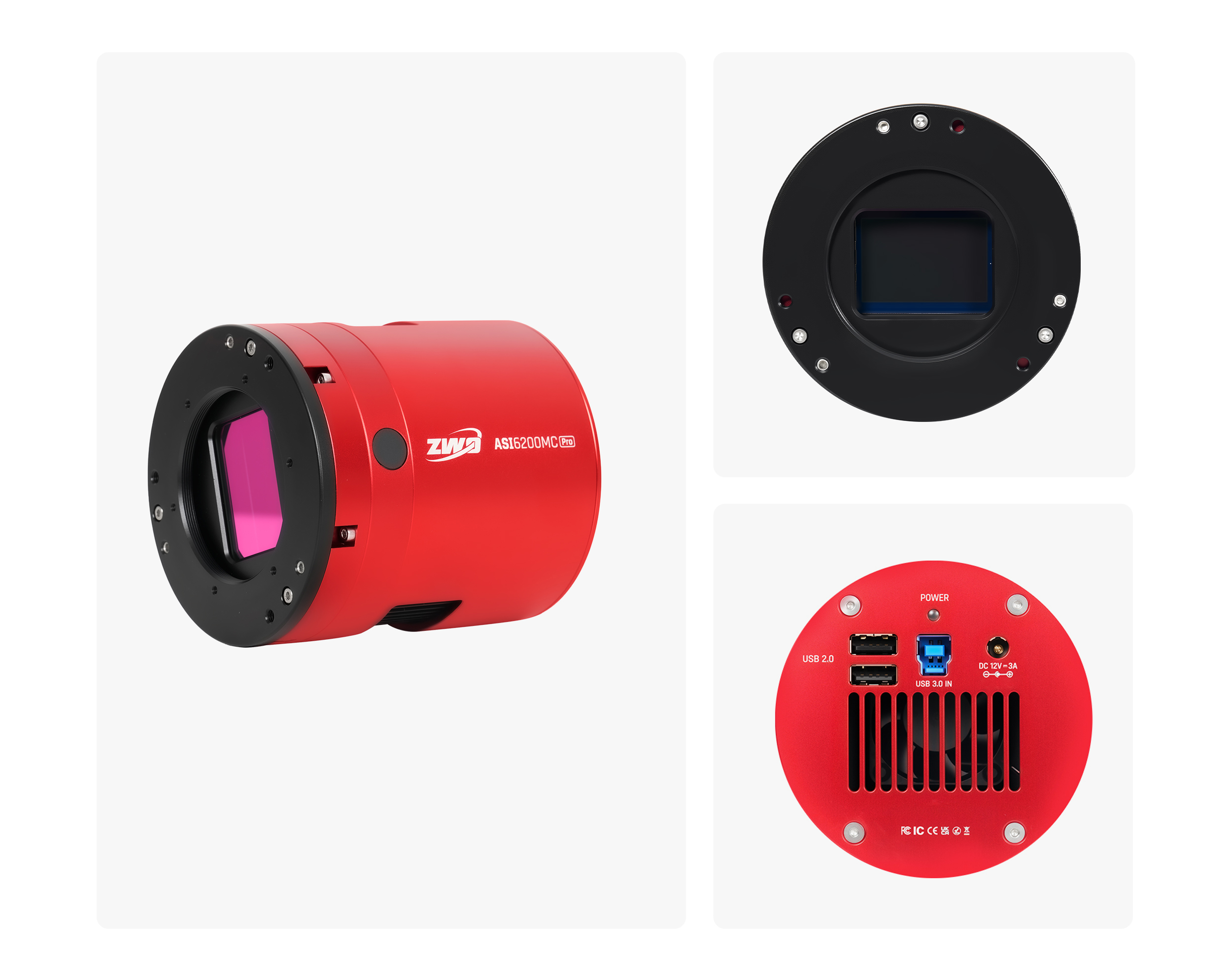

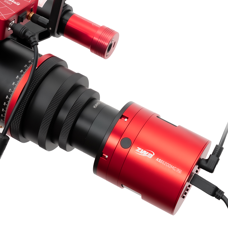

The standard package includes one long USB cable and two short USB cables, making it convenient for different usage scenarios—for example, using the long cable for computer-based guiding, and the short cables for guiding with ASIAIR or connecting to the EAF.
