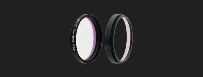

Compatibility
Engineered for full compatibility with all ZWO filters for dependable image quality.
