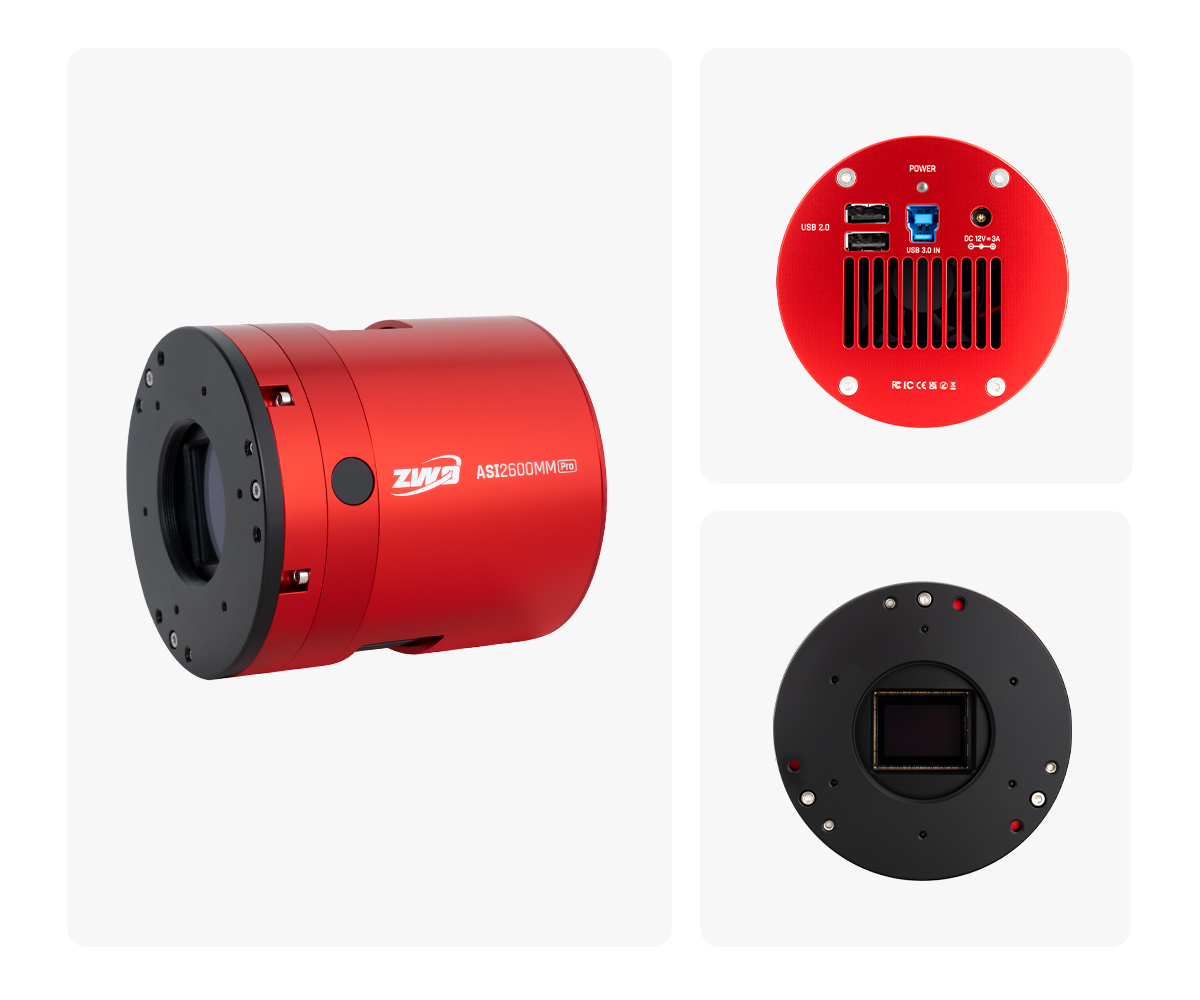

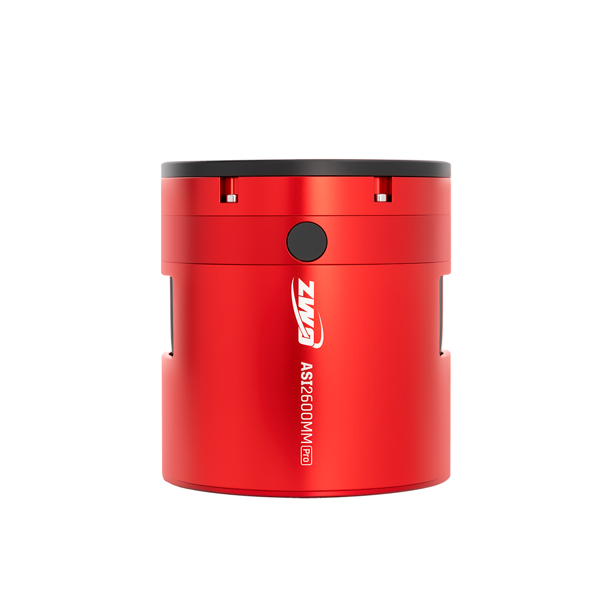

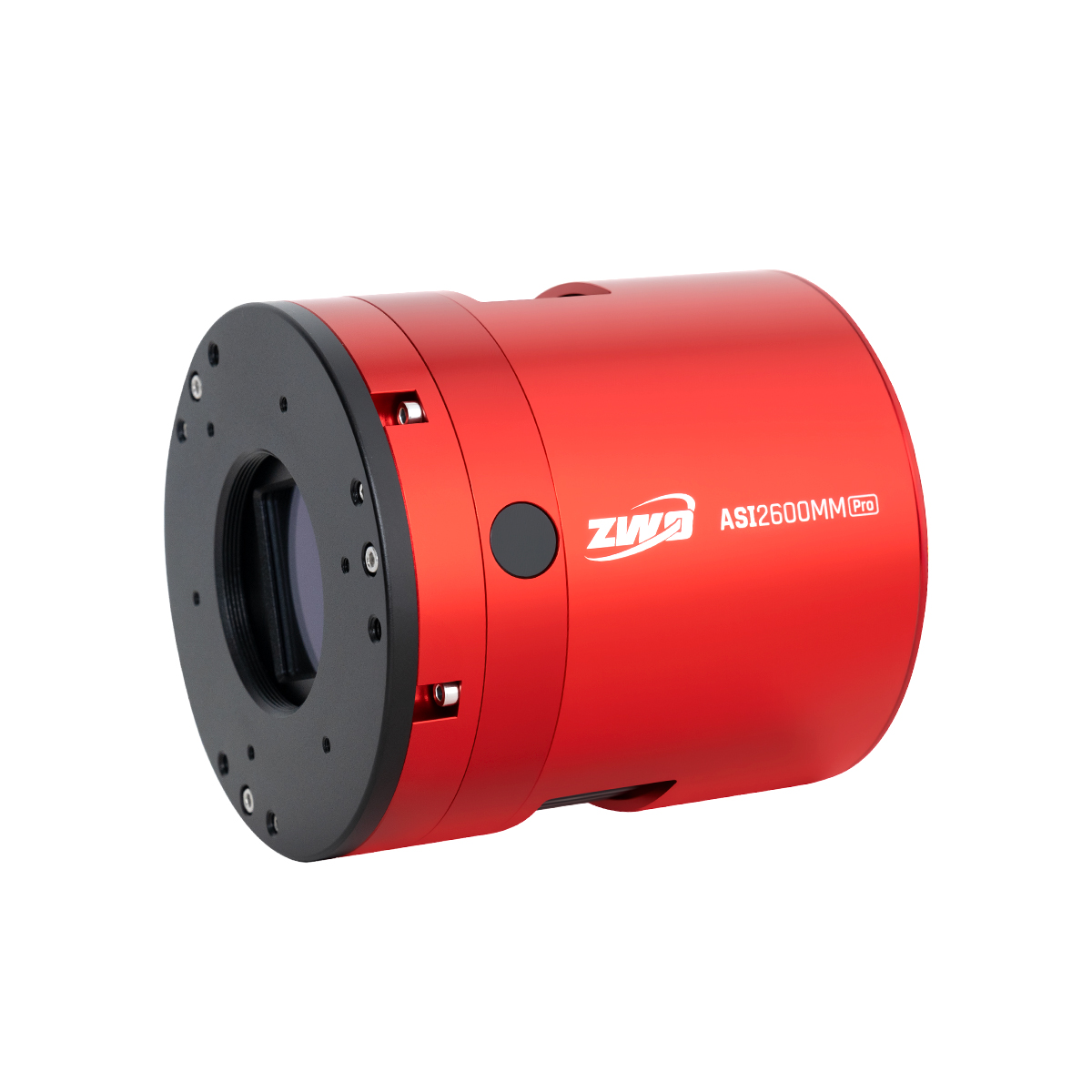

Refined Design
The body weighs just 0.7 kg(1.54 lbs), yet delivers outstanding image performance.

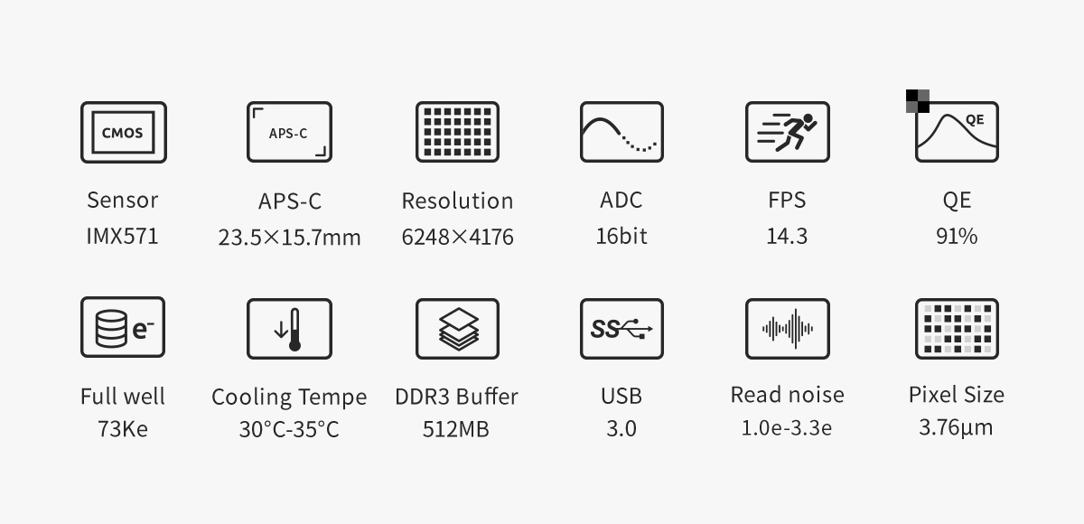

APS-C Sony IMX571 Sensor
The ASI2600MM/MC Pro is equipped with the APS-C format Sony IMX571 sensor, measuring 23.5mm × 15.7mm with a 28.3mm diagonal. It delivers an outstanding resolution of 6248 × 4176 pixels, making it a true 26-megapixel powerhouse. Each 3.76 μm pixel offers an impressive full-well capacity of 73ke⁻, ensuring exceptional dynamic range and image quality.

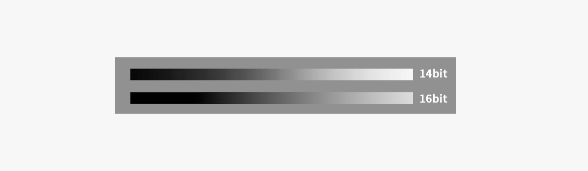

Native 16bit ADC
The advanced CMOS architecture of the ASI2600 enables a true 14-stop dynamic range. This ensures exceptionally smooth tonal transitions, richer color gradients, and the ability to capture both the faintest details and the brightest highlights within a single frame.

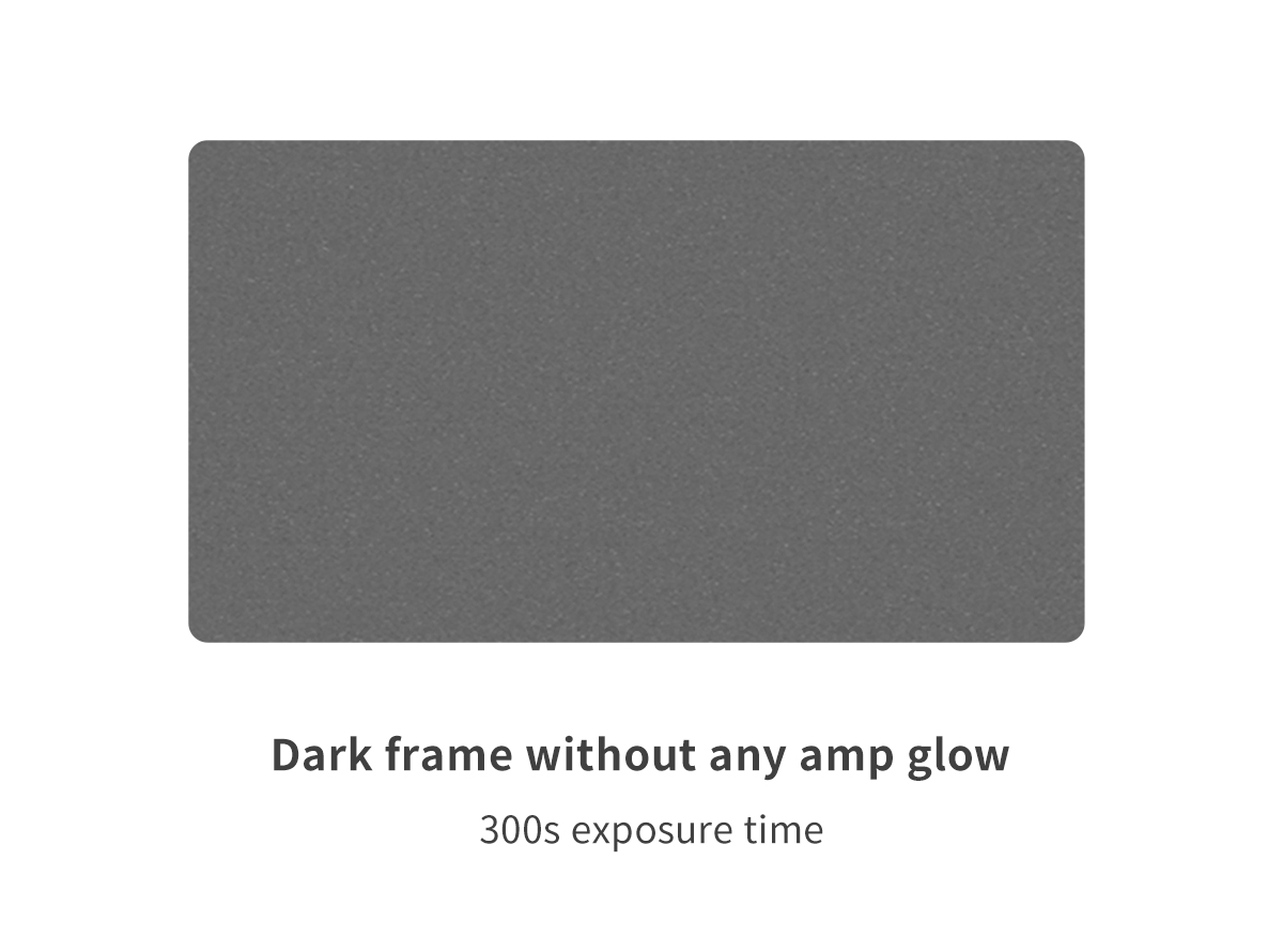

Zero Amp Glow
As the ASI2600MM/MC Pro uses zero amp glow circuitry, you won’t have to worry about amp glow even when using high gain, long exposure imaging.

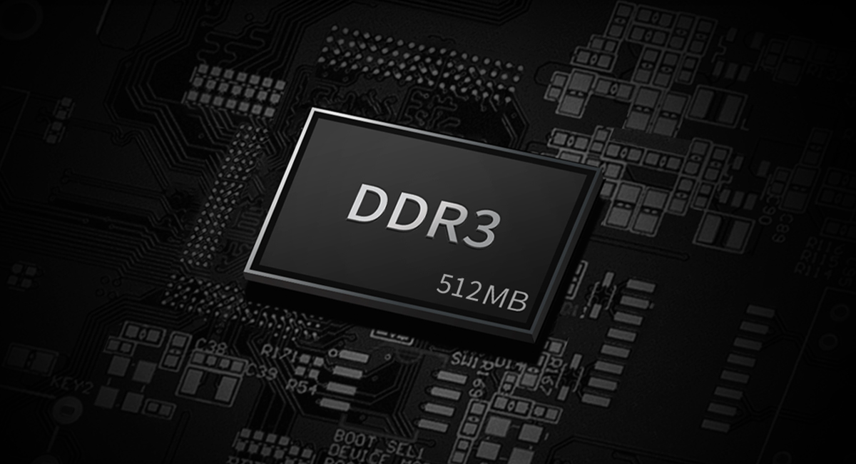

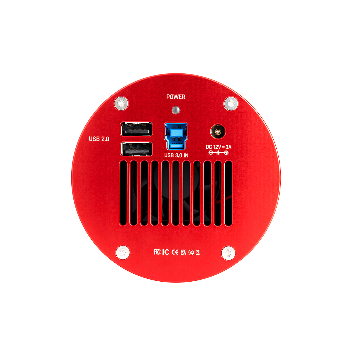

USB 3.0 & 512MB DDR3 Memory
The ASI2600MM/MC Pro incorporates a high-speed USB 3.0 interface paired with a dedicated 512MB DDR3 memory buffer. This architecture minimizes data loss and latency, delivering fast, stable, and secure transmission even during long exposures and continuous high-resolution capture.

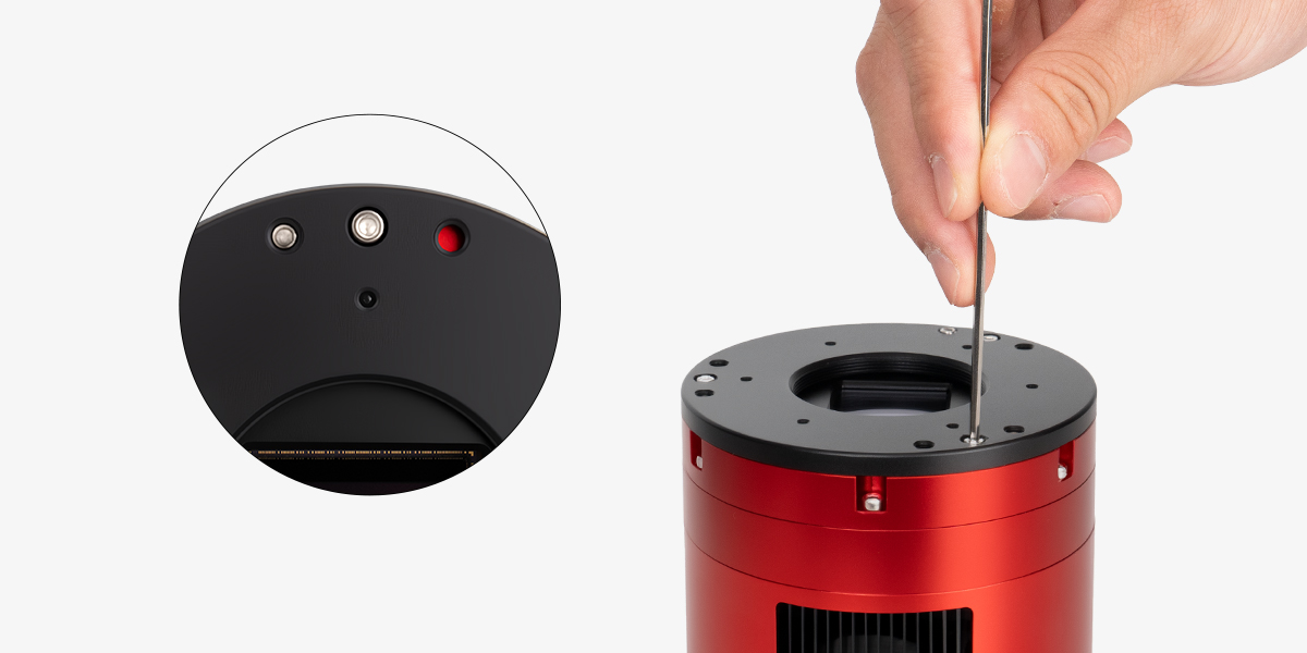

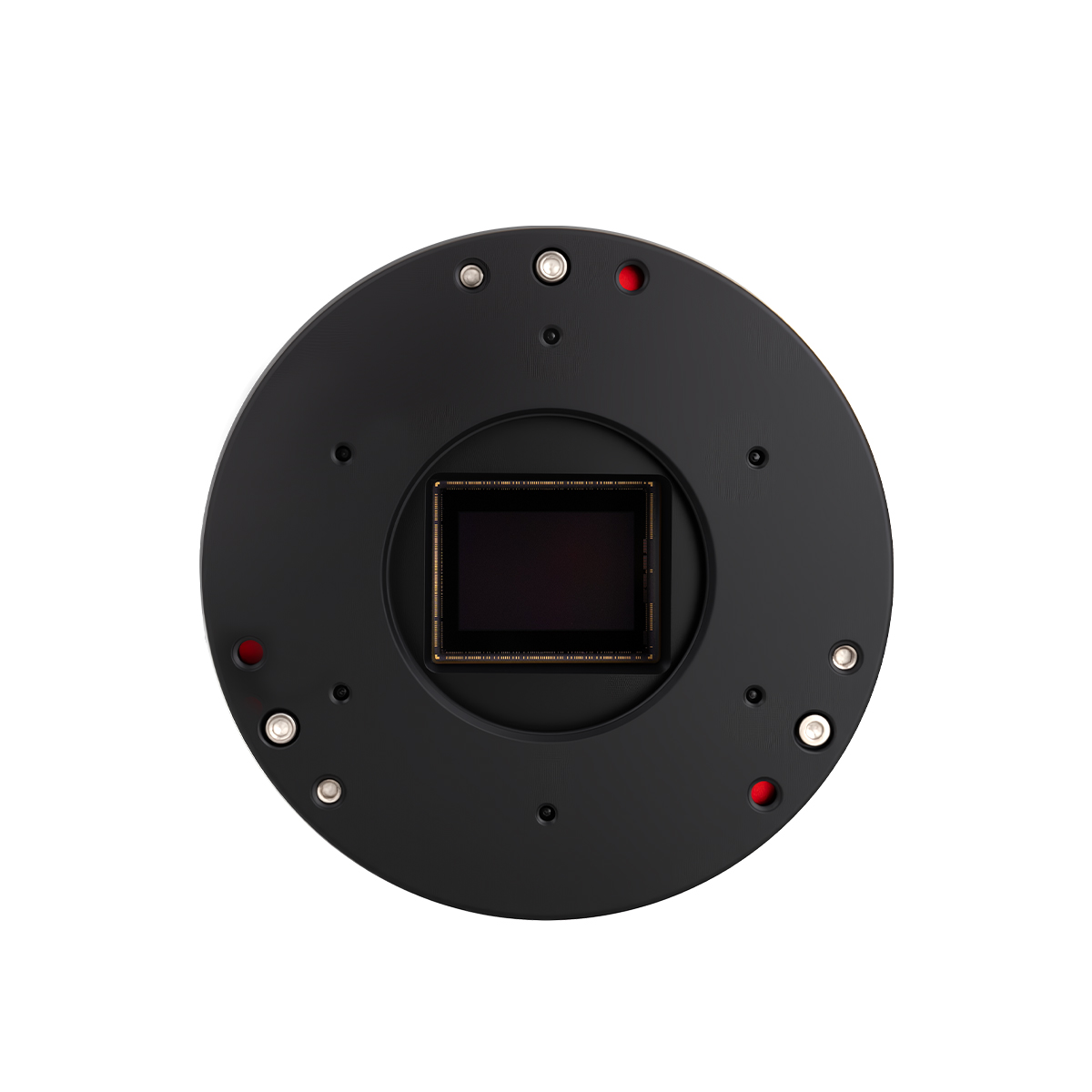

Sensor Tilt Adjustment
The camera incorporates a tilt plate with three sets of adjustment screws. In combination with the three mounting screws, they enable precise fine-tuning of the sensor plane for accurate alignment with the telescope’s optical axis, ensuring a flat imaging field and consistent star shapes across the entire frame.

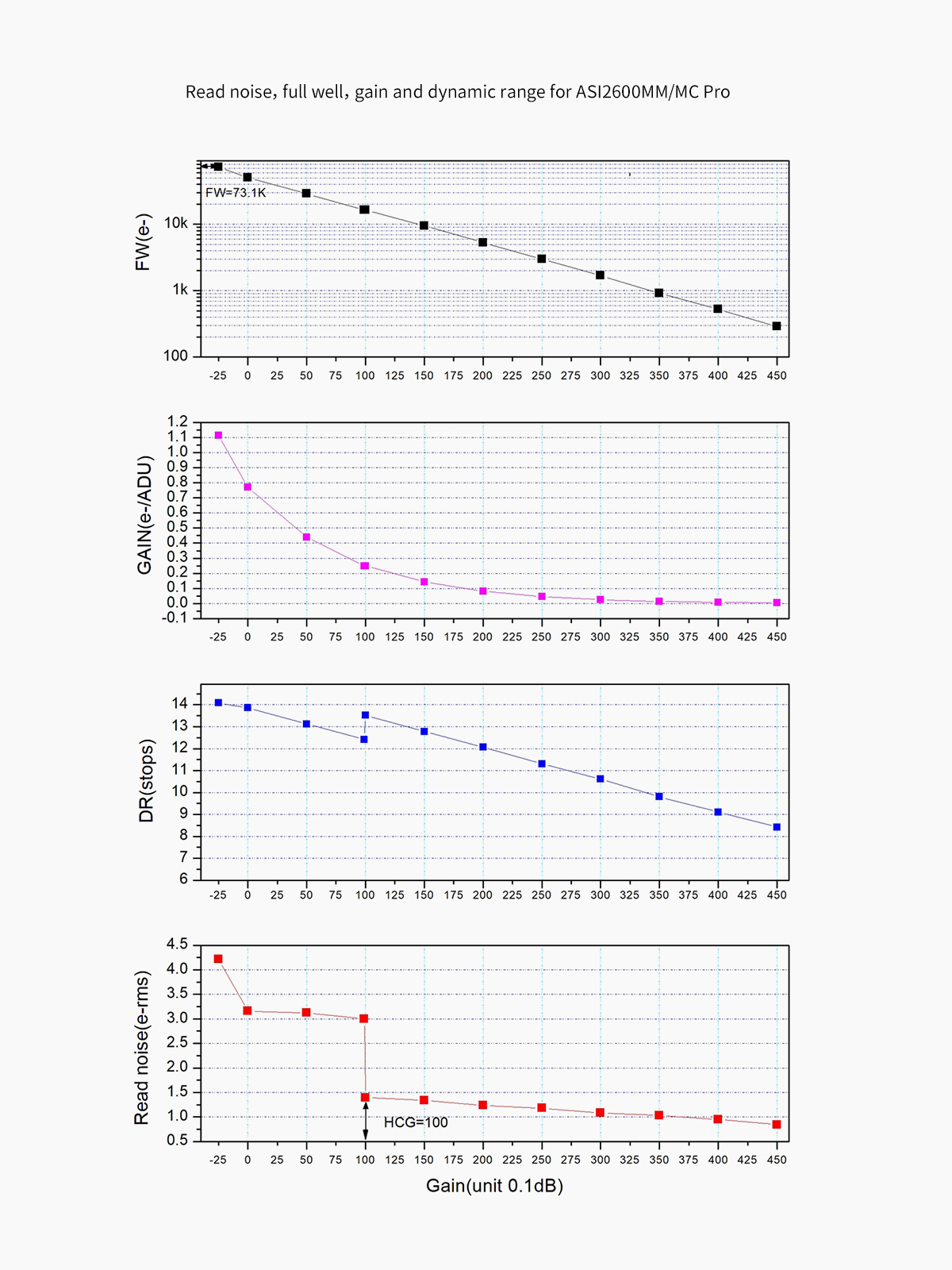

Camera Performance
The ASI2600MM/MC Pro achieves a dynamic range of up to 14 stops. When the gain setting reaches 100, the HCG (High Conversion Gain) mode is automatically enabled, which substantially reduces readout noise while preserving dynamic range. For optimal deep-sky imaging performance, a gain setting of 0 or 100 is recommended.

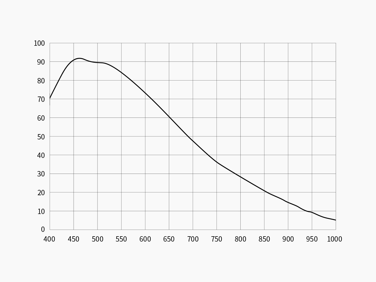

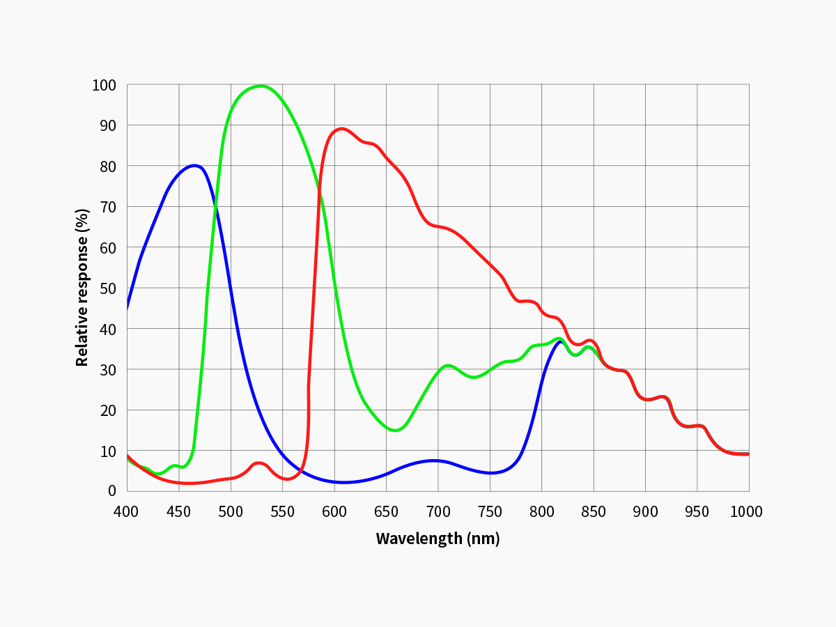

QE value
The QE peak value of the ASI2600MM Pro camera is 91%.
The QE peak value of the ASI2600MC Pro camera is 80%.

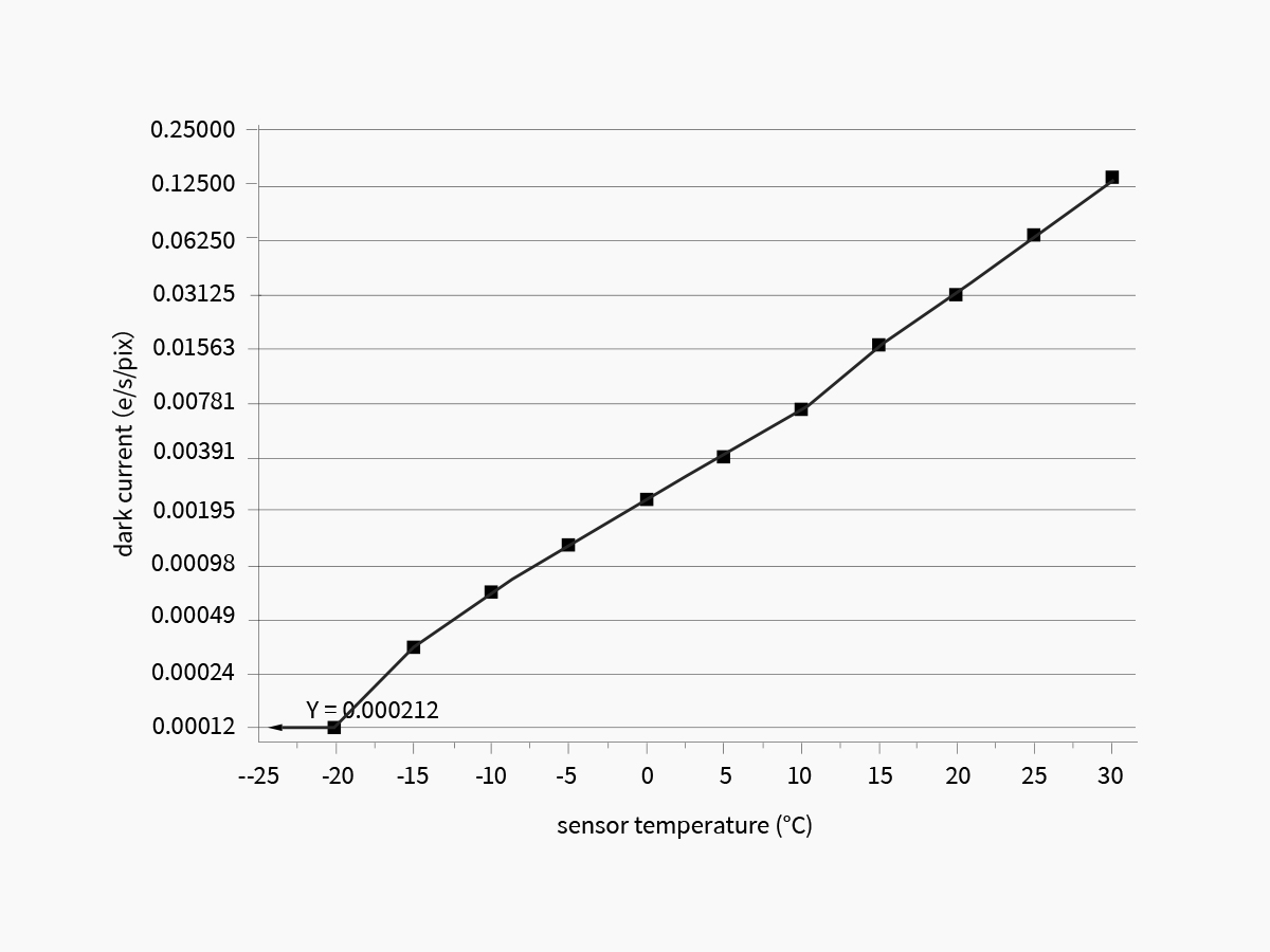

Ultra-low dark current
The ASI2600MM/MC Pro adopts advanced dark current suppression technology. At a cooling temperature of 0 °C, the dark current is only 0.0022e⁻/s/pix, which means that even with a 5-minute (300s) exposure, the total dark current noise is just 0.7e⁻—lower than the readout noise. At –20 °C, the dark current drops further to 0.00012e⁻/s/pix, making it virtually negligible.

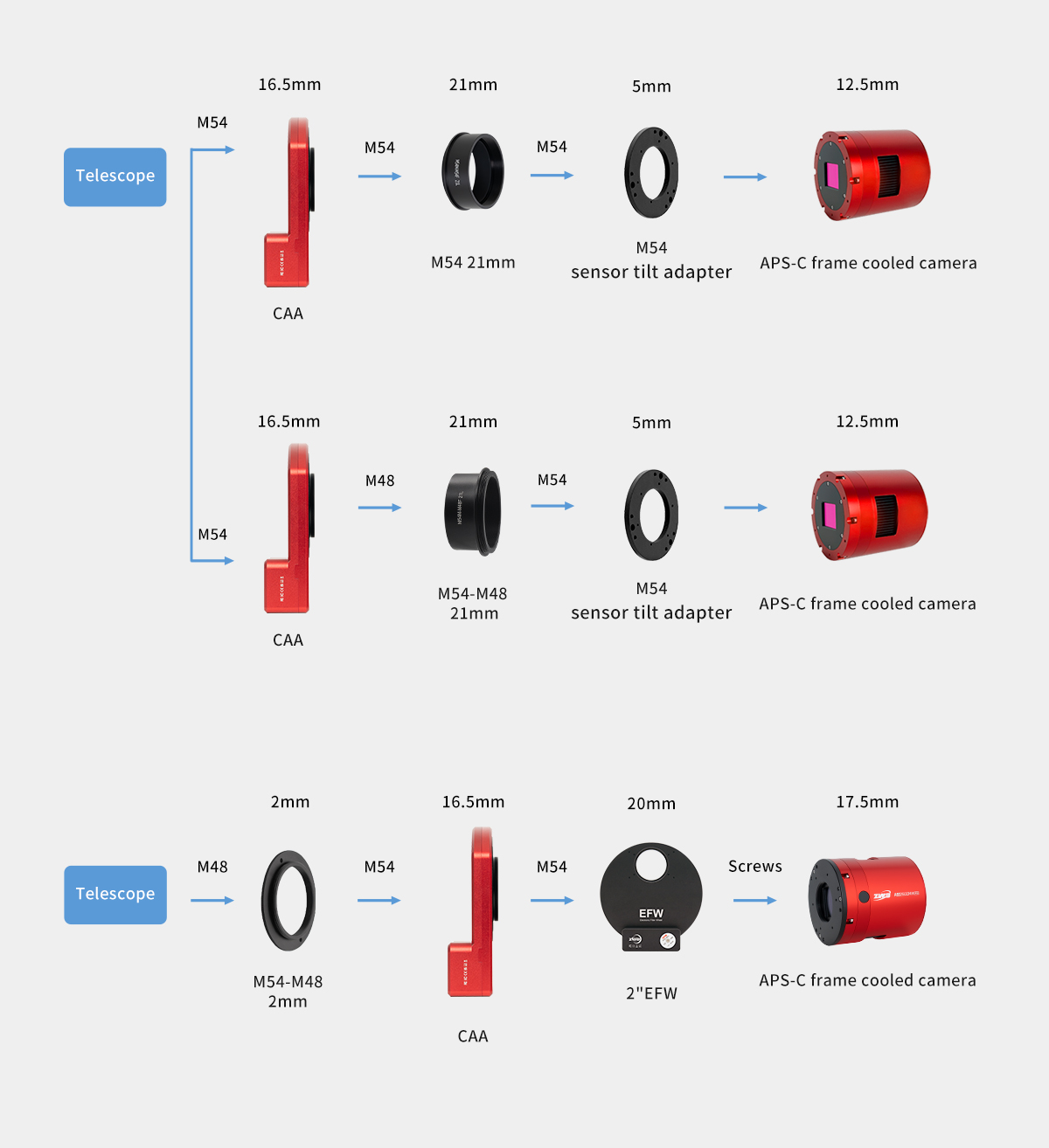

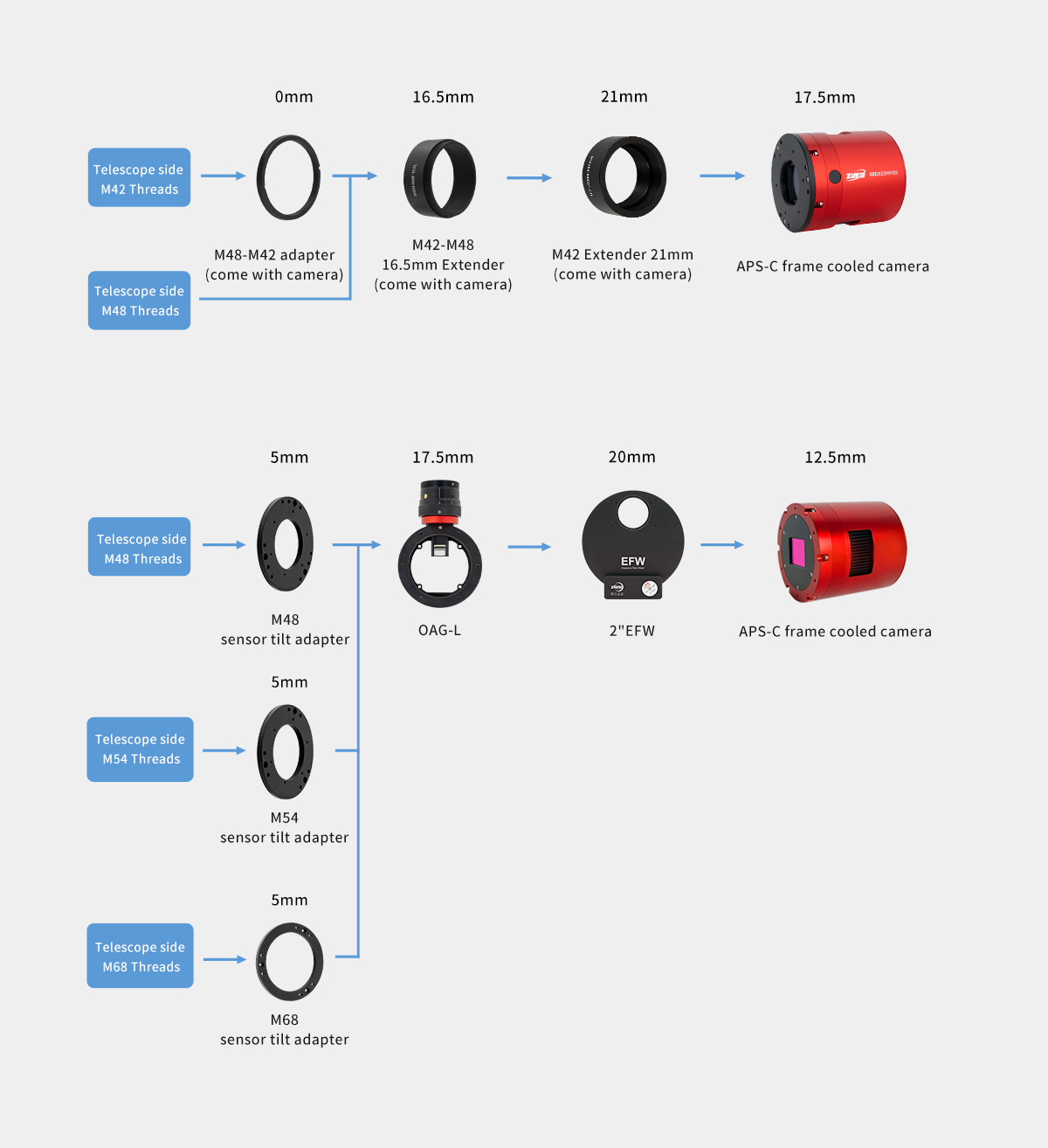

Solution of 55mm back focus distance

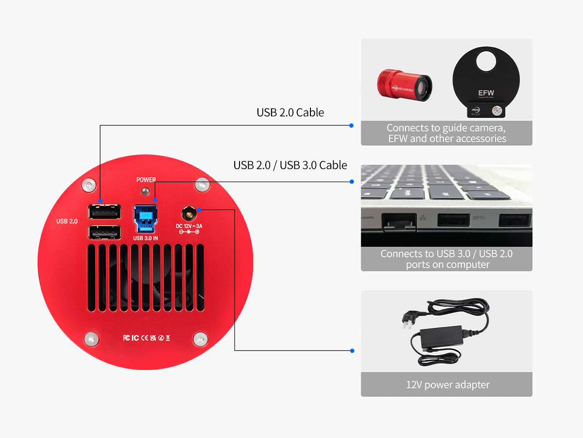

Interface for External Devices

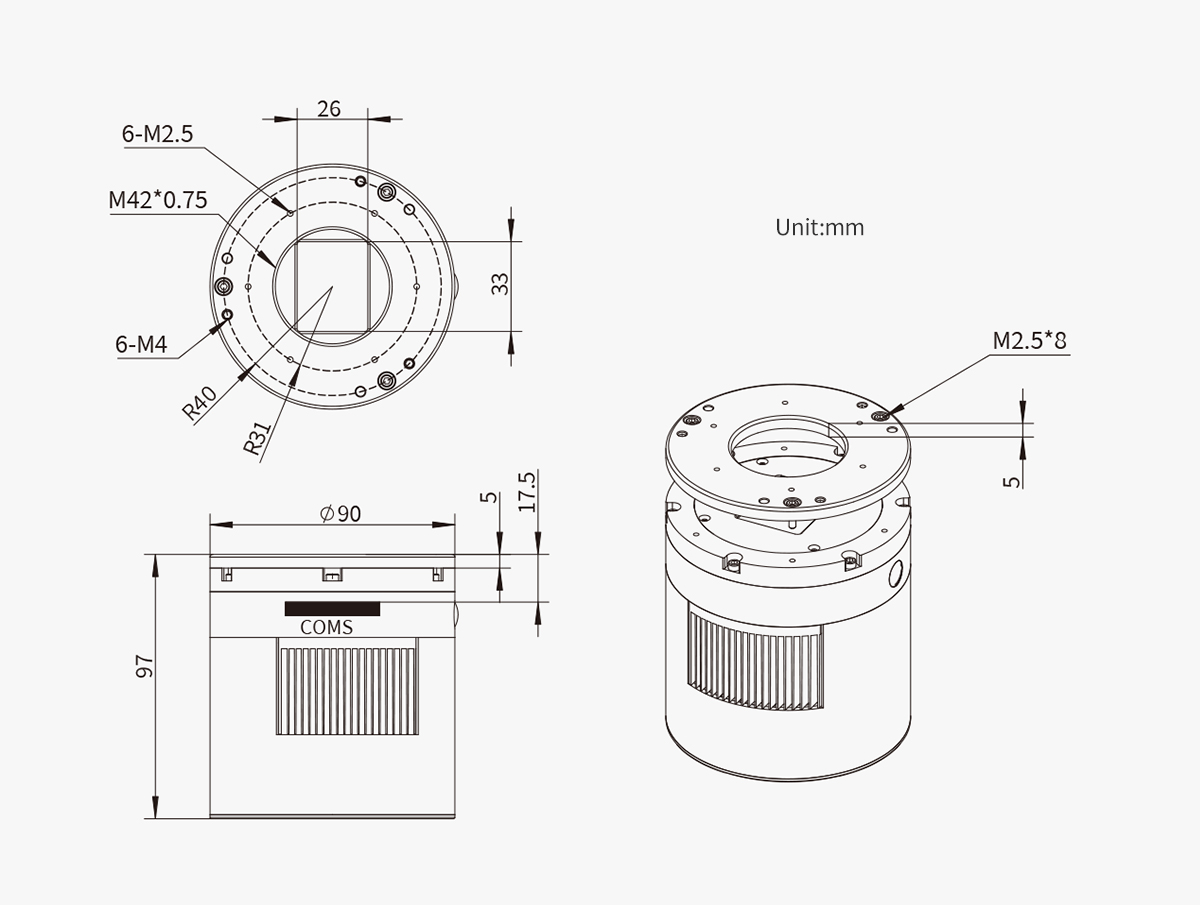

Mechanical Diagram
