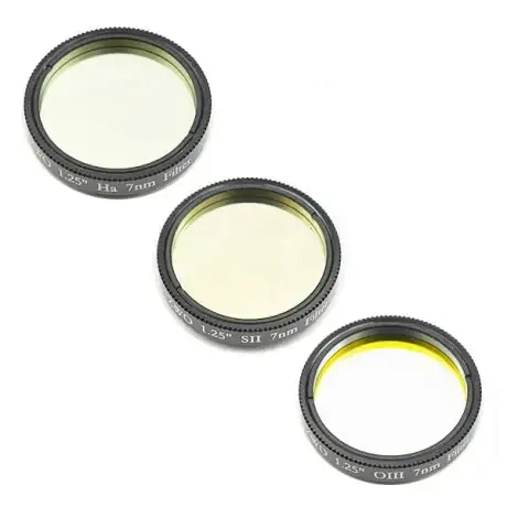

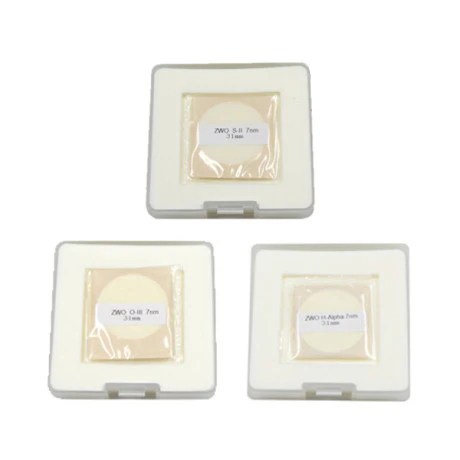

  • FWHM:7±0.5nm
  • Glass Thickness 2.0+/-0.03 mm  (1.25”/31mm/36mm)
  • Fine-optically polished to ensure accurate 1/4 wavefront  over the both surfaces
  • About 90% transmission at H-alpha line 656nm (H-Alpha filter )
  • About 90% transmission at SII line 672nm (SII filter )
  • About 90% transmission at major OIII line 500nm (OIII filter )
  • Infrared wavelength 700-1100nm cut-off
  • <0.1% transmission of off-band, OD3(Optical Density)
