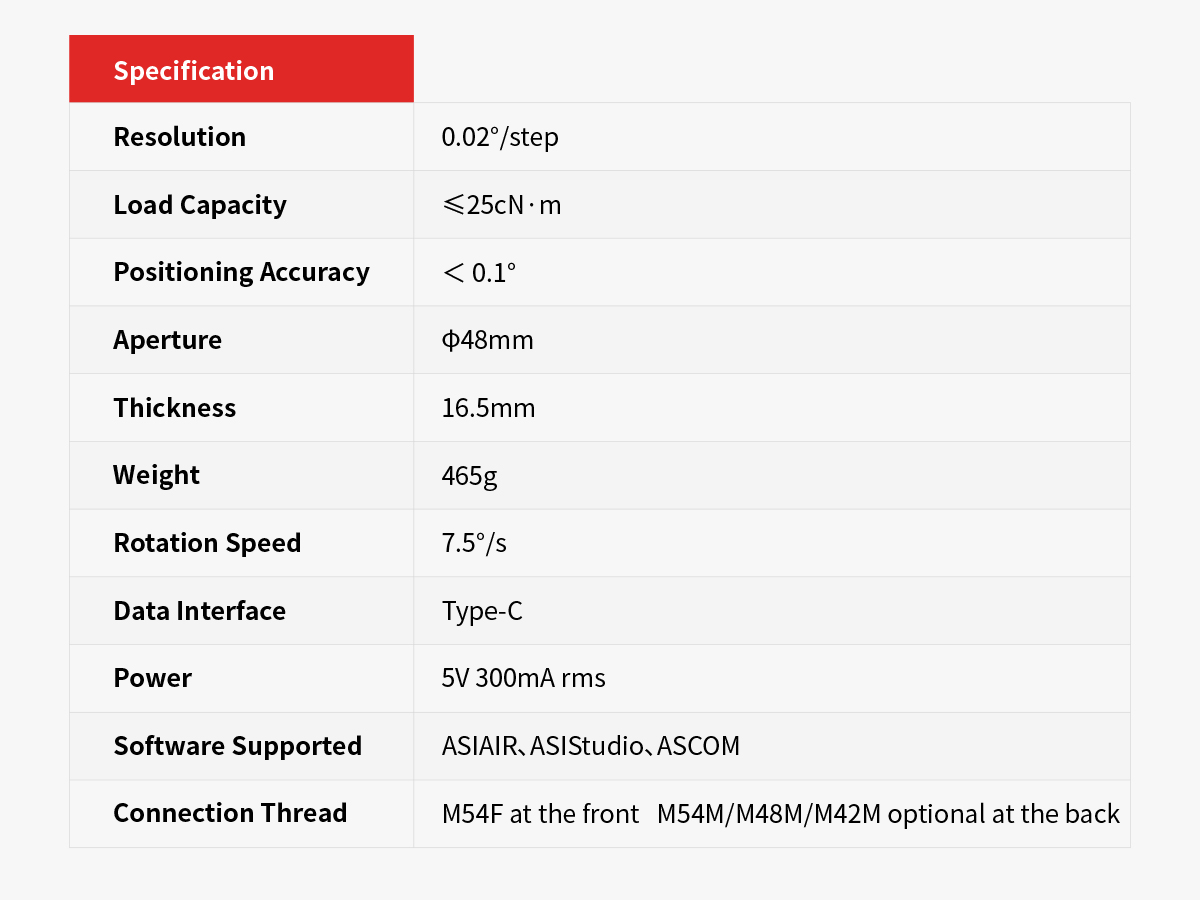

3.  High Positioning Accuracy: 0.02°/step
ZWO CAA adjusts the camera angle with an accuracy of 0.02° for each step. The positioning accuracy of the ZWO CAA is better than 0.1 degrees, and the adjusted angular error will not exceed 0.1°.
4.  High Rigidity and High Load Capacity: >15cNm*
The ZWO CAA is highly rigid and able to withstand torques greater than 15cNm (centiNm), maintaining operational accuracy and structural stability even under high load conditions.
*Tested by ZWO laboratory, the device can operate stably with ASI461+7x50EFW+1kg additional load (overall ≥4kg).
5.  High Speed: 7.5°/s
The ZWO CAA rotates at a speed of up to 7.5° per second, reducing waiting times.

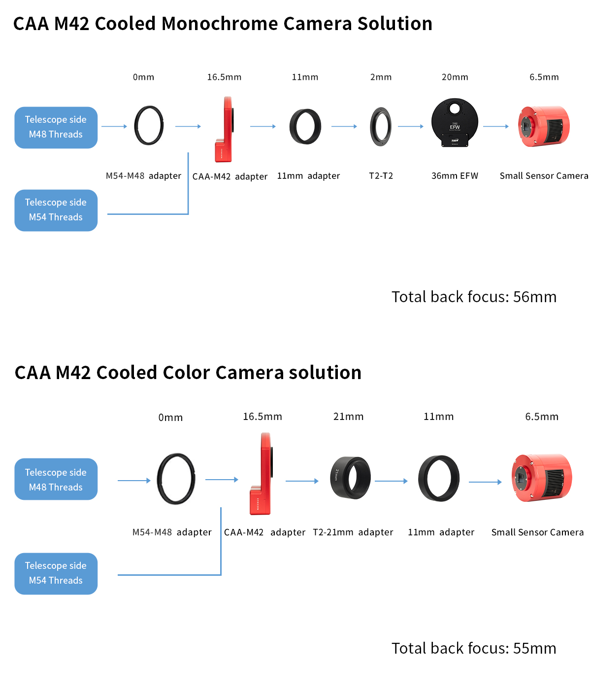

    Connection
    1. With the ZWO FF series refractors, with or without the reducer, you can use the standard adapters (M48) supplied with the telescope and your ZWO camera replacing the 16.5mm adapter with the CAA. if you have a Duo or 2600AIR camera and wish to use M54 then an optional adapter is available as an accessory.
    2. 55mm back focus distance:
Installation Steps
Step 1. Install the CAA on the threaded drawer tube adapters.
Step 2. Install the optional M54 (21mm) adapter to maintain the focusing distance.
Step 3. Install your camera. If you are using a camera with an M48 interface you can change. the ZWO CAA camera threads from M54 to M48 using the supplied accessory plate.

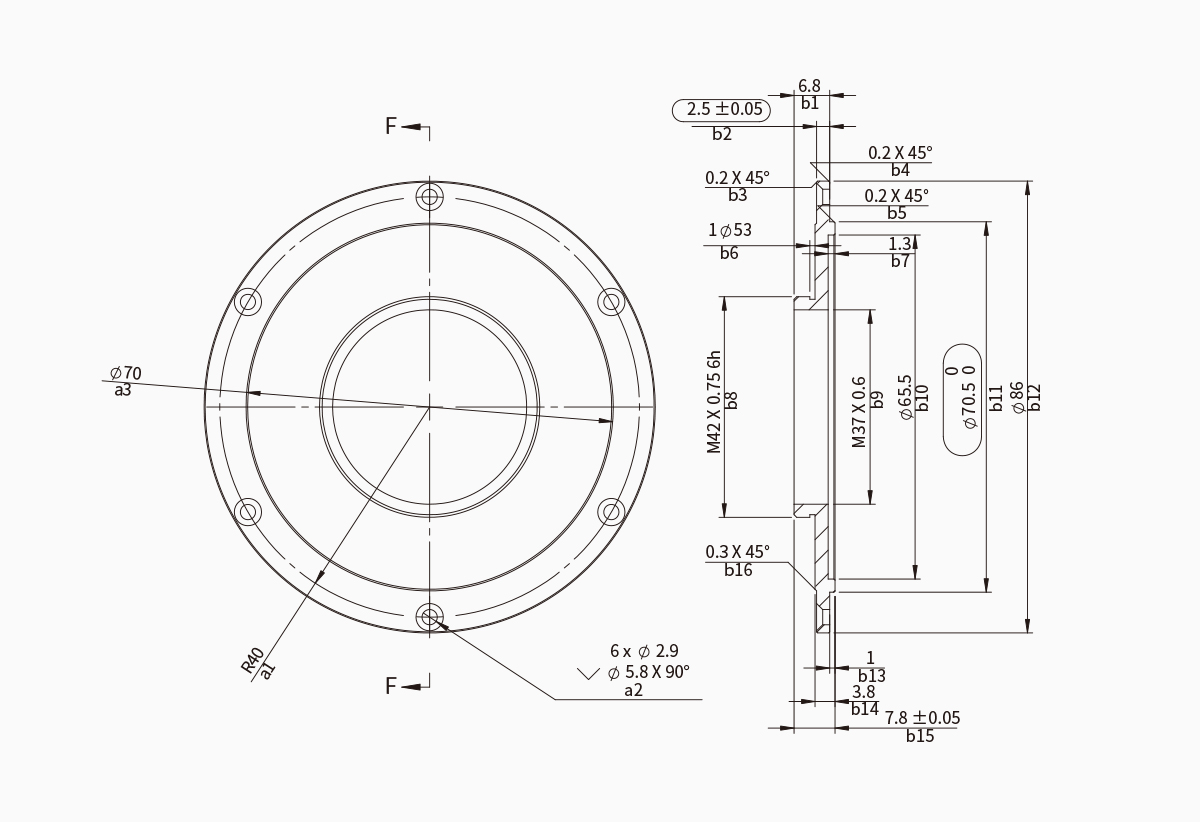

CAA-M42 Adapter structural dimension diagram
