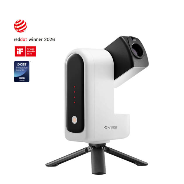

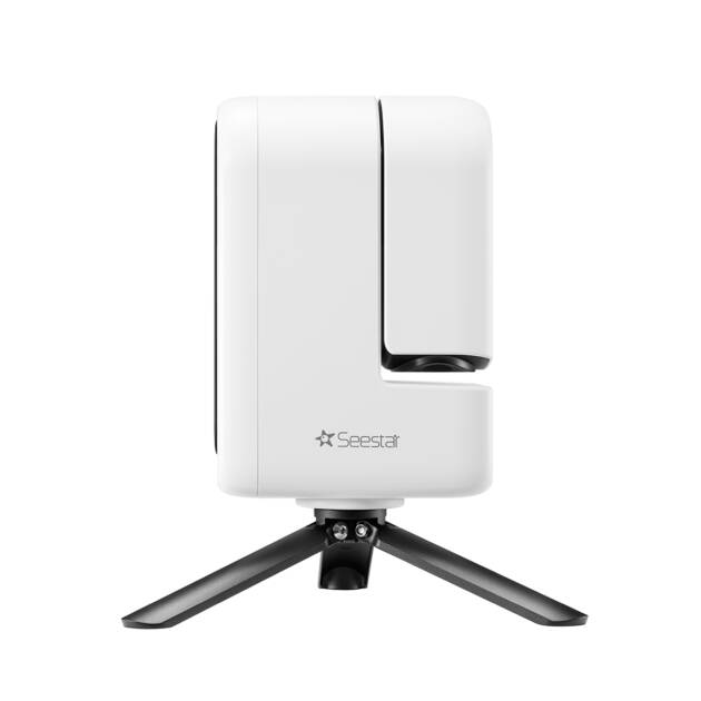

What You Need to Know
Exploring the Seestar S50 Feature
Seestar is a compact body that integrates a telescope, electrical focuser, astronomical camera, ASIAIR, altazimuth mount, dew heater, and filter wheel, all weighing only 2.5kg.
Icon
Lightweight Design
Highly integrated all-in-one smart telescope
Icon
Clean and Low Noise Images
Triplet apochromatic optics
Icon
Built-in Bluetooth/Wi-Fi
Dual-mode reliable connection
